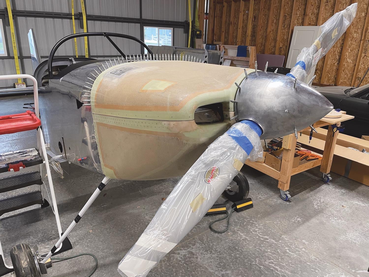

prop spinner alignment 01The spinner on the front of your airplane is there to do more than just look pointy—it’s also important for drag reduction and cooling airflow. A spinner is also typically made of fairly lightweight material, so it has to be mounted carefully to avoid crack-inducing stress and vibration. Therefore, it’s important to mount the spinner to the propeller as accurately as possible.
Ideally the spinner should run perfectly true with absolutely no wobble, or as machinists say, “zero runout.” In practice, you just want to minimize the amount of runout by being as careful as possible when you are measuring and drilling. For the spinner on my RV project, I decided to shoot for ±0.030 inch or better, which is an ambitious goal.
My RV, like many airplanes, has an aluminum spinner backplate installed behind the propeller, plus an additional aluminum bulkhead in front of the prop hub. The spinner itself is then attached to the backplate and front bulkhead with screws and nut plates. Getting the spinner aligned accurately and locating the holes precisely presents a problem to be solved. To accomplish this, I devised my own approach to fitting a spinner. My application is for a Hartzell constant-speed prop mounted on a Lycoming engine, but the technique should work for any airplane project.

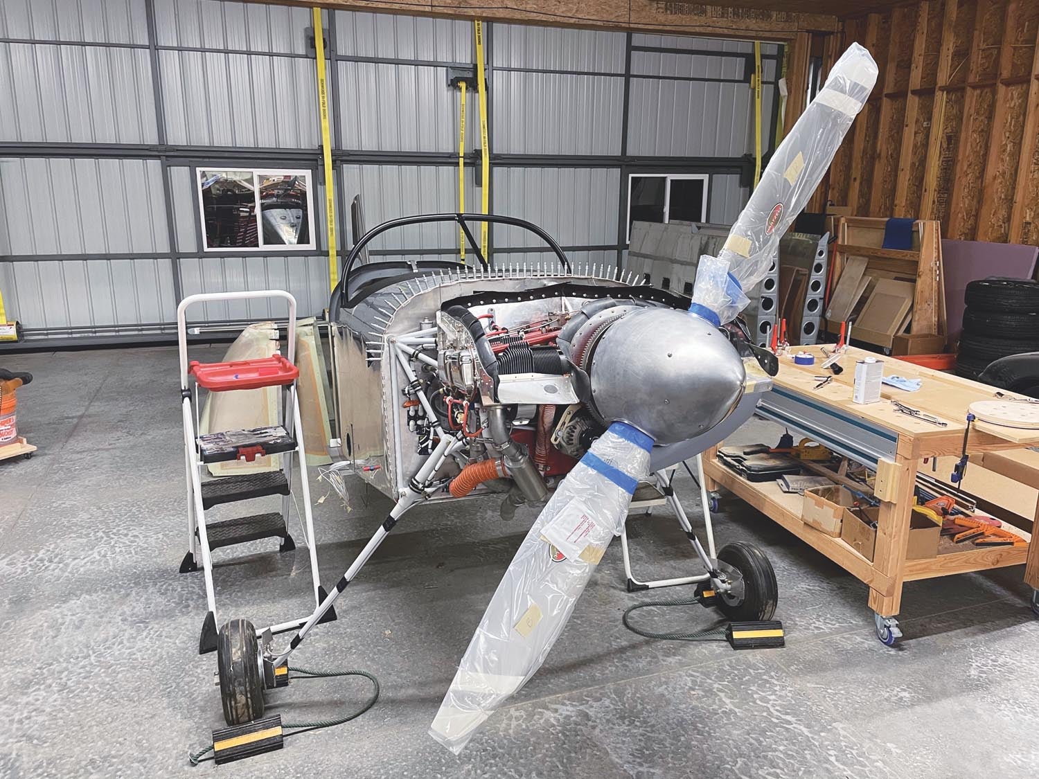

Mounting the prop on the engine using the hoist for its intended purpose (left). With the prop on the plane and the spark plugs removed, the dial indicator measurement is less accurate but still good enough to get the job done (right).
The Final Fitting
The next step was to mount the prop on the engine for final fitting. I unbolted the prop from the jig, hoisted it up to the crankshaft and threaded in the six bolts. A prop sling is helpful if you’re working by yourself—a propeller is heavy!
With the prop bolted to the engine and the spark plugs removed, I turned it through a few revolutions and used the dial indicator to verify that the prop dome runs as straight when mounted on the engine as it did when it was mounted in the jig. The measurements become more sloppy at this point—it’s hard to spin the prop without inducing error when the airplane is sitting on rubber tires and the engine is on rubber mounts—but I did satisfy myself that the jig had been an excellent substitute for having the prop mounted on the actual engine. I Clecoed the spinner in place and checked the runout again, with good results. Everything was just as I had measured it in the jig, just with noisier measurements due to the more flexible setup.
prop spinner alignment 12
Verifying the spinner still runs true with the prop mounted to the engine (left). With the final screws and nut plates installed, the spinner runout is almost less than can be reliably measured with this crude setup (right).
From there, the process of enlarging the holes to final size and installing nut plates follows the usual pattern. Finally, with the spinner completely fitted and affixed with the proper screws, I made one more measurement of the final runout figure. I ended up with a runout of approximately ±0.015 inch, which is just about at the limit of my ability to measure anything at all. So given the inherent inaccuracy involved in this measurement, I’m going to call that basically dead nuts on. Hopefully this will result in a long-lived spinner with no cracks.prop spinner alignment 02
