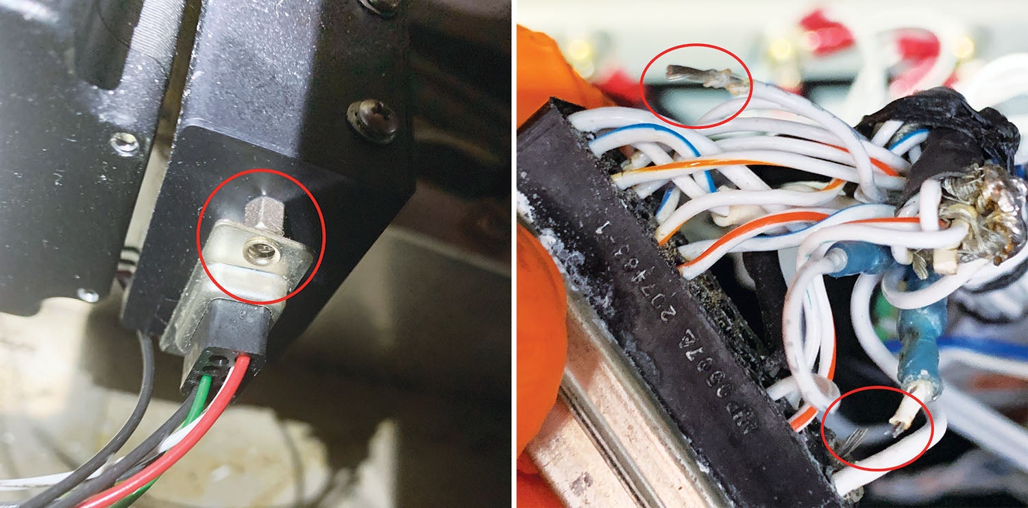

No Backshell and No Screw
Unairworthy
no backshell no screwI hate seeing D-sub connectors not supported or fastened correctly, as the wires will eventually break. In this case, two broken wires on the unsupported 25-pin connector caused Com 2 to be inoperative.
