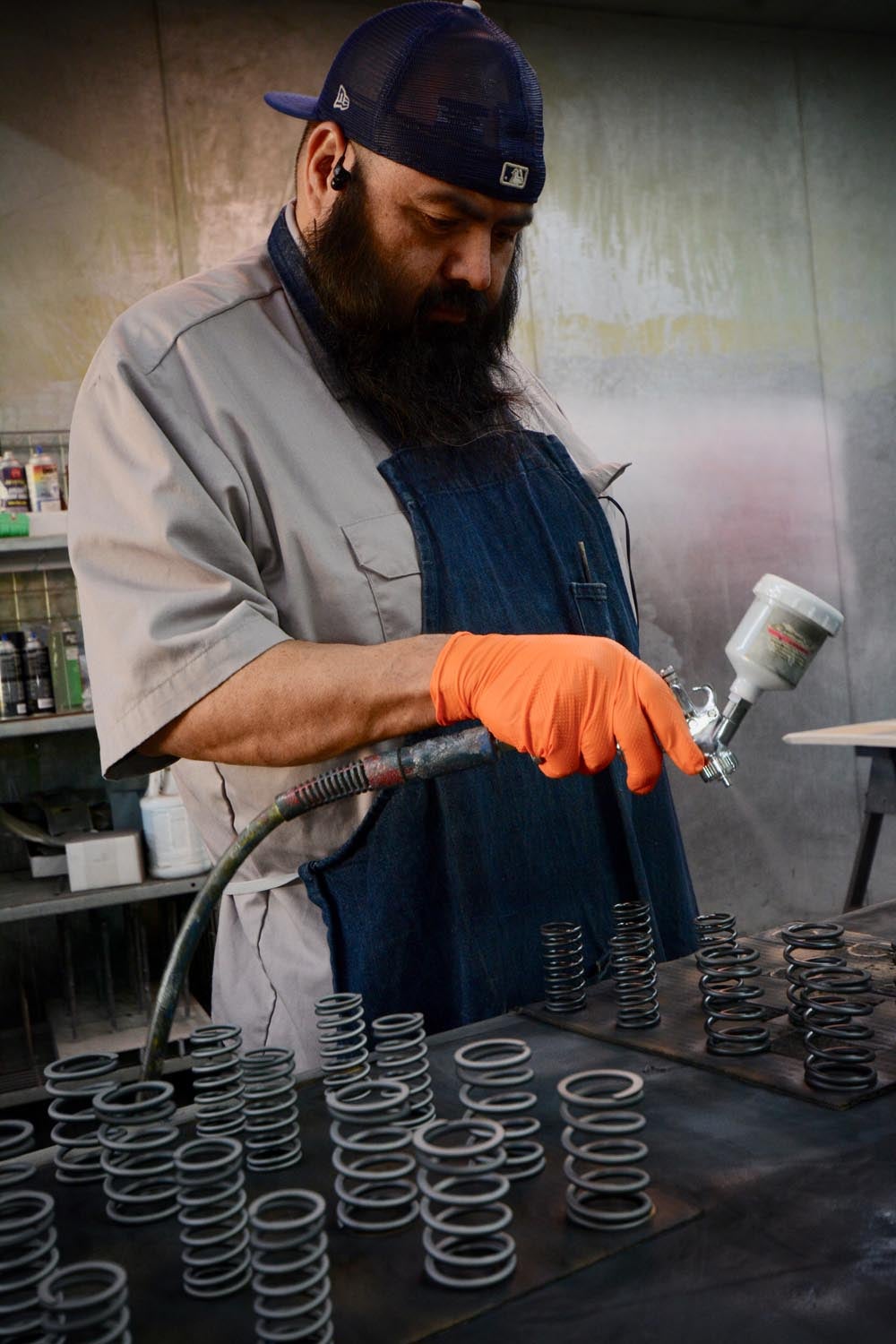

Painting and coating now has its own three-sided booth at Ly-Con. Heat barrier and low friction coatings are common.
