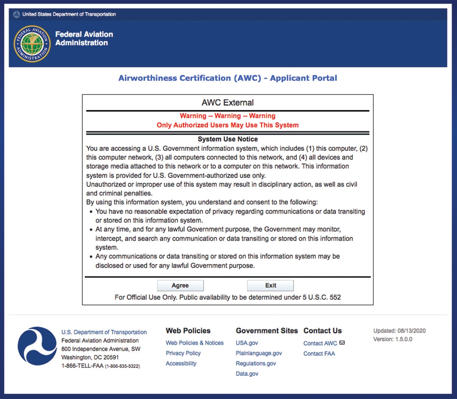

First log in to the FAA AWC Applicant Portal. Or go to the FAA Airworthiness Certification Process page. About mid-page it will offer you a hypertext link to the AWC tool, an overview of the AWC process, which is not particularly helpful, and a link to a paper application Form 8130-6. Click on the link to the AWC tool. Once you have clicked on the box that says you agree to the terms of use, you can go to the actual beginning of the process.
applicant portal e1610926612580
Airworthiness Certification (AWC)—Applicant Portal: After accepting the terms of use on the AWC site, you will either log in if you are a returning user or create a new account by clicking on the link “New User Sign-Up.”
The first thing to do is click on the box on the right that says “New User Sign-Up.” This will direct you to create your own login, which you will use to access AWC after the first time.
