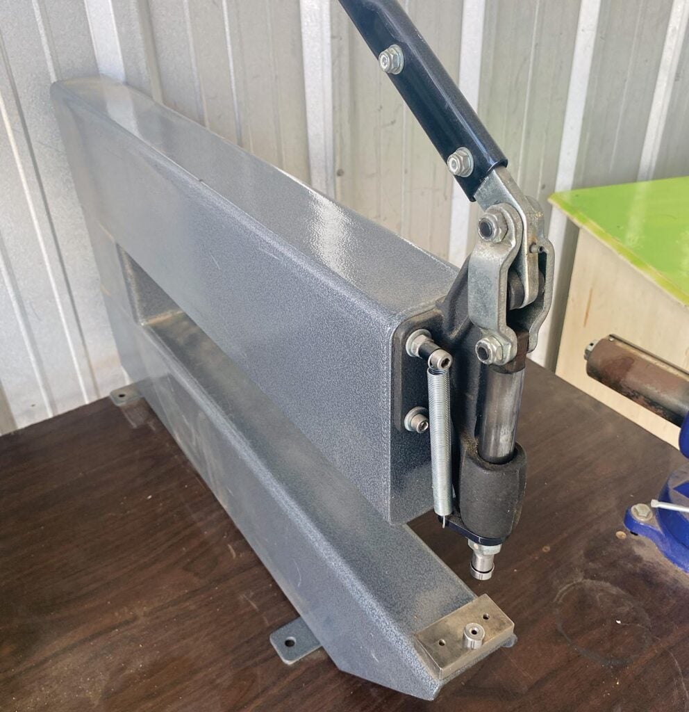

Ootbtools squeezer
A quality pneumatic hand squeezer and proper set of dies will make any metal build easier and of higher and more consistent quality.
1. Pneumatic C Squeezer Kit
Available from Spruce, p/n 12-03504 ($700–$800 including required yokes and dies). There are a few versions and brands of these tools, but overall, owning one is a joy for builders of conventional riveted-metal projects. There is a learning curve to setting it up and using it properly, but builders have thousands of opportunities to get proficient with it. Can also be used as a convenient dimpler in certain situations. Often included or optional in specialized tool packages. Not cheap, nor required, but will be highly cherished by builders who value efficient, uniform and essentially error-free production.

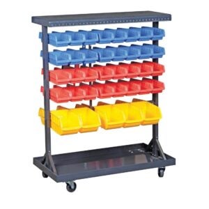

3. Mobile 74-Bin Double-Sided Floor Rack
Outbtools rack
A good small parts and hardware rack is invaluable to an organized shop and build project.
Available from Harbor Freight ($169.99). Some might say that parts organizers aren’t tools, but I disagree. To me, a tool is any shop accoutrement that contributes to the success of a project and this getup is a huge favorite. The easily removable smaller bins are perfect for sorting all the high-volume rivets and other hardware that come in various sizes and need to be kept separated. The bins are easy to label by part number and carry to the rivet table when it’s time to bang. Other bins are the perfect size for the famous Van’s brown paper bags stored in numerical order for easy retrieval. Still larger bins store myriad boutique parts and specialty tools, sealants and so on. A wonderful addition to any workshop that is near perfect for kit building.

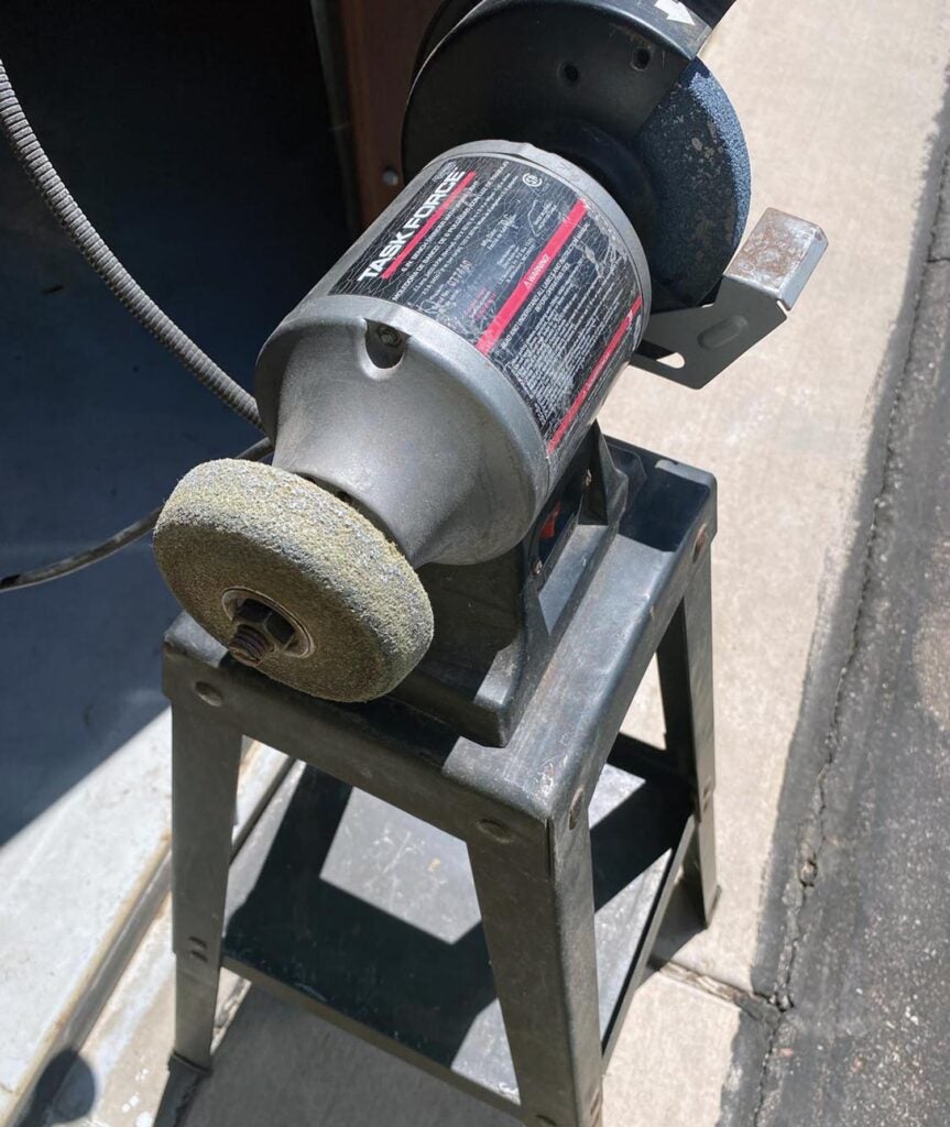

4. 3M Scotch-Brite Deburring Wheel Apparatus
Ootbtools SBwheel
The Scotch-Brite wheel assembly is often cobbled together from various parts all built around the (pricey) but extremely handy wheel itself. Easily the tool with the most work hours logged on the project.
Available from Spruce, p/n 09-05641 ($61.75) plus a half-inch flange adapter kit, p/n 12-01585 ($7.50). Next stop we go to the aviation aisle at Harbor Freight Tools. We need a basic no-frills 6-inch bench grinder ($50 or so) plus the universal bench grinder stand ($35). The combined assembly forms what will be one of the most heavily used components in any builder’s shop. Every single structural part of a metal kit gets cleaned up on the wheel, which in itself just gets better with use as the outer edge erodes to a more versatile angle for larger pieces. Worth every penny and knuckle burn.

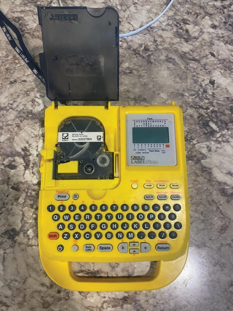

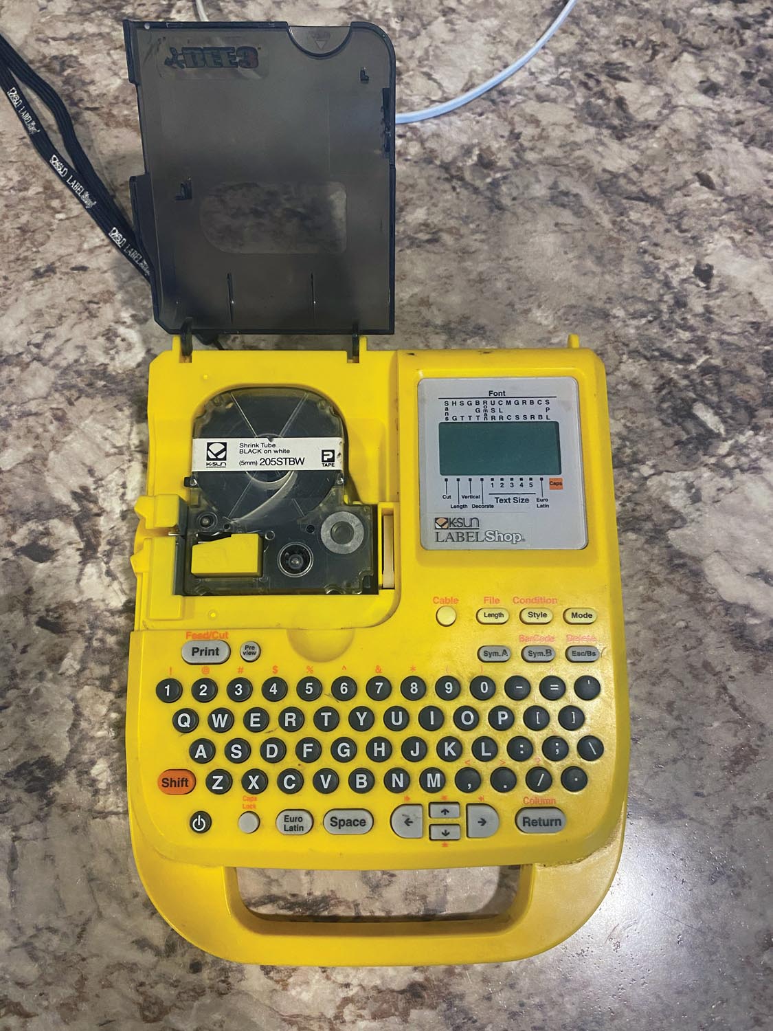

5. Labelworks LW-PX350 Label Printer
Ootbtools printer
The Labelworks label and shrink tube printer makes conventional flat labels as well as “shrink tube” labels. Wiring projects will become a favorite addition to any shop.
Available from Spruce, p/n 11-15517 ($129). Previously sold as a Bee3 by KSun. The beauty of this gadget is that in addition to normal flat labels, this unit also imprints on what the vendors call “shrink tube.” The labels and tubes come in cartridges of various sizes and, while a bit pricey at about $30 each, are very handy. The printer is easy to learn to use and immensely useful for wiring. The first time someone has to do some electrical troubleshooting, the value of diligent labeling becomes readily apparent. The biggest downside to owning one of these is that word gets out that you have it, and a steady stream of friends new and old come out of the tarmac wanting to borrow it. After the airplane build, I have used this device for many other household and vehicular projects.

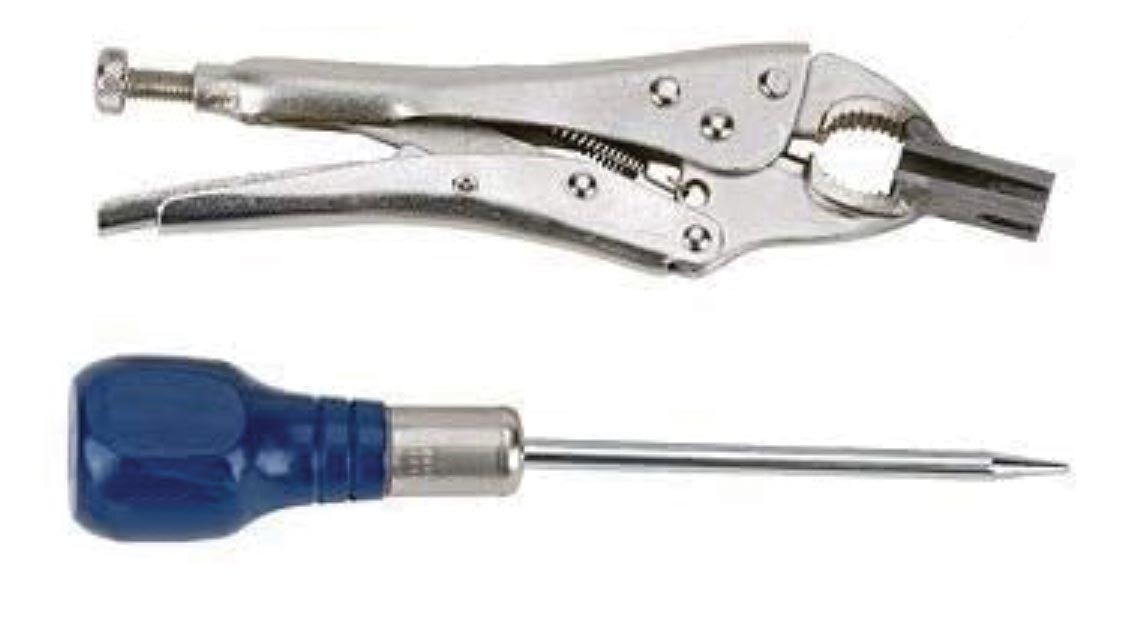

7. Adel Clamp Pliers and Awl
Available from Spruce, Amazon or Wicks ($37.50). Adel clamps are those circular padded clamps used extensively, especially firewall forward. They are a necessity for what they do, but they can be challenging to install. We’ve all fought getting the wire bundle positioned and the retaining bolt installed properly, especially when combining two clamps as part of an assembly.
Ootbtools adelpliers
Ratcheting terminal crimper (left). Electrical wiring projects are one discipline where cheap tools are worthless. A high-quality ratcheting crimper with multiple die sets is essential. Adel clamp pliers and an awl (above) solve a difficult assembly problem in an elegant way. It won’t be the most used tool in the shop, but will likely become a favorite.
This tool package consists of a modified pair of Vise-Grip pliers to clamp the assembly together and hold it so that the awl can then align it all up with the bolt until the builder can get the nut installed to hold it all together. (Sometimes it’s easier to do it in reverse: String the clamps together on the awl and then tighten with the Vise-Grips pliers.)
To fully appreciate the tool, just try to get one of the Adel clamps installed without it. It won’t be the most heavily used tool in your shop, but it’s well worth the money if only to keep those dollar bills out of the swear jar. (Yes I am aware of the safety wire trick, and have tried it, but for the small investment, I really appreciated this handy tool combo.)

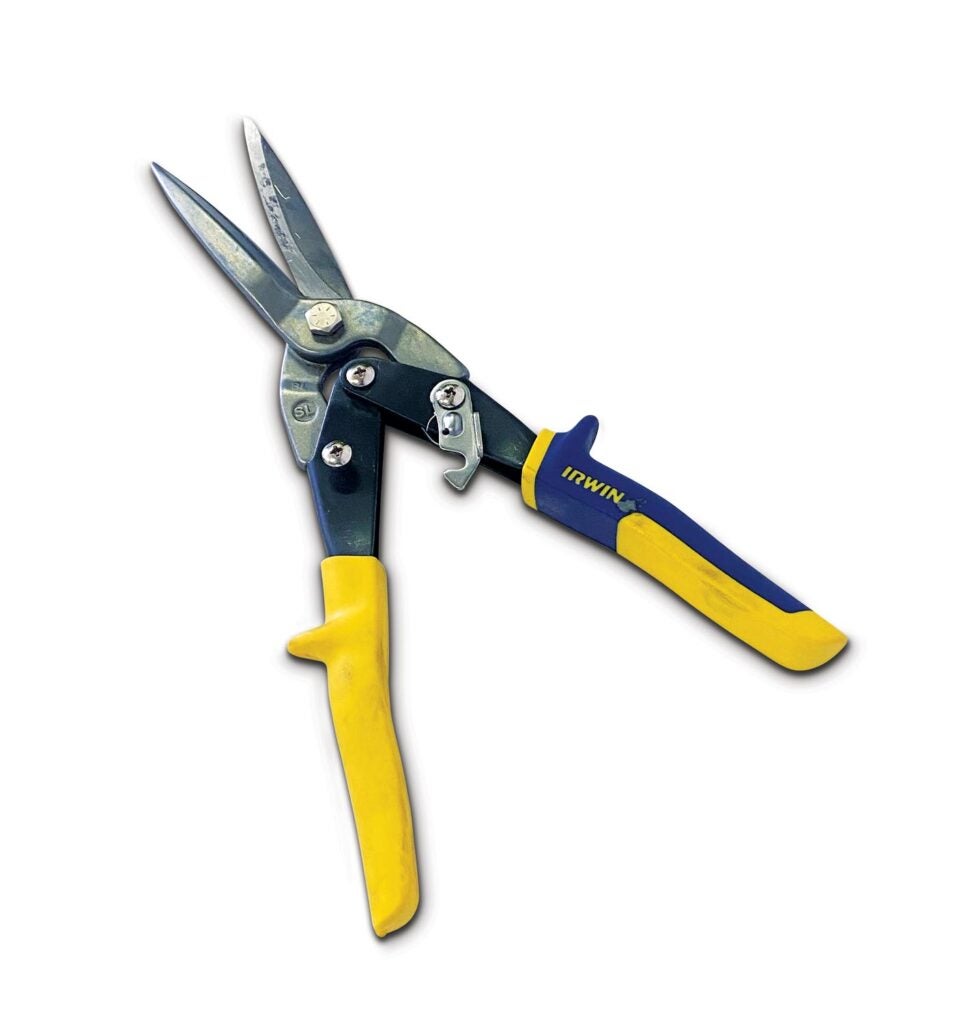

8. Long Nose Aviation Snips
Ootbtools longnosesnips
Long nose aviation snips. Very handy for myriad uses. Of all my tools, this one gets borrowed by my wife most often. I own multiple pairs.
Widely available (around $17). I like Irwin’s 21304ZR. My first pair of these snips came with a starter tool kit along with a traditional trio of short-nosed aviation snips, but I found that I used the long-nose shears more than all the others combined. I like them so much I now own four pairs to keep one in each toolbox plus my road kit.

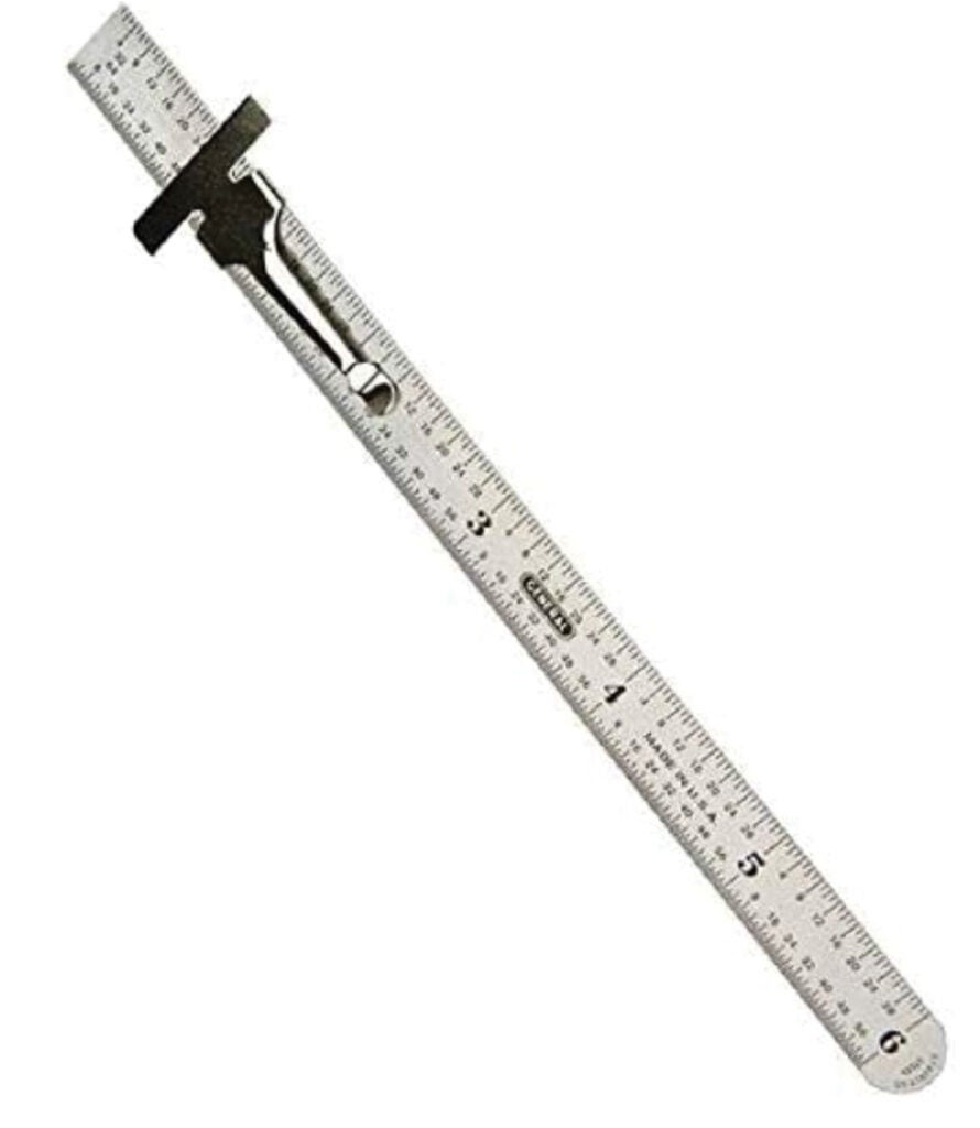

9. Stainless Steel 6-inch Pocket Ruler
Available from Amazon and other sources ($2.99). These get used a bunch and tend to wander off, so consider a four-pack. A pocket clip also serves as a height/depth gauge, which is handy for laying out rivet lines.
Ootbtools pocketruler
Stainless steel pocket ruler. Extremely
handy and extensively used in kit building. High quality is a must and can be had for little money. Frustrating when needed and can’t be found so buy several.
These are available in standard, metric and combo. Just make sure you know what you have when using it. Absolutely indispensable to kit building.
