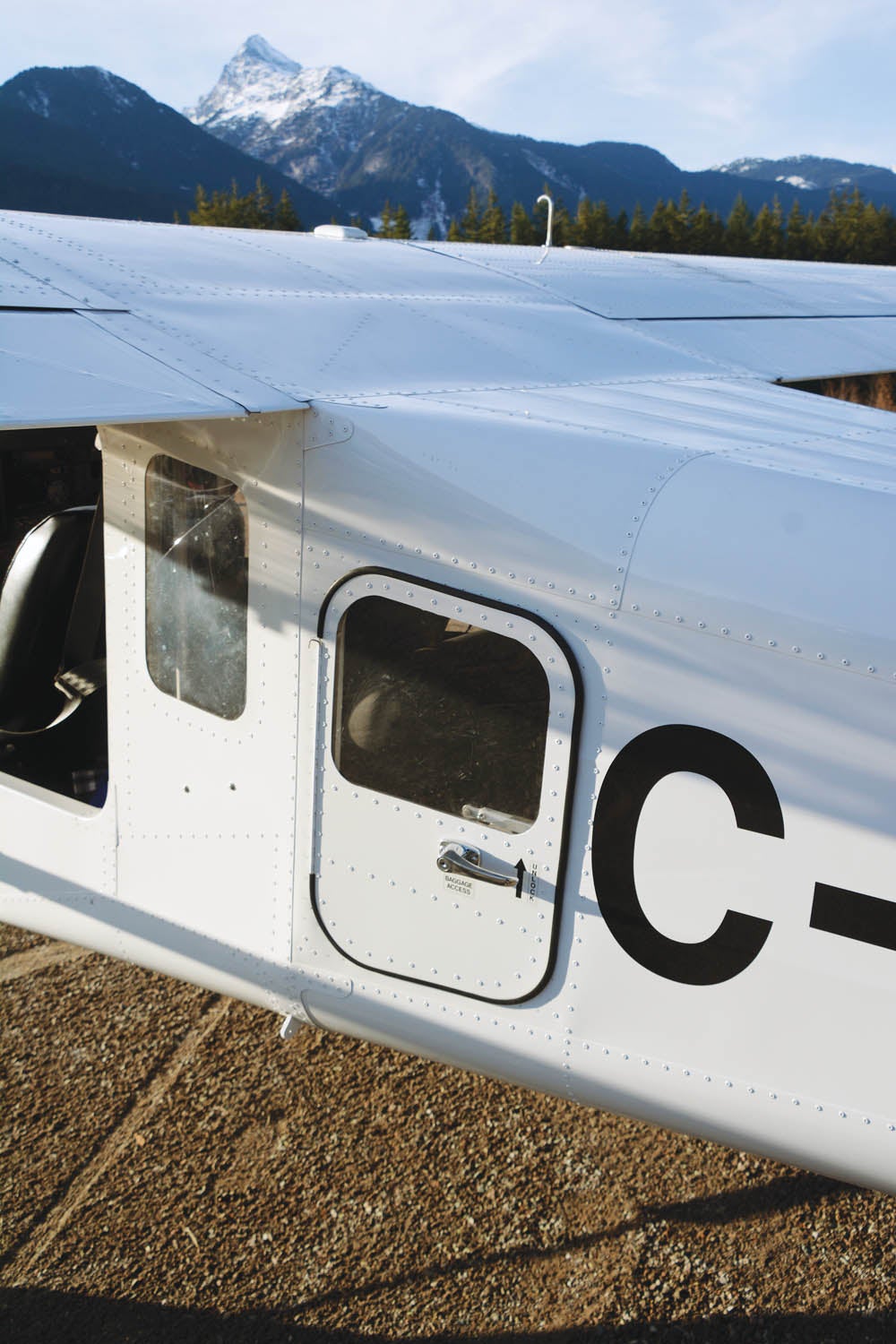

All metal, except for the nylon slider, the spring-loaded door latches are simple, effective and usable when wearing gloves—and indicative of the practical, durable nature of Murphy Aircraft.

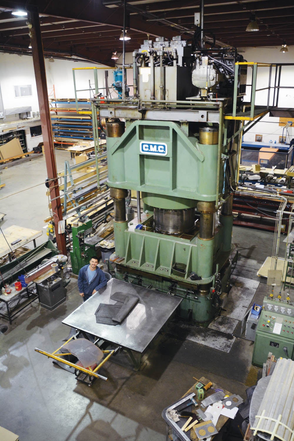

As for the kit hardware, the initiative is for Murphy to complete more steps for the builder. Until now, Murphy kits were marked by formed aluminum channels, stampings and flat sheets of aluminum, some of it predrilled in spots—but much of it not. Compared to the match-drilled excellence from other aluminum airframers, the Murphy kits were perhaps at times closer to scratch building than riveting together a modern quickbuild kit. A quality build was possible, but it asked for a big chunk of the builder’s time and the opportunities to make—and correct—little mistakes were too frequent.

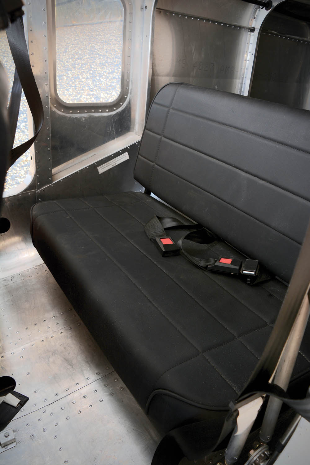

While seating isn’t a hot topic in the typical kit build, Murphy has been positioning the Radical as a 2+2, meaning it’s designed to seat two adults comfortably in front and accommodate children or crowd short-term adults in the rear bench. Think of it as a plus-size two- seater. The kit’s front seats are simple one-piece fiberglass buckets as sold to the off-road truck market, mounted on sliding adjusters to aid ingress/egress, along with access to the rear seat or cargo area. Turns out the compact back seat of a Jeep Wrangler works fine for the Radical’s second row, so Murphy was mulling the possibilities of supplying that assembly or something similar.

Children or small adults needing a quick lift are the intended users of the Radical’s “+2” rear bench. Marco repurposed this one from a Jeep Wrangler, though Murphy may make their own for production seat kits.

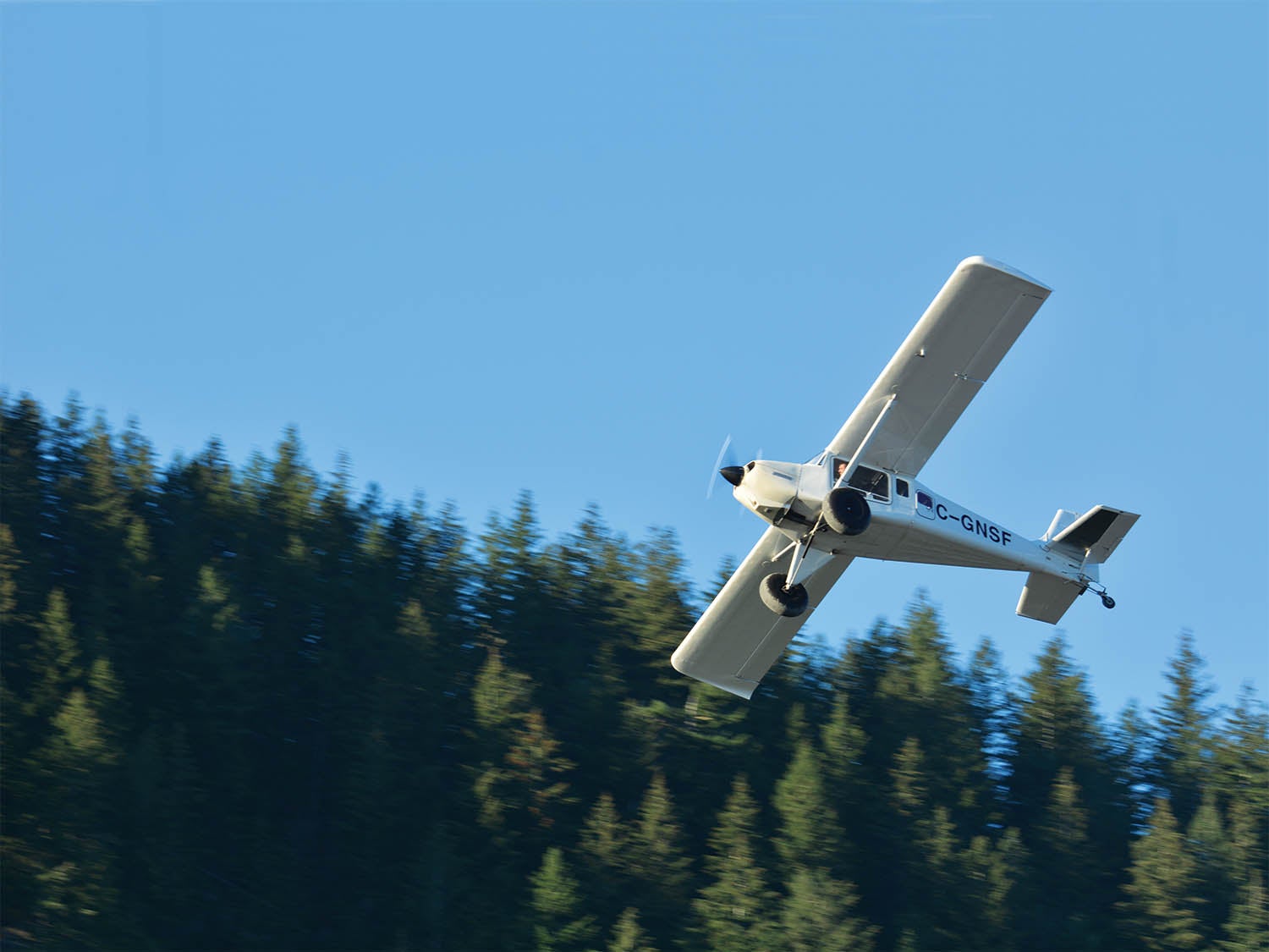

Radical Flying

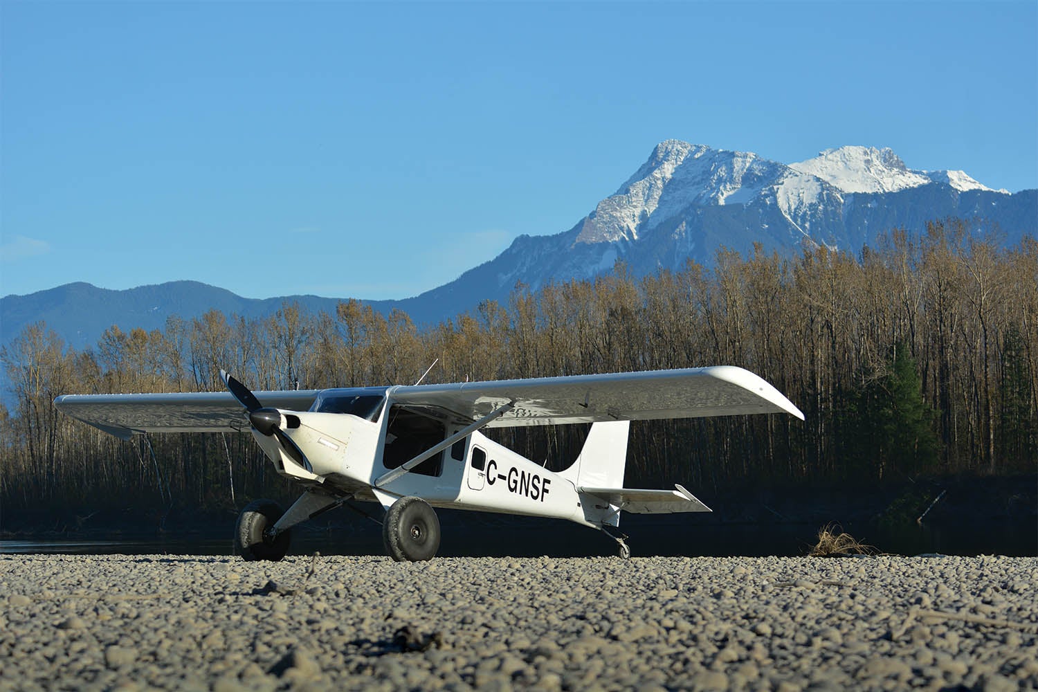

Walking up to the Radical it comes off as just a little larger than you thought. Much of that is the generous 36-foot wingspan propped up on 31-inch tires—tall guys appreciate the little extra height under the wing. Thanks to the large, single-piece, upward-hinged doors being completely out of the way when opened against the bottom of the wing, getting yourself or gear in the Radical is a wide-open task. Tall people need to slide the front seat all the way aft before entering or risk an awkwardly stiff moment getting their feet around the control stick. Once in, there is truly generous room for two big adults; there’s no need to rub shoulders, only to scoot the seat forward to reach the rudder pedals and assume a flying position. Legroom is unquestionably large and headroom is open as well. With no spar carry-through and a reasonably tall cabin there’s no sense of having your head up inside the wing roots.

With 180 hp and plenty of high-lift wing, the Radical is perfectly capable of getting out of tight spaces at steep angles.
It is, at least, an enjoyable cruise. The Radical delivers rock-solid stability, pleasing and well-harmonized control forces and little need for attention in level flight. It really does just about fly itself, with only an occasional correcting pressure needed. Marco hasn’t bothered with an autopilot and none is needed as the point is to go flying anyway. You won’t be shooting an ILS as a matter of course and the piloting workload is inherently low, leaving plenty of brain cells to soak up the scenery or think about the big fish you’ll catch from the boat you’re carrying.

Wide-open access to the Radical cabin is given by its two gas-strut assisted doors. No latch is needed to hold them open and the doors are never in the way when open.
