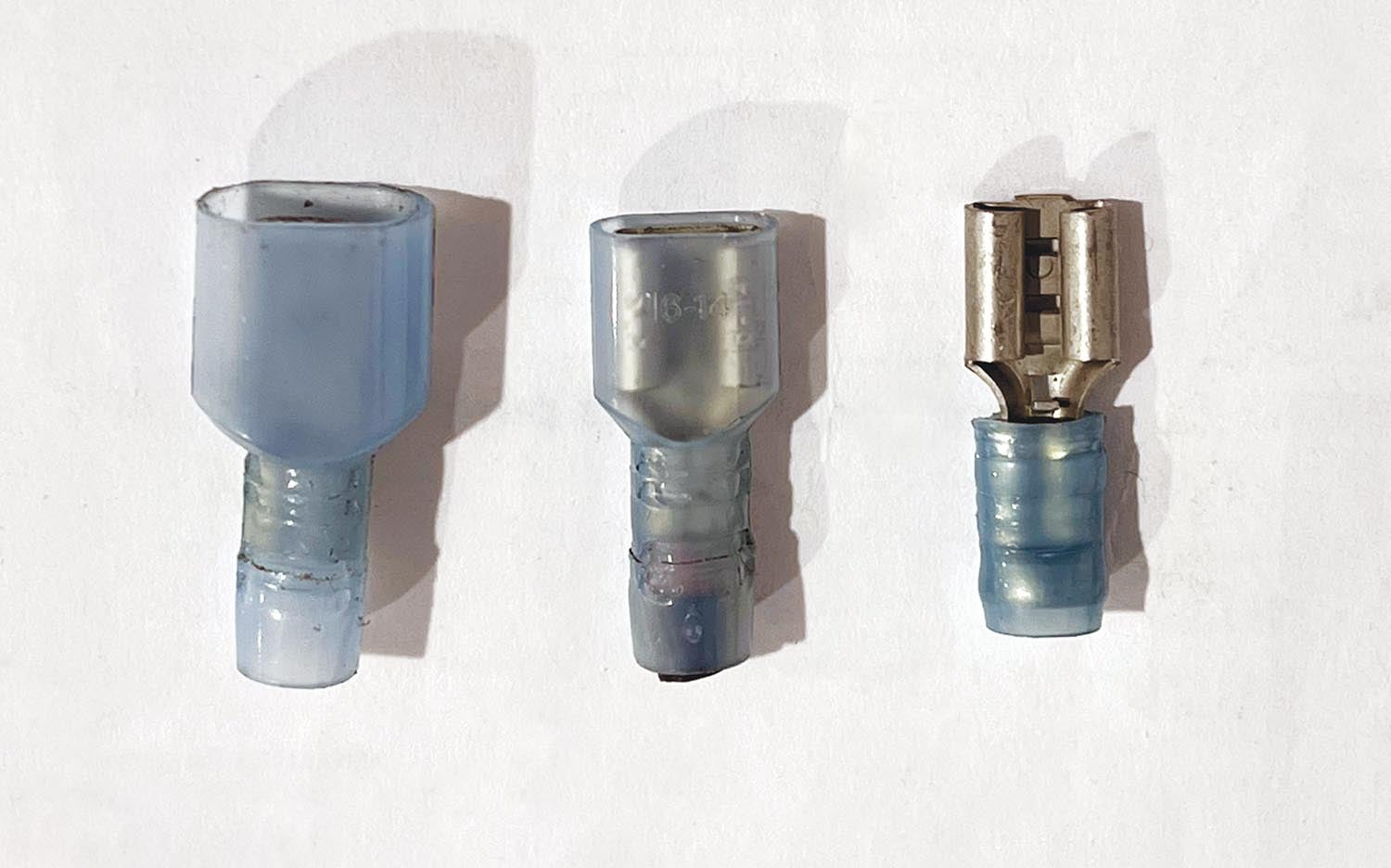

bad crimps 2Well, there was a reason for the lack of an engine start; the fuel pump wasn’t working and George was troubleshooting the issue. I asked what he had done so far, and he was checking the wires to the pump. George is pretty thorough, and he told me that he had measured 12 volts on the positive wire to the pump, so he was thinking that the pump was bad. Sometimes, banging on a fuel pump will cause it to start working, although I wouldn’t recommend it as a standard procedure. Since fuel pumps are quite expensive for injected engines, we wanted to eliminate any other potential causes first. Plus, there was Kyle waiting for an airplane ride!
Bad Crimp closeup
If terminal connectors are not crimped properly with a double crimp tool, they can come loose over time and cause high resistance. Initially, the failure will show up intermittently.
For grins I think we remeasured the voltage and, sure enough, it had 12 volts on the positive lead. I noticed George was taking the measurement from the positive wire to ground. I asked if he had measured between the positive lead and the pump ground wire. He had not. Guess what? That measurement showed less than 10 volts. When George went to change the connector on the end of the ground wire, it almost fell off.
I looked closely at the terminal and really didn’t like what I saw. The crimp was not exactly a strong double crimp. George agreed and replaced the crimp. Guess what? It still didn’t work. Hmm. That left one other connection—the ground wire. It had the same type of terminal on it. When George went to replace it, it almost fell off in his hands. There wasn’t much wire left to work with, but a quick temporary fix was to add a length of wire and make a new ground connection. It all worked and the day was saved.

This isn’t the first time I have seen this type of problem. As the fleet is aging, crimps on terminals that were not quite made properly 10–20 years ago are beginning to cause problems. Heads up for those of you who might have aircraft of this vintage. It usually starts intermittently and then progressively gets worse, until Murphy raises his head and says, “I’m here to mess with your fun factor today!”
