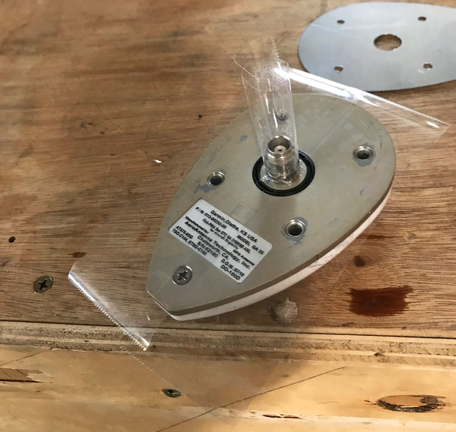

To start, be sure to tape the antenna base and the coax connector so that it doesn’t get embedded in the shim.

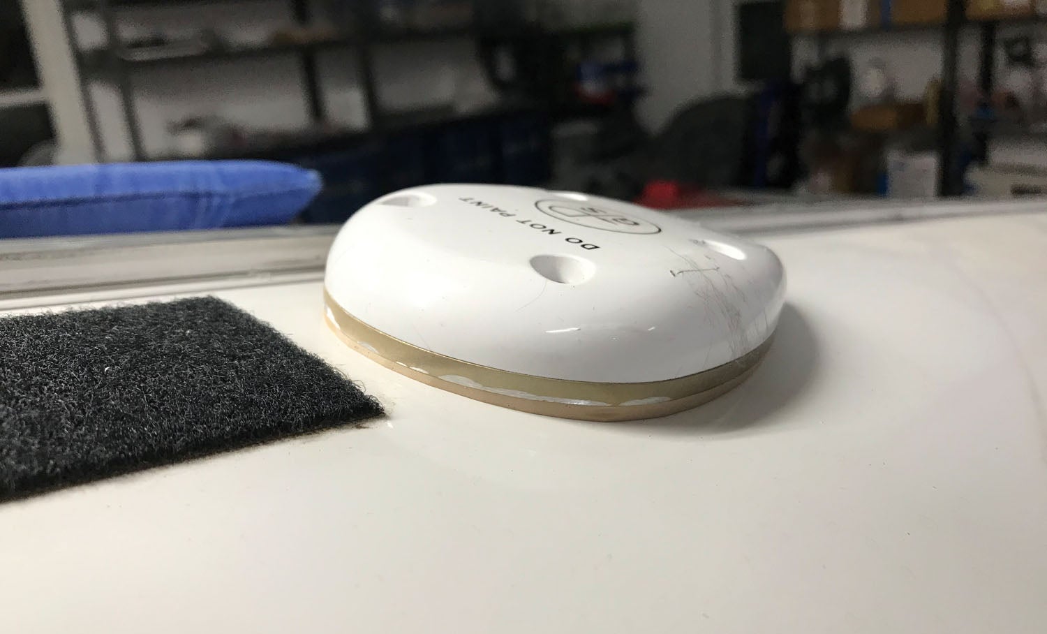

Then mix the resin and micro to a thick consistency and slather it on the antenna.

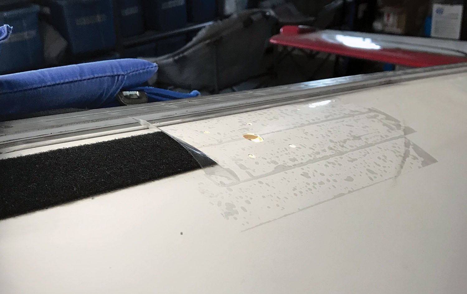

The process works like this. First, I drilled holes for the antenna in the skin—both for the coax connector and the mounting screws. After deburring the holes, I taped over the area with clear packing tape. I also taped up the bottom of the antenna and the TNC connector. This tape serves as a release plane for the shim because the resin won’t stick to it.

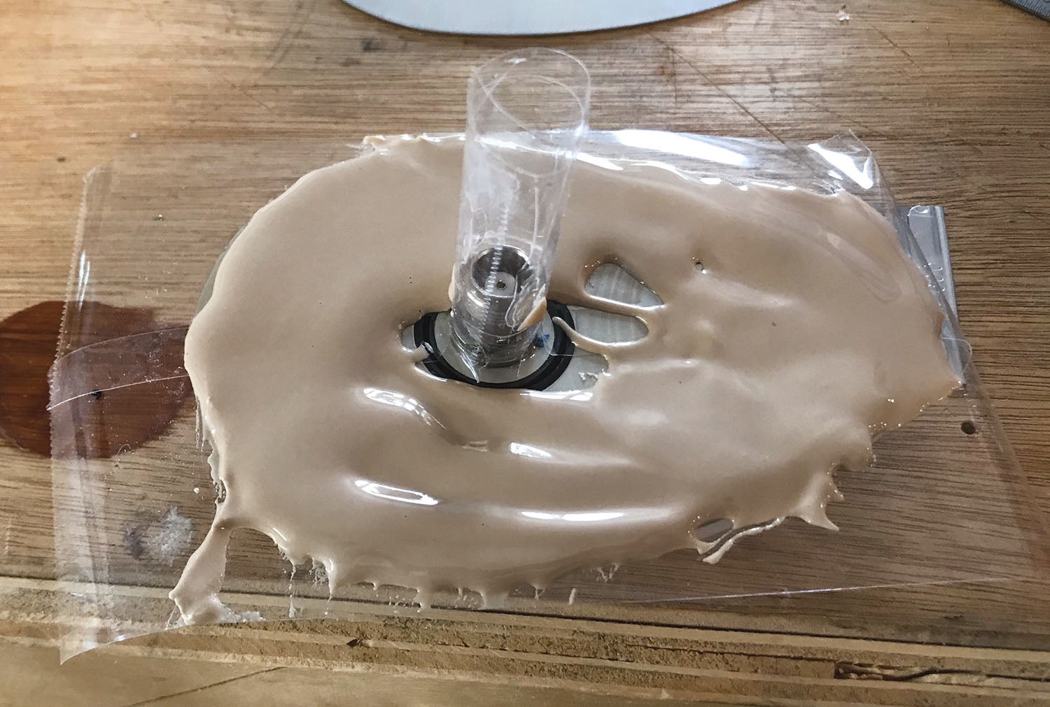

Push the antenna into place until the resin squishes out all the way around. Now you wait. Go do something else.

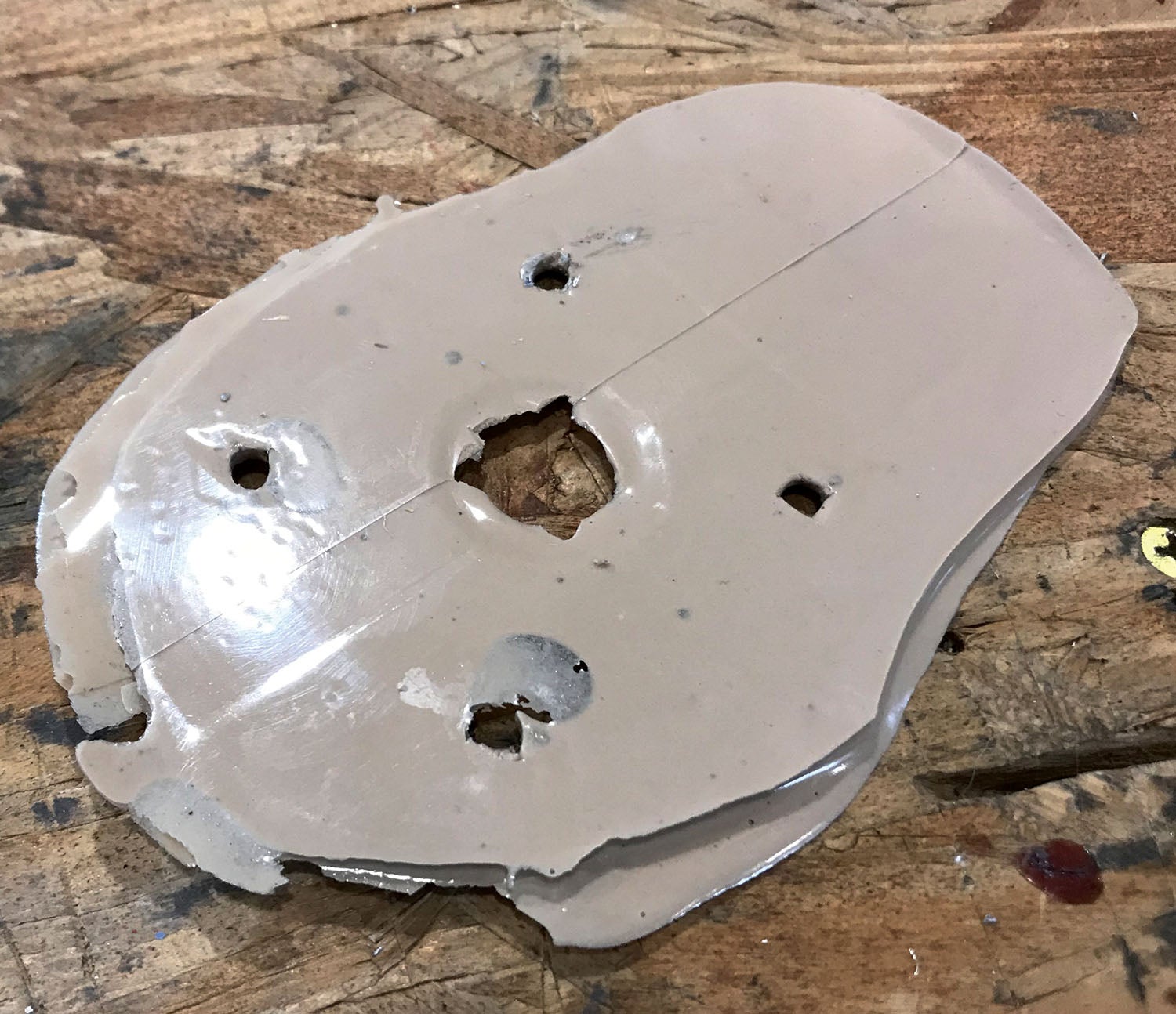

I next mixed up just a little resin and added micro-balloon filler until I had a very dry mix—more like putty than toothpaste. I didn’t want it to run at all. I then slathered the mix onto the antenna—more at the edges than in the middle because that is how the shim would be shaped. With one smooth motion, I smooshed the antenna on to the fuselage and inserted the mounting screws after giving them a light coat of WD-40 so the resin wouldn’t bond to them. I didn’t put nuts on—I just used hand force to push the antenna until I had a nice squish out of the goop all the way around, and the centerline of the antenna was almost flush to the skin. Then I went to dinner.
gps antenna curved surface 05

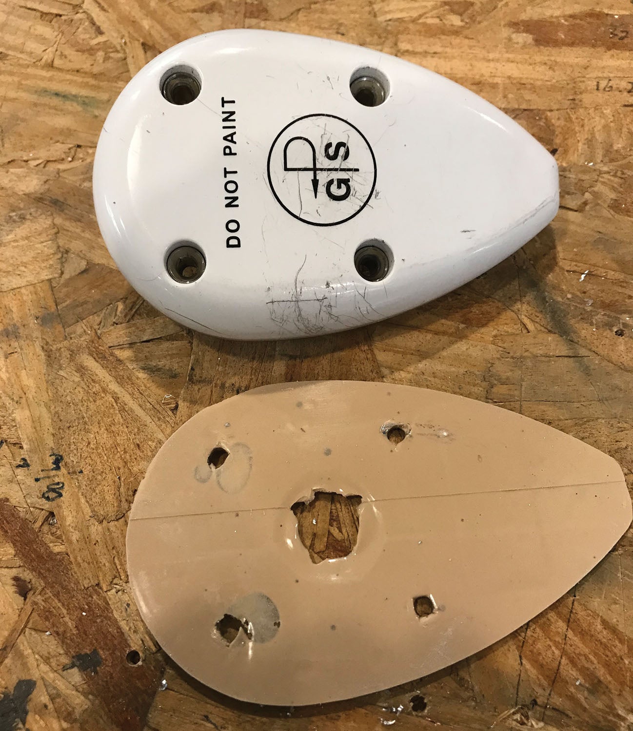

Here’s the untrimmed shim—the right shape is in there.

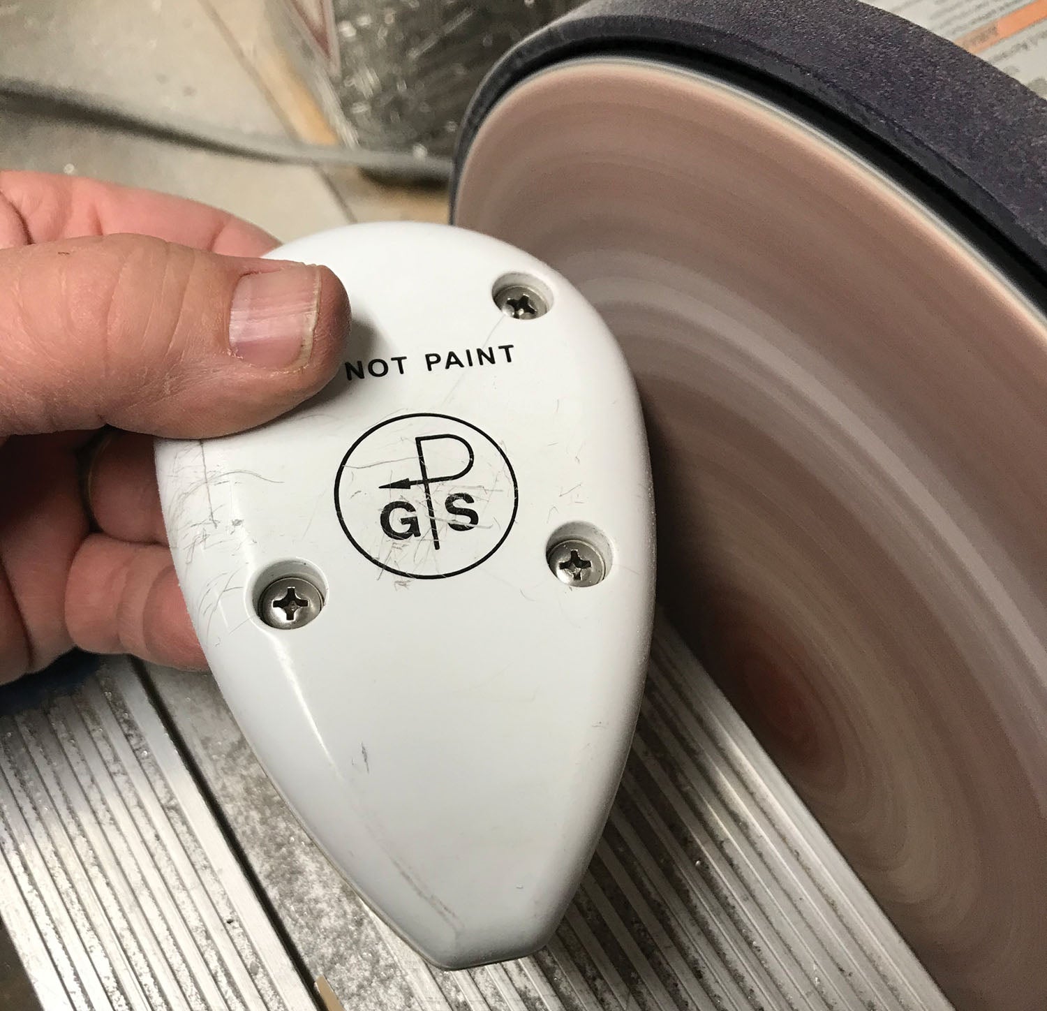

After about two hours (hey, it was an airpark dinner with lots of hangar-flying to be done!), I came back and the warm temperatures had hardened the shim nicely. The antenna popped right off due to the release tape and the shim popped off the tape on the fuselage as well. After removing all the tape residue, I attached the shim to the antenna with the mounting screws and nuts and headed to the disk sander, where I removed the excess material and shaped it perfectly to the base of the antenna.
gps antenna curved surface 06
Mount the antenna to your shim and carefully sand the edges until they match.
Then it was back to the airplane, where everything bolted right up! I now had a perfect fit of the flat antenna to the curved fuselage—and per the note in the Garmin antenna manual, grounding was not an issue, as it is grounded through the coax connector.

  1. Did you weaken the sticky side of the packing tape that you put on the fuselage? It’s pretty powerful stuff and I wonder about taking up the paint.
    • I’ve honestly never had a problem with it lifting paint – of course, there can always be a first time, so if it worries you, there is also vinyl “bundling tape” in 2” widths at the home improvement stores that does a good job at releasing, while (subjectively) being lower adhesion. It is also thicker than packing tape, so will change your sizing just a touch.
