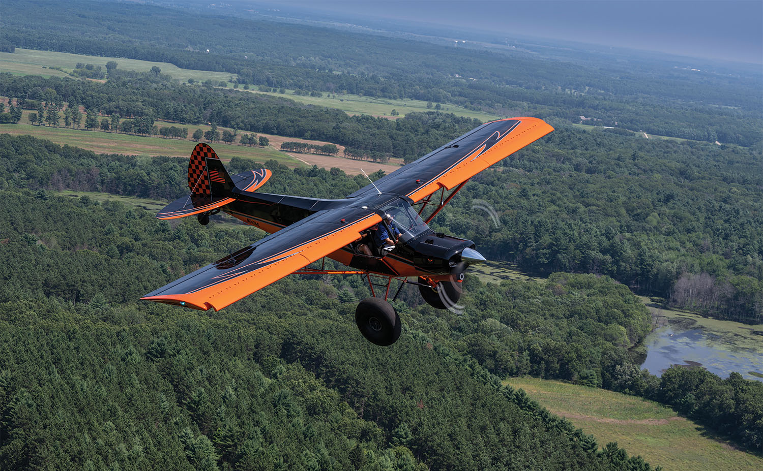

Legend MOAC Z622336 R VanderMeulen
The Titan IO-370 provides almost 200 hp to haul the MOAC around the sky—and helps get it in and out of tight places with ease.

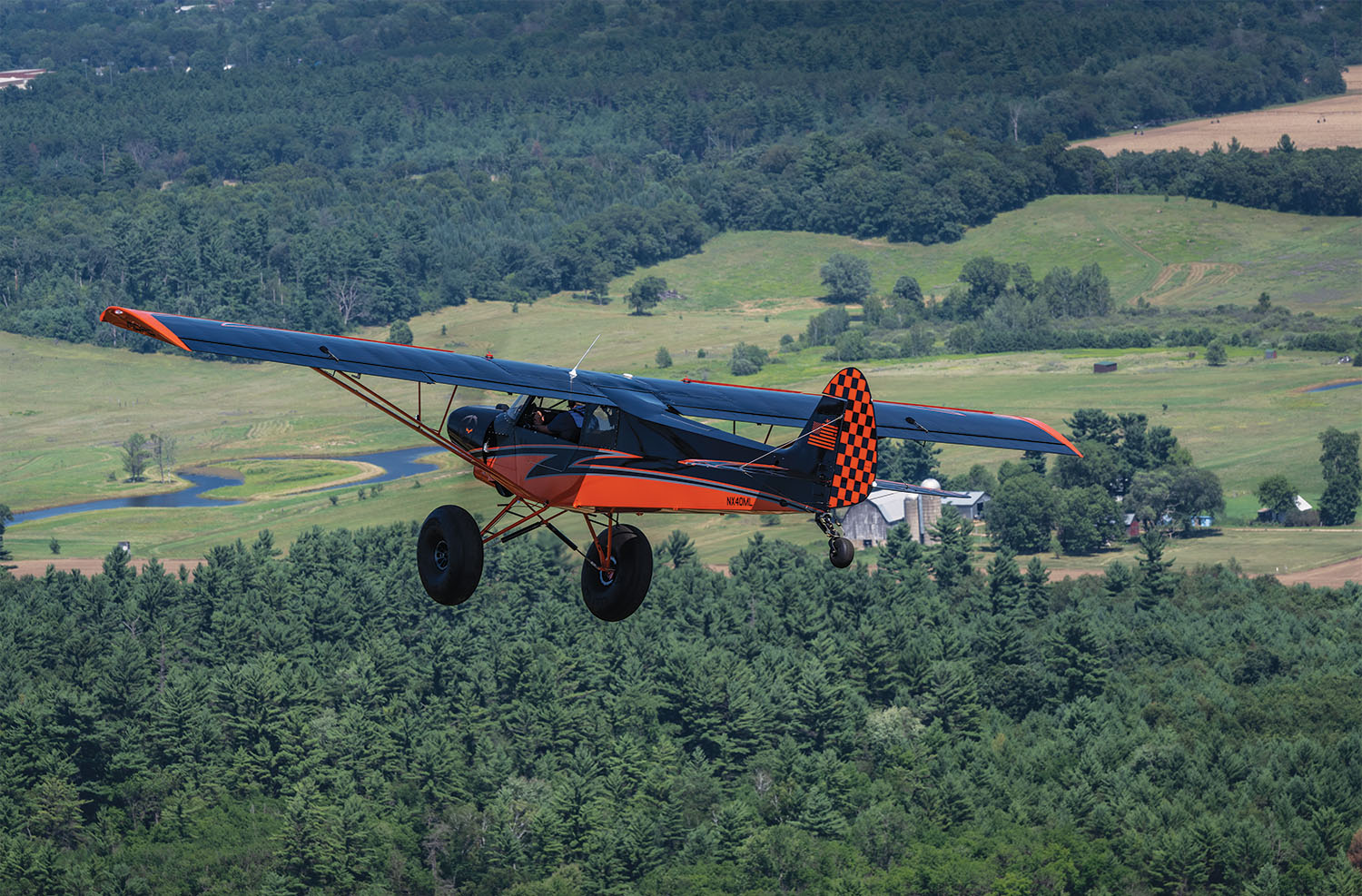

Legend MOAC Z727823 R VanderMeulen
Squared-off wingtips and lots of slats are a sure sign that this airplane loves to fly slow. The slats come in two pieces on each side, adding up to four moving parts.

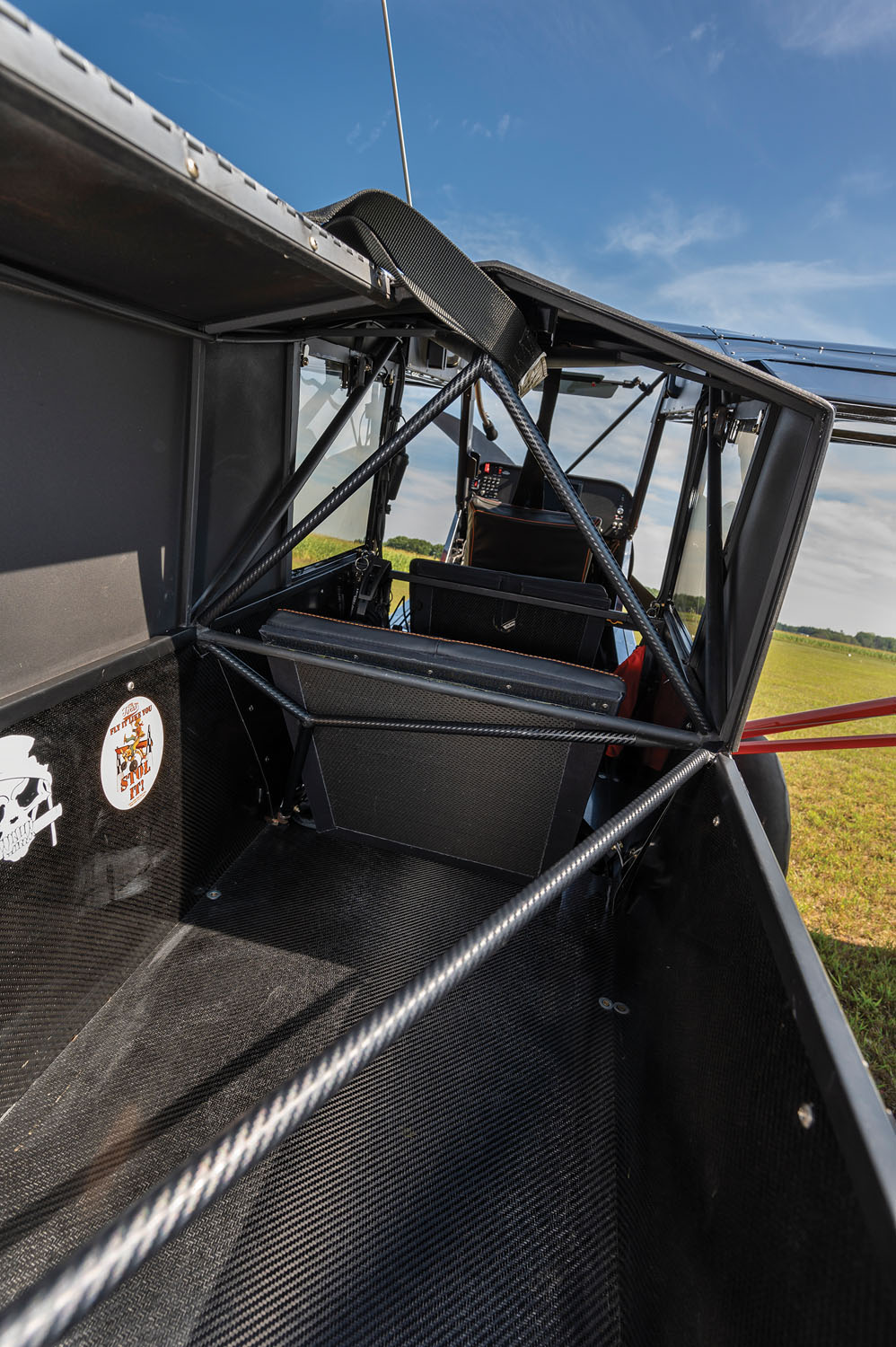

Now let’s get to the cockpit. Yes, there are three seats that you see in the pictures—you can put an actual person in the baggage area…legally! Of course, you can also put baggage back there and extend it all the way back toward the tail. But make sure to do a careful weight and balance before you fly that way. The large tail helps with the CG, of course—that is part of the reason it is there. The third seat (and seat belts) definitely helps with the flexibility of the airplane—baggage, people, dogs—whatever you need to haul, you can probably fit it in, so long as it’s not a bunch of gold or lead.
Legend MOAC Z622376 R VanderMeulen
No matter how many times you count it, there are still three seats in this tandem airplane!
