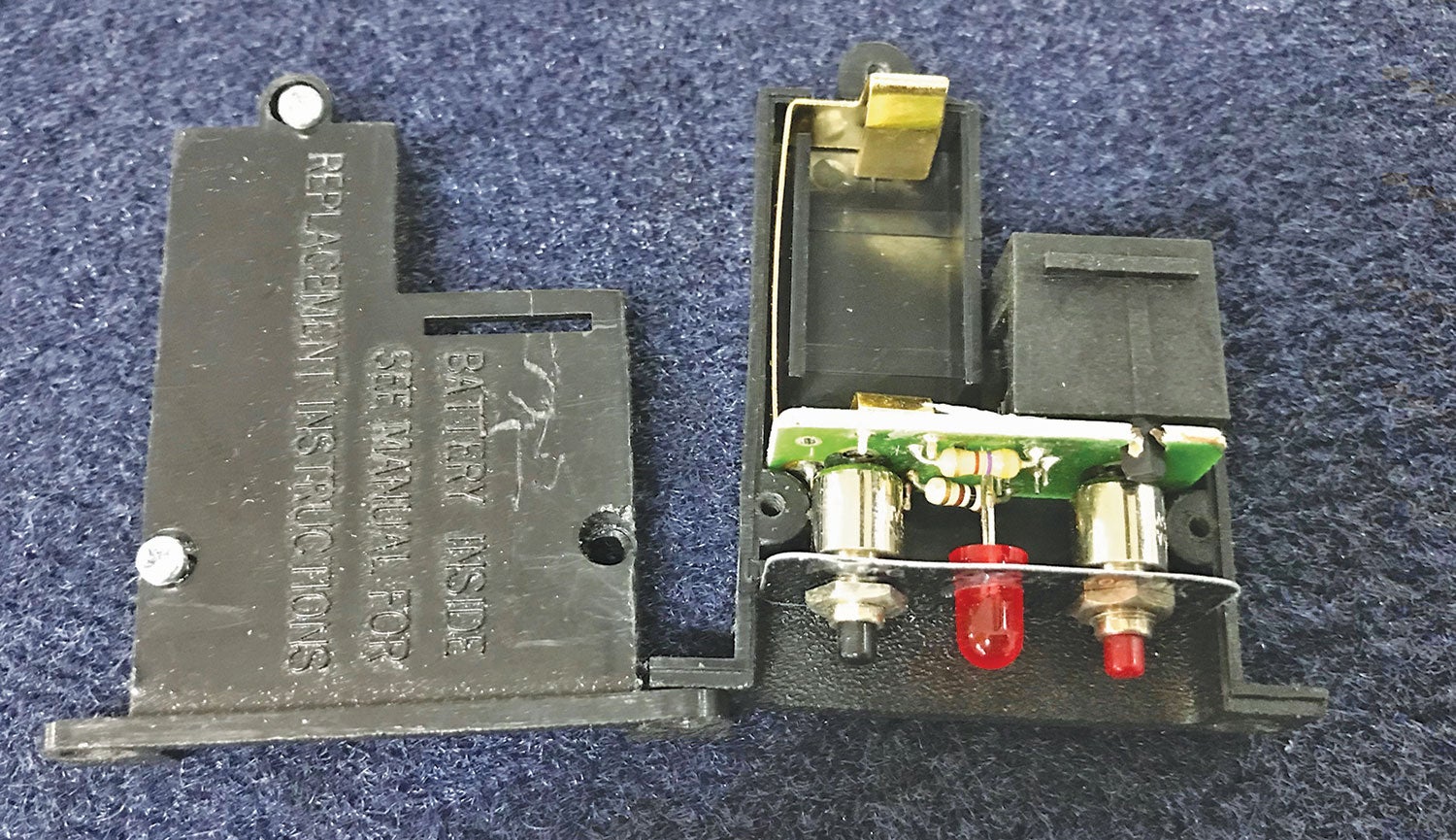

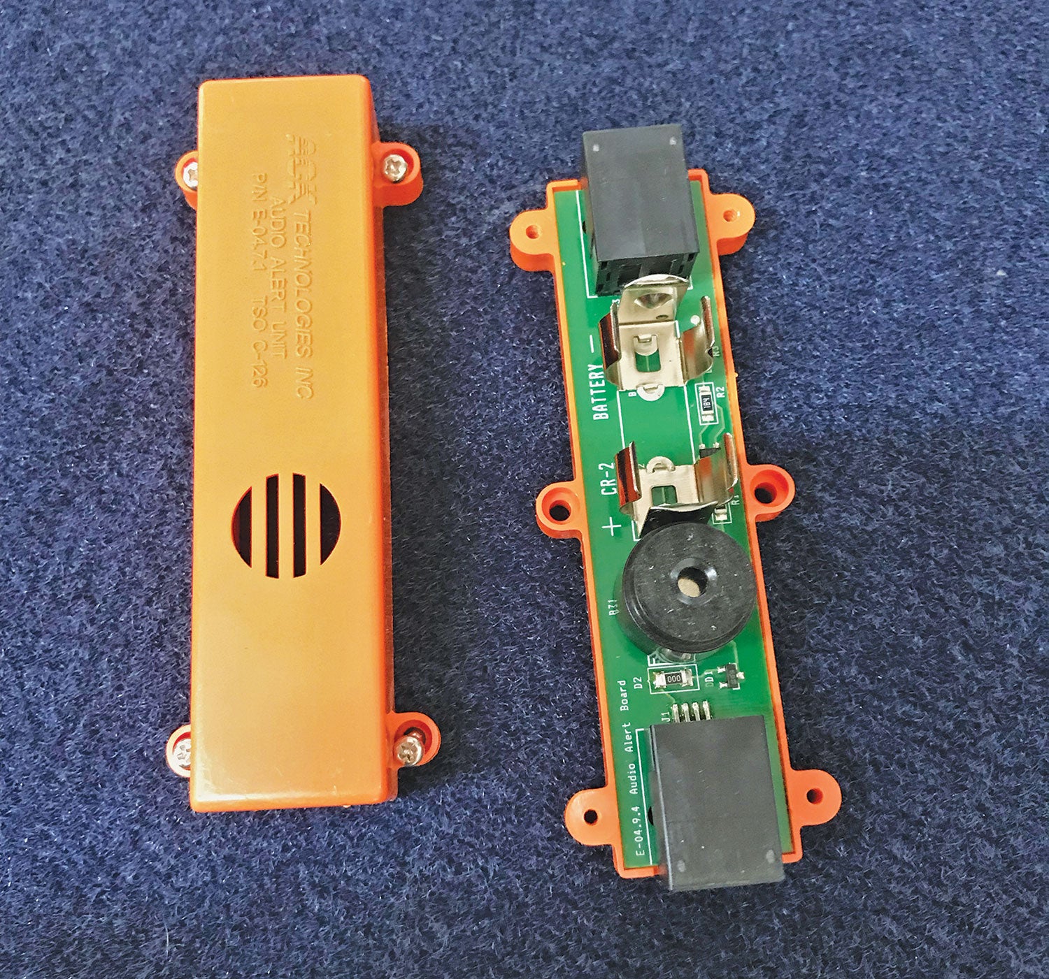

ELT missing battery 1Many aircraft owners don’t realize that some ELT control panels and audio alerters have their own separate batteries, which must be installed at installation and then checked for date of expiration. I have seen numerous airplanes that will not pass an annual ELT check and have traced it to the missing batteries in these components.
