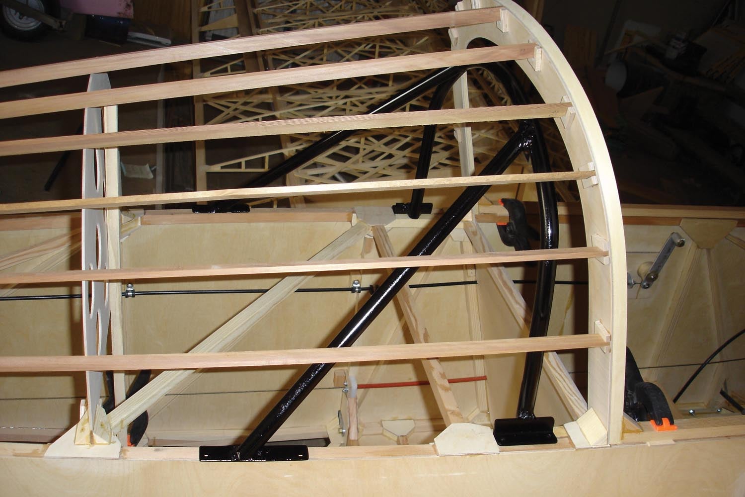

Making the box fuselage 2 inches wider was easy, and keeping the sides perpendicular to the firewall further simplified construction.

To make it even more comfortable, he made the fuselage 2 inches wider. Stock, it measures 24 inches exterior to exterior. Increased comfort was not his only motivation. Hongisto planned to use a two-cylinder, 60-hp HKS 700E engine, and with the 26-inch wide fuselage, “it fit without its cylinders hanging in the breeze.”
Except for the wider fuselage, “the longerons, spars, and external dimensions are stock” he said. “I stayed away from structural changes. Not knowing what I didn’t know, I didn’t want to venture out and affect the safety of the aircraft.”

Building the wider fuselage was less involved than the stock design because it was parallel from the cockpit to the firewall. “The plans had you taper the fuselage forward to the narrower than 24-inch firewall so the cylinders of a half-VW engine would be in the slipstream.”

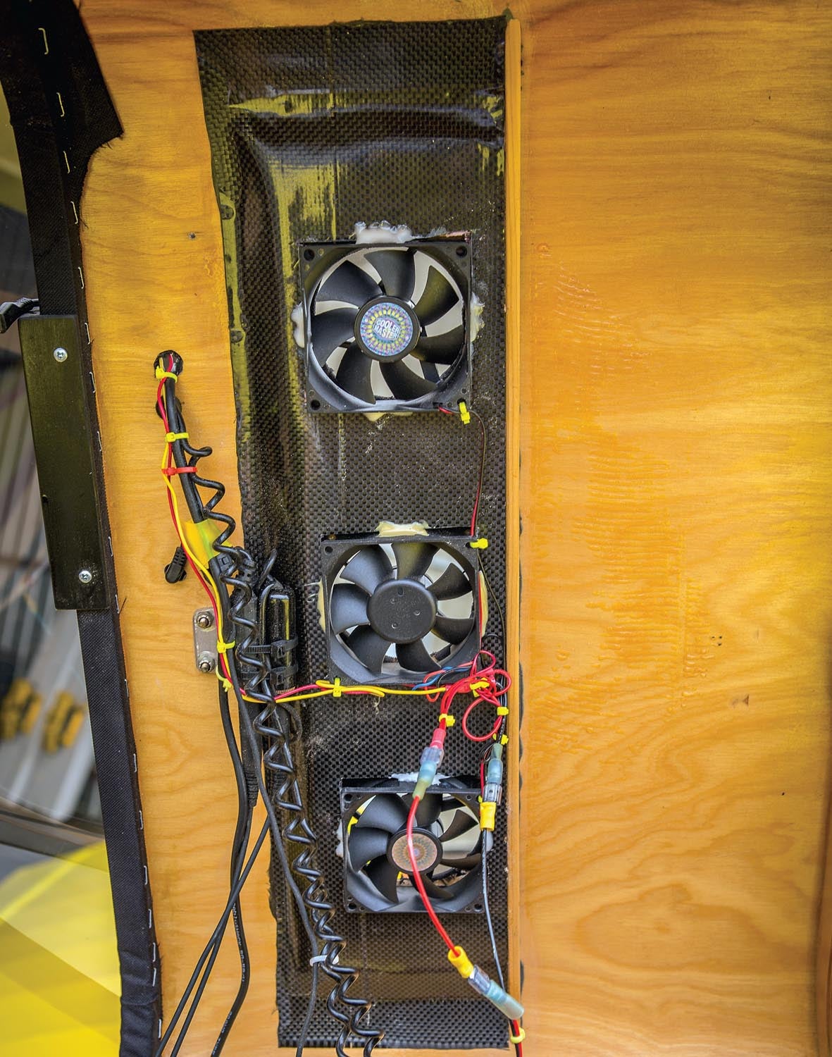

Three computer cooling fans keep the canopy clear, even when the temps fall below zero.

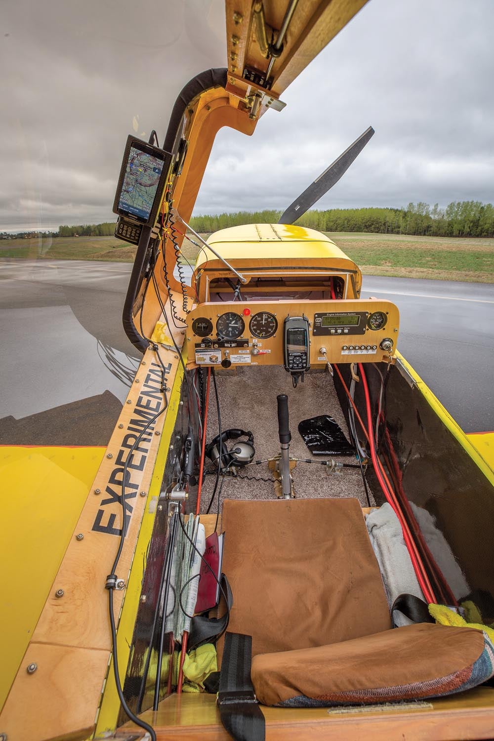

The instrument panel is VFR Spartan. A compass, altimeter, and airspeed indicator balance a GRT Avionics Engine Information System. “It has everything you need in a compact package. I installed it myself, and it’s worked perfectly since day one.” He wasn’t so lucky with the electronic fuel gauge. “It started picking up some interference from someplace, and it wouldn’t read right, so I abandoned ship’s power and built an AA battery bank to power it.”
To navigate, Hongisto mounted a handheld Lowrance Airmap 100 GPS to the panel, a handheld radio to the side, and on the glareshield, a cell phone running Naviator, a full-featured aviation app with GPS moving map. There’s no transponder or ADS-B, and no plans to install them. “I don’t fly in that airspace.”
Borrowing from the MiniMAX, Hongisto designed and built his own canopy. Yawning wide to the left, it provides easy access to the baggage compartment behind the seat. Today’s Avenger kits give builders an option of fresh-air flying, but flying without the canopy would make the turtledeck a huge parachute.
The instrument panel is home to, from left, a compass, altimeter, airspeed indicator, a Lowrance Airmap 100 handheld GPS, and a GRT Engine Information System. On the glareshield, an old cell phone runs Naviator, a full-featured GPS-powered aviation app with moving map.

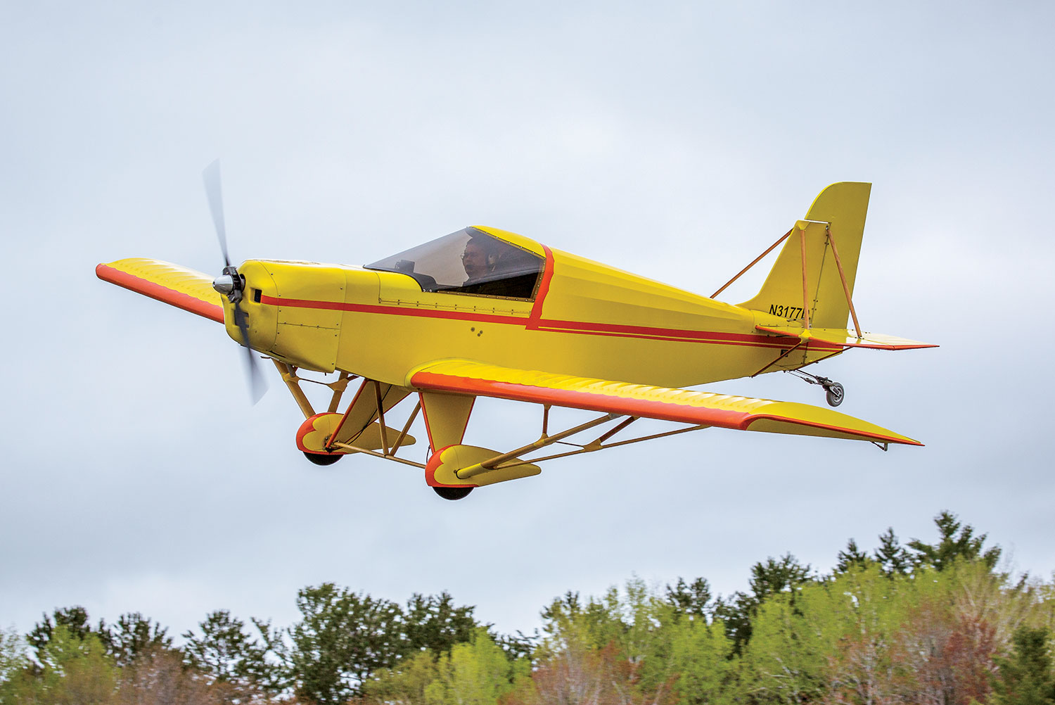

The Avenger gets off the ground in about 200 feet and climbs at 500 fpm.
To eke out every mile per hour, Hongisto streamlined all of the round struts with fairings and solid pieces around the tail braces. “I’ve covered most of the strut junctions, and I made wing root fairings out of fiberglass,” and he sealed the aileron gaps. This effort increased cruise speed to more than 100 from 75 mph.

A computer cooling fan centered in the glareshield “got rid of most of the frost on the windscreen, but I was still scraping frost off the sides,” he said. “Putting fans on either side of the center fan solved that problem.”

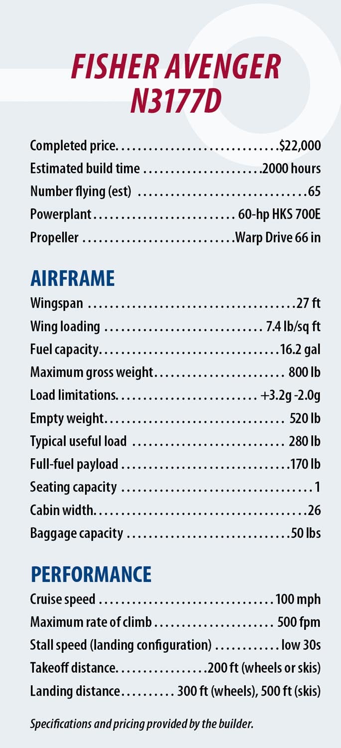

avenger specsHe made a 2-foot-square test panel with two plies on top and bottom. For a static load test he jacked up the front of his truck, and “it held up and didn’t delaminate.” After removing his truck, “to simulate landing on snow I beat on the bottom with a hammer, and I couldn’t delaminate it, so I decided that it would probably work as skis.” The 15-inch by 5-foot snowboards cost him 15 mph.
