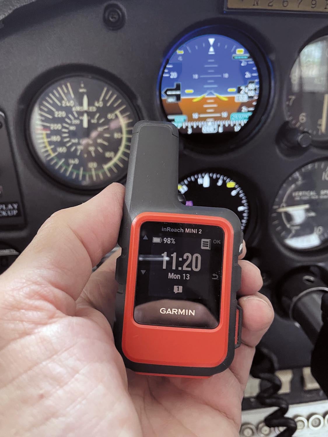

Garmin inReach Mini 2
Garmin’s latest-gen inReach Mini 2 has an improved display and the same compact chassis as the older Mini. If you use other compatible devices in Garmin’s lineup, including wearables and navigators, the Mini 2 can link up via Bluetooth.
Garmin’s latest-gen Iridium-based inReach Mini 2 is $399. For now, Garmin said the original $349 Mini will stay in the product line along with the new Mini 2, which works the same way and has a tight Bluetooth interface with the Garmin Pilot and Garmin Explore apps, plus it interfaces with some Garmin wearables and portable navigators. It weighs 3.5 ounces and in our testing, we found the Mini’s receiver performance good. There are good reasons to spring for the Mini 2 for the extra $50. It has a better—not bigger—display (0.9 by 0.9 inches, with a 176 by 176 pixel resolution, versus the 128 by 128 count on the original Mini) and an IPX7 waterproof case. The inReach Mini series has a simple control set with a total of six buttons, and the Iridium satellite antenna is nicely molded into the chassis. The control set is logical and durable.
Free-form messages allow you to type as you wish directly from the Mini and also from the Garmin D2 Charlie aviator watch, plus from some Garmin Forerunner and Fenix-series watches. It connects wirelessly with Garmin’s ANT+ technology, which is also used for many other Garmin products.
When sending messages from the Mini, you scroll through the functions using the up and down keys on the right side of the case. To type out a new message from scratch, scroll through the menus and select the Write Message option (with the OK key). Typing a message can be slow because you pluck each character (including space and backspace/delete)—one at a time—from a vertically scrolling alphabetical list on the far right side of the display. Once you have your message in place, hit Send and it’s off. You’re limited to 160 characters per message. Forget about photos, although you can post a message to social media, including Facebook, Twitter and to your MapShare page.
You can also receive messages, of course, and the device checks for new ones at predefined 10-second intervals. You can customize the time intervals, but the more you update, the more battery life you’ll eat. You can manually check for new messages, but the most frequent two-minute interval is only available on the premium subscription plan.
