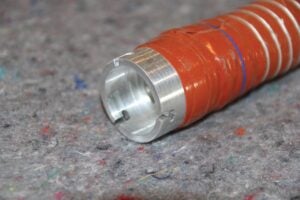

If you have a lathe, you can make your own bayonet receiver to connect the mask hose to the regulator hose. The fittings are also available online with a little searching (try eBay, or www.flighthelmet.com)

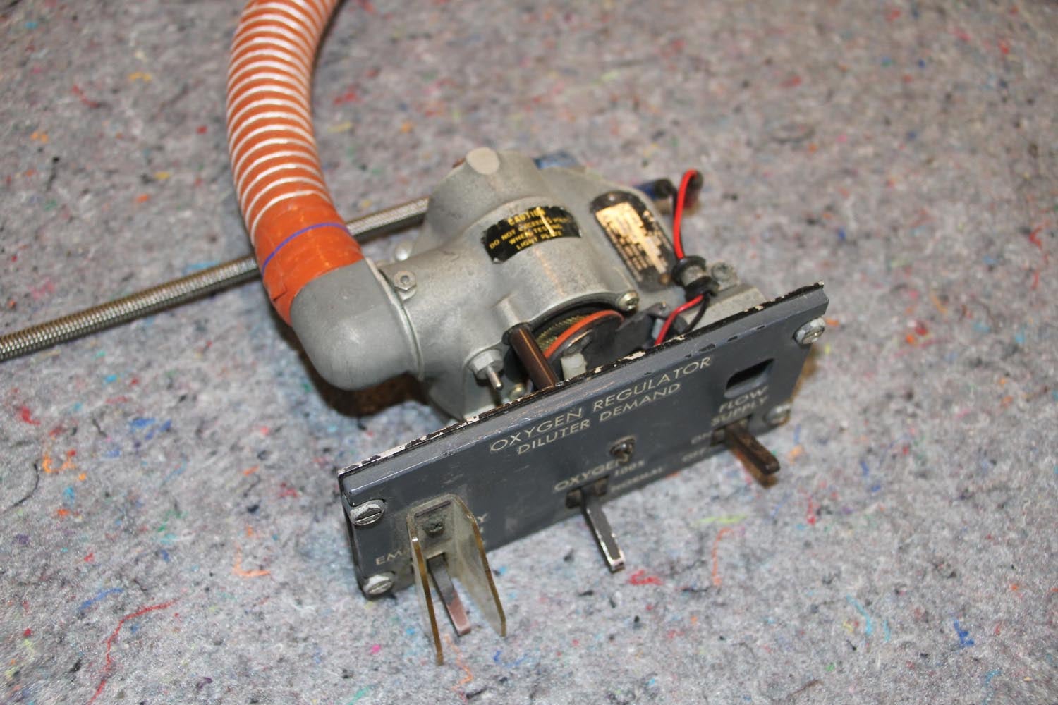

In building up systems to use in specific flight tests, we acquired two different second stages: a CRU-79/P, which is a personnel-mounted compact regulator used by the Navy, and a Scott/AVOX 28000 panel mounted regulator. As we talked about earlier, the first one is very small and easy to mount, but less controllable and somewhat wasteful. The other has multiple modes and can be set up to be reasonably efficient, but you have to put up with a larger package.
Deciding which is appropriate will come down to your planned mission. If, for instance, you want to wear a mask for protection and oxygenation for the length of a Reno pylon race, the CRU-79/P is probably a perfect choice. If you are looking for something to give you good, safe O2 at altitudes for long cross-country flights while catching great tailwinds, the 28000 is probably a better option. Neither requires power—both are purely mechanical devices (although the panel mount might have wires for panel lighting, a nice feature that doesn’t affect its ability to deliver O2 but does make it more visible at night).

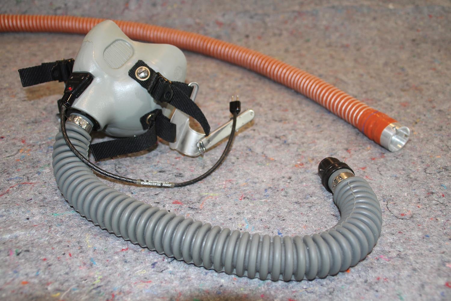

I already have an HGU-55/P helmet and an MBU-12/P oxygen mask, both functional and converted to civilian communications. I usually use the helmet for testing flights, with a boom mic instead of the mask. The end of the mask hose is a typical 3-pin bayonet fitting.

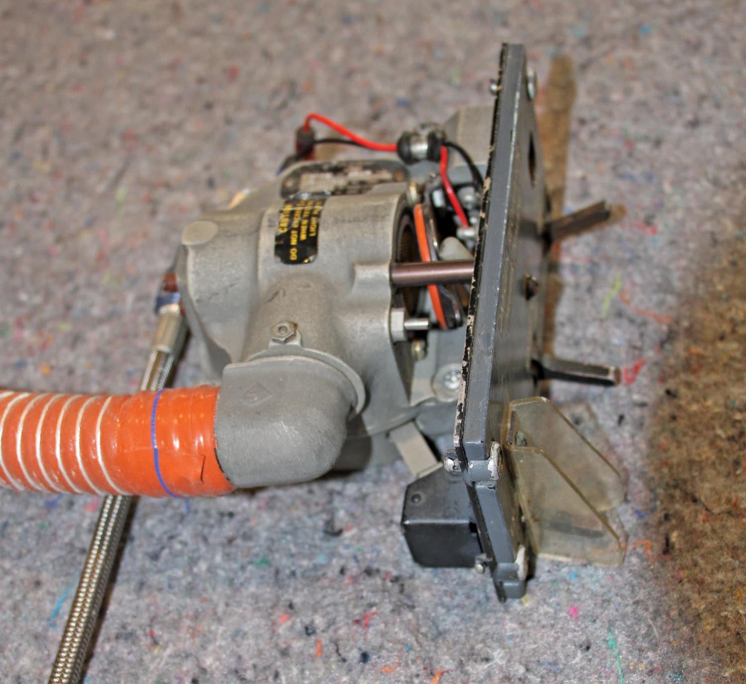

I found a yellow-tagged Scott/AVOX panel-mount diluter-demand regulator on eBay from a salvage company whose business, apparently, is taking apart old Boeings. The price of the regulators I saw varied between $60 and $150, and it is probably not necessary to point out that you oftentimes get what you pay for. In good condition, it checked out fully functional when I connected it to a 50-psi oxygen supply. As a bonus, the panel lighting even works! The intermediate oxygen pressure connector on the back was for a 5/16-inch flareless aviation connector—problematic because we just don’t use these much in GA. The output to the mask is a large-diameter hose opening measuring 7/8-inch O.D.
The first thing I needed was a compact first-stage regulator to mount to a portable bottle with a CGA-540 gas valve. A little internet searching turned up medical regulators that were perfect for the job, and I settled on a MERET CGA EMS BRUUT. This came equipped with medical standard DISS fittings, which have built-in check valves so that you can connect and disconnect oxygen hoses without turning off the bottle valve. Of course, those don’t really attach to anything we’d use in aviation, so an adapter was necessary. More internet searching for “DISS to NPT” adapters turned up machined adapters for a few dollars; the shipping, of course, costs more than the part. Going with 1/8-inch NPT fittings gave me an entry into the 37-degree AN flare fitting world. I happened to have a nice length of steel-braided, Teflon-lined hose with AN4 straight ends, but if you don’t, you can easily have one built, or get one from the usual supply houses (Aircraft Spruce and Summit Racing are two examples).

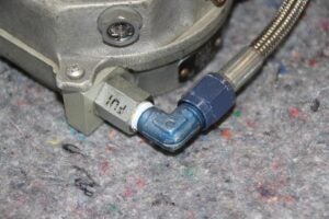

Fitting the intermediate pressure hose to the second-stage regulator was more of a challenge since flareless -5 fittings are pricey. What I wanted to do was get out of that world as quickly as possible and into something I could use, so more internet searching lead me to MS21900—the part number that adapts from flareless to AN. Not that I wanted to part with $50 to buy one…but the actual spec is available online at www.everyspec.com, and it showed me that the body is a standard straight 1/2-inch x 20 threaded fitting. This allowed me to go to my lathe and make a simple cylinder with a female 1/2-inch x 20 on one end and a female 1/8-inch MPT hollow on the other. The 1/2-inch x 20 side needed a relieved space at the open end for an O-ring, which you slip on the male end (the part attached to the regulator) in order to seal. Screwed together, I now had a 1/8-inch NPT female on the back of the reg, and it was easy to attach a straight NPT to flare AN nipple.
So now I had oxygen flowing from the bottle to the output of the regulator, and 7/8-inch ID hose slid onto that. The other end of the hose needed to attach to the mask hose, and while you can buy the appropriate bayonet fitting from Flight Helmet, LLC, I already had my lathe set up, so I turned an adapter that received the mask hose end and terminated in a 7/8-inch ID end (with a little bulb) that fit on the hose coming from the regulator. Cutting the three openings for the bayonet fittings took a little drilling and Dremel work, but only about half an hour—less than it would have to figure out how to do it some fancy way. How does it stay tight and seal? The end of the oxygen hose attached to the mask has a spring-loaded concentric center section; the act of pushing it into the adapter tensions it against the bayonet pins and seals it. So the depth of the adapter is important!
It’s also important to remember that when working with oxygen, you never want to introduce hydrocarbons into the equation—so if you use cutting oil, you need to remove all traces of it. If you are reusing AN fittings from your parts bin, clean them up, just in case they have ever come into contact with oil or fuel. Remember, O2 systems must be squeaky clean, or you can have a terrific fire that will easily simulate an explosion. No sparks—use brass for moving parts.

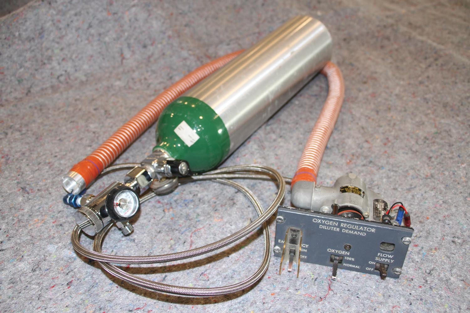

Here’s an entire functional system with bottle, first stage, hoses, and the panel-mount regulator.
Fully Functional
Since this is a one-human system, and the RV-8 is a two-seater, there is plenty of room to put the bottle in the back seat, strapped down with the harness. The regulator can sit in the passenger footwell, doing a very good imitation of being mounted on a side console. The bottle is turned on before takeoff, but the regulator has its own On/Off switch for oxygen flow, so the system is easily isolated. Just check all of your connections before flight to make sure they are tight and don’t leak.
