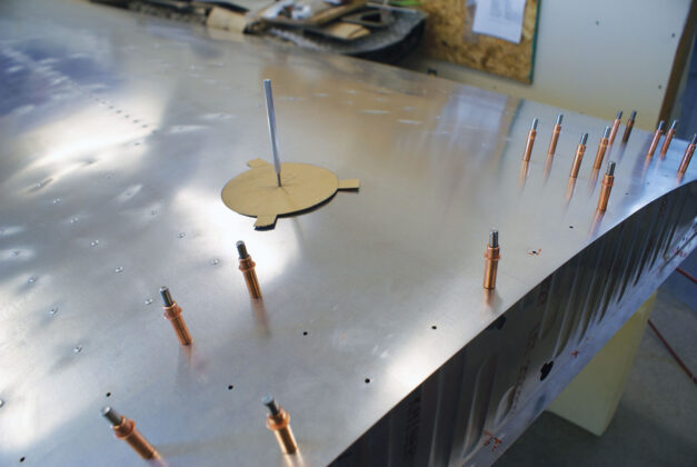

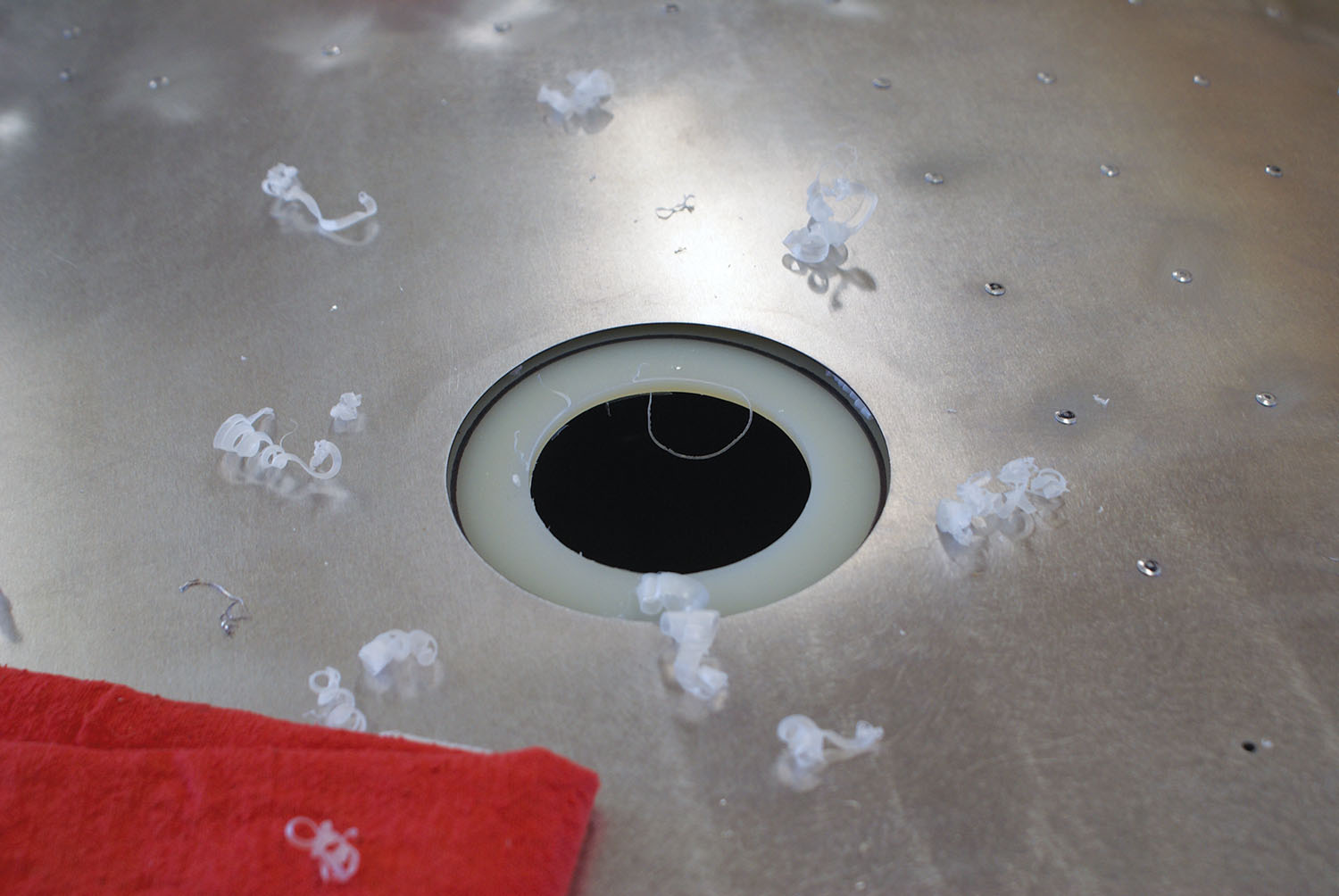

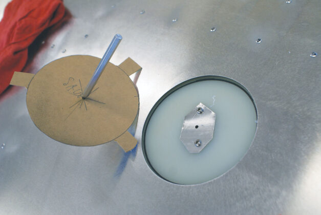

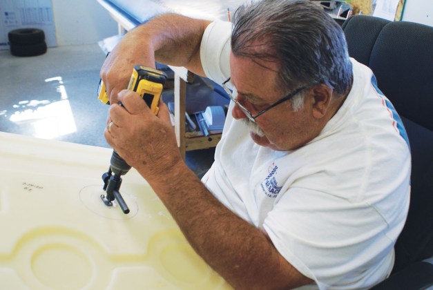

As mentioned, the wing tanks needed a bit of prep before final installation, namely cutting a hole in the top of the tank where the filler neck attaches. Mike, of course, had devised a creative method for locating the center of the tank cutout, so look for “The Tough Cuts” below.
The Artist at Work
It is fun to see Mike in his creative mode because he is like a little boy getting to play with toys. His fly cutter was pretty crazy and fun to watch him “play with.” (Do most men have this many toys? After years of accumulating tools for projects, I guess the answer is yes.) Like most, Mike didn’t mind working on tanks until he got to the Pro-Seal part. Pro-Seal is a glue-type substance used around the fittings to the tank. It’s resistant to fuel and durable. I, of course, had never seen it before, and I couldn’t really understand what the fuss was all about. Plainly put, Pro-Seal is difficult to work with and makes a huge mess even when you try to be very neat and tidy. He lived through the experience, though.

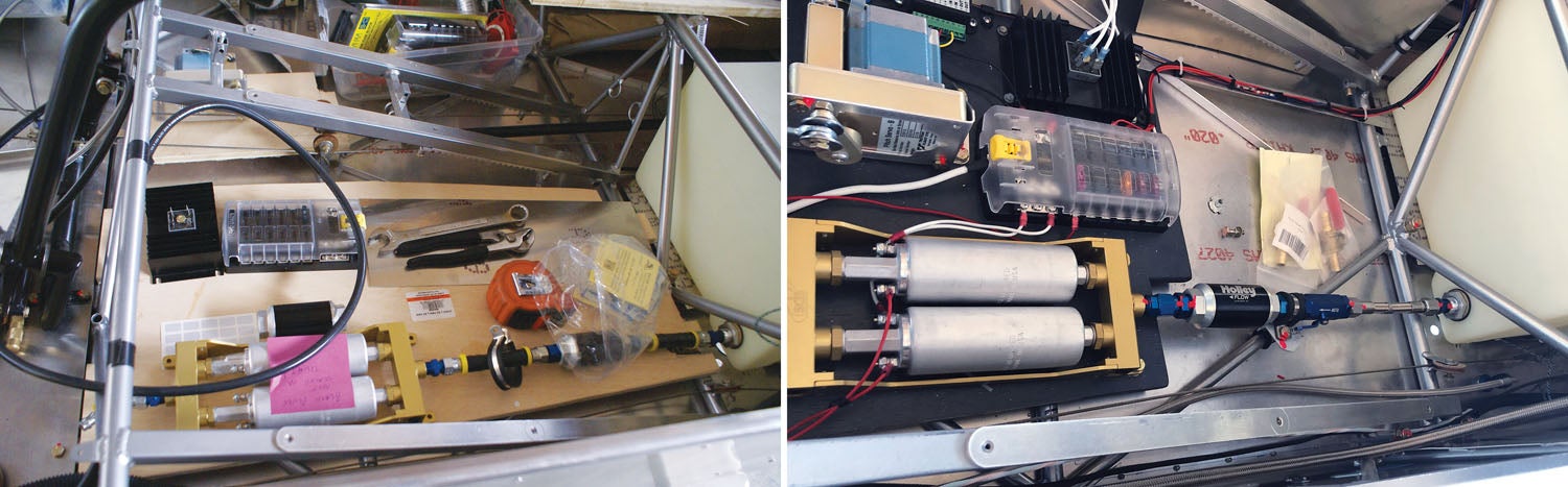

With the header tank previously installed, which was a bit of a wrestling match getting it into the space just behind the pilot’s seat, and the main tanks now placed into the newly hung wings, the real work began on the RANS’ systems. Changes from the original plans were many to accommodate the ignition and fuel system of our choosing. As we hinted in last month’s installment, our S-21 will not have a conventional injection system or magnetos. It will fly with a Simple Digital Systems (SDS) integrated electronic fuel injection and ignition system.
08 HEADER TANK WITHDRAWL FITTINGS
The RANS header tank and all of its assembly parts. This tank will be an important part of the fuel injection system.
This choice was not a last-minute purchase or a rash decision. Oh, no. Mike has been deep in thought over this apparently for many years, even before purchasing  our S-21 kit.
Years ago, when flying our RV-10, we were en route from Northern California to Yuma, Arizona, to visit family for the weekend, cruising along at altitude when it felt like we hit a momentary brick wall in the sky. The engine sounded as if it had stopped momentarily and was right back on again. Mike got to checking the gauges and confirmed that all cylinders had failed at once and then came back all at once. We were able to continue flight, deciding to land at Porterville, California, just ahead. After we made a safe landing there, Mike verified his suspicions that one of the magnetos had failed in our Slick LASAR system. We rented a car to continue our adventure as a road trip and dealt with the plane later.
09 Header tank placement
Early header tank install with initial fuel line mock-up (left) and the finished tank installed (right). The object on the near wall is a light sensor that warns of low fuel level in this tank. In the S-21, both wing tanks feed into this one tank.

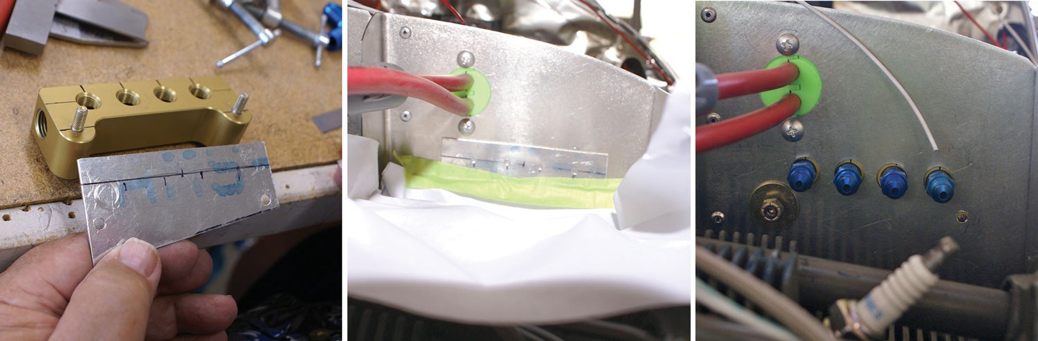

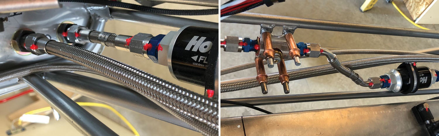

There is a lot to our fuel system that is unique and vastly different than standard. It was time to dig into the installation of the SDS fuel injection system. (See “Going to the Source” below.) Mike mocked-up the high-pressure fuel lines that would be custom-made for us by Tom Swearengen at TS Flightlines. It was essential to get this right since the lines had to be the correct lengths—and those with other than straight end fittings had to be properly clocked. Soon enough, we had the lines in place and all looked good save for one small problem: The fuel block (fuel distribution to all the cylinders) mounted on top of the engine seemed to be too high for the cowl to fit. Mike had “pre-considered” this as a possible problem, but seeing the result confirmed that it was just too high. Mike was made aware that there is another mounting option for the fuel block on the backside of the engine baffling. Steve at Aircraft Specialties, who is also a partner with Tom at TS Flightlines, contacted Mike after seeing his concerns on the internet and offered to remake the fuel lines to accommodate this change. It just so happens that Steve is building an S-21 himself and is interested in having the exact measurements for his plane and potential customers.
21 FUEL INJ LINES too long
Fun with hoses. This one (left) is too long; time to redo it. These are the engine fuel supply and return lines (right), rendered in integral firesleeve by TS Flightlines hoses. The 90° angles are mandrel bent and beautiful.
Mike and I discussed the change in a heart-to-heart. It is such a bummer to think you are over one section of the build to find out that something is not up to what you want or is plain old not right. It requires resources and time to redo, and I really hate to redo
anything. But now was the time to have it done right, so we decided that the rear mount was the only way to go.
30 TOP MOUNTED FUEL BLOCK 3
The fuel-distribution block originally was going to live on the engine spine (left) but that hit the cowling. Now it’s behind the fixed baffle (right). Much better!
Mike and Steve discussed the plan of attack, so we proceeded down that path. We got the rear-mounted fuel block ordered from SDS and had it in hand within about a week so we could go through all the line mock-ups and measurements once again. Time passed, a bit of back and forth with communications, and we finally had the lines to the correct specs! (See “Around the Block,” below.) There is an upside to our trials. The final product is so clean with it mounted on the rear of the baffling! I am super relieved that we decided to put in the time and effort to redo our work to have the system the way that we want it and have it fit so nicely!
41 FUEL INJ LINES final
With the fuel distribution block moved behind the fixed baffle plate, the entire top end of the engine seems a lot cleaner and better organized.
