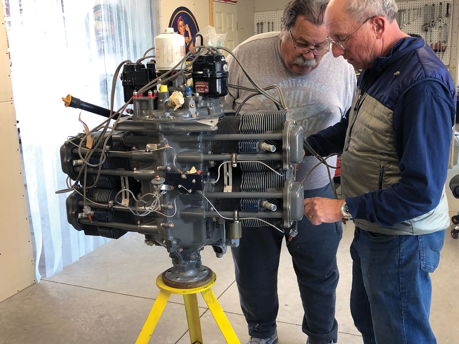

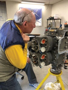

It was time to give the engine a brief once-over with our neighbor friend, Paul Dye (you may have heard of him), who happens to have been through the Lycoming engine school and has all the right tools for the job. Paul is loaded with the knowledge and expertise to assist us through this process. Mike, Paul and I wheeled the engine into the workshop, lifted it with a “cherry-picker” (engine hoist) and attached an engine stand to the prop hub.
My first impression was how dusty it was! Although being covered, it was, after all, not a new engine—and before opening it up at all, I wanted it to be clean. That’s the best way to keep dirt from getting inside the engine. Mike and Paul quickly looked around the engine for anything that looked unusual or was a “show-stopper,” but all looked good on a cursory review of the engine’s exterior. Paul gave me some helpful tips on areas that needed to be plugged and taped over so I could proceed with cleaning the engine.

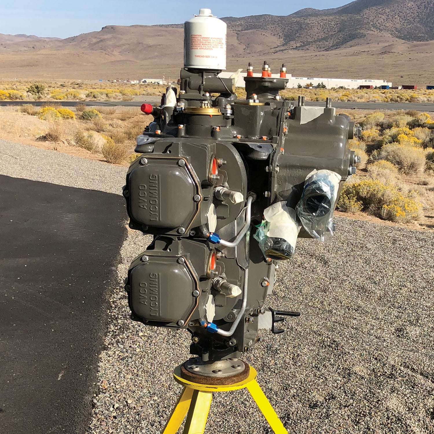

Mike and I got the engine prepped for cleaning and wheeled out onto the asphalt apron behind the hangar for its first bath in many years. Mike, with all his cool tools, just happens to have a siphon gun that uses air pressure and mineral spirits as a pressure washer—that turned out to be perfect for the job. Oh my, it worked so well and it looked so much better after I was able to get in there with a toothbrush and get it down to the details of being cleaned up! Now I could finally see some hope that all would be OK.

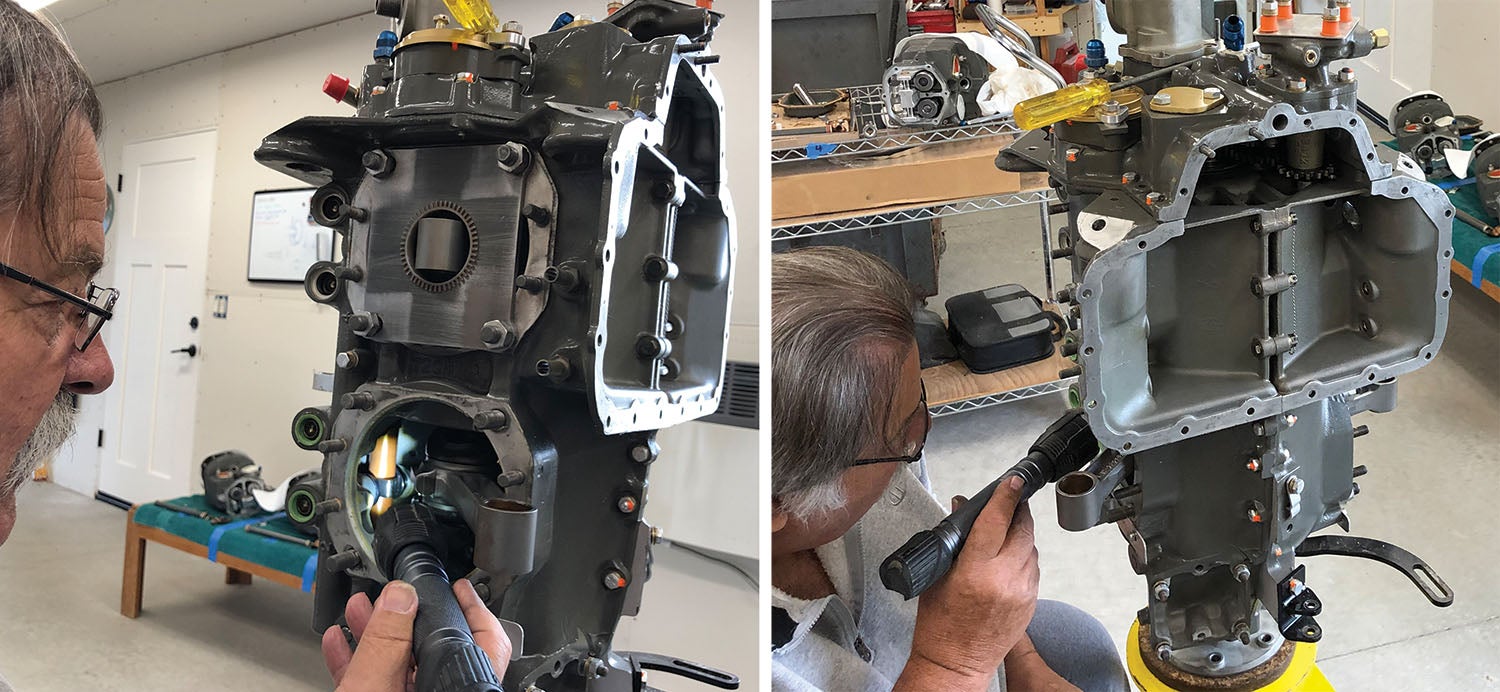

After a few days of drying out, it was time for us to begin the teardown. Paul was like a surgeon getting ready for a major operation and had the plan in his head about how we were to proceed and assist in the process. I was the “surgical nurse” setting up the table covered in a towel and labeled 1,2,3 and 4 with taped separations and an IN and OUT for each cylinder. I was ready to be handed pieces and parts to put them in the directed areas. Mike was his surgical assistant, prepared to assist in the “operation” as necessary. I have never seen an engine apart before, so this was a new and exciting experience. Mike goes further into this; see “The Unpickling,” below.
I was handed so many pieces and parts and just did as I was told, trying as hard as I could to pay attention to what Mike and Paul were doing and learning the names of the parts—so that when I was asked in the near future to hand them back, I would do so appropriately. It was so cool being a witness to this process. Talk about an education! It is one thing to read about how an engine works, but I have a much better appreciation for how many moving parts there are. I was so relieved that when they got to the point of the teardown that was “far enough” to inspect it, they were both satisfied that there was no corrosion and the engine “looked clean.” It was time to put Humpty Dumpty back together again. This was cause for celebration!

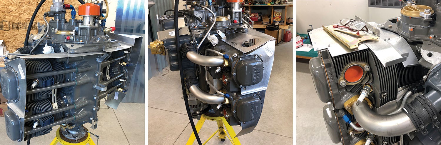

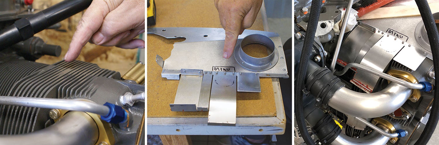

It was now time to prep the engine for hanging. One major act of construction that I somewhat remember from the RV-10 build was Mike spending much time on the airflow to the engine, assuring that the engine has what it needs, where it needs it, for proper cooling. And even though the IO-320 is dimensionally very similar to the Titan IO-340, there are differences in the baffling, so using baffles for the 340 would work for some but not all of the areas. Of course, since the engine was now clean and offered with Paul and Mike’s blessings, it was time to work on some of that baffling before we hung the engine. Again, see Mike’s thoughts on this: “Baffled,” Page 50.
