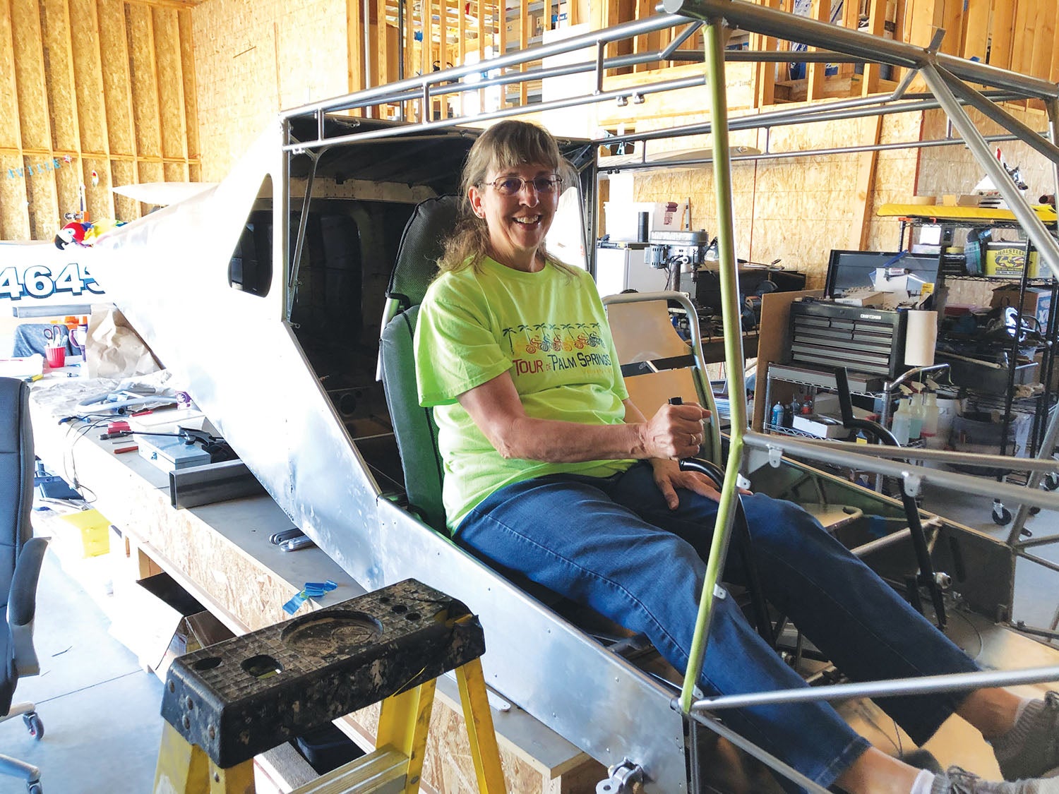

11 Laura Test fit right seat
Laura gets to test fit the seat, finding that the control stick is at a nice height. This RANS is finally at the point that airplane noises can be made!

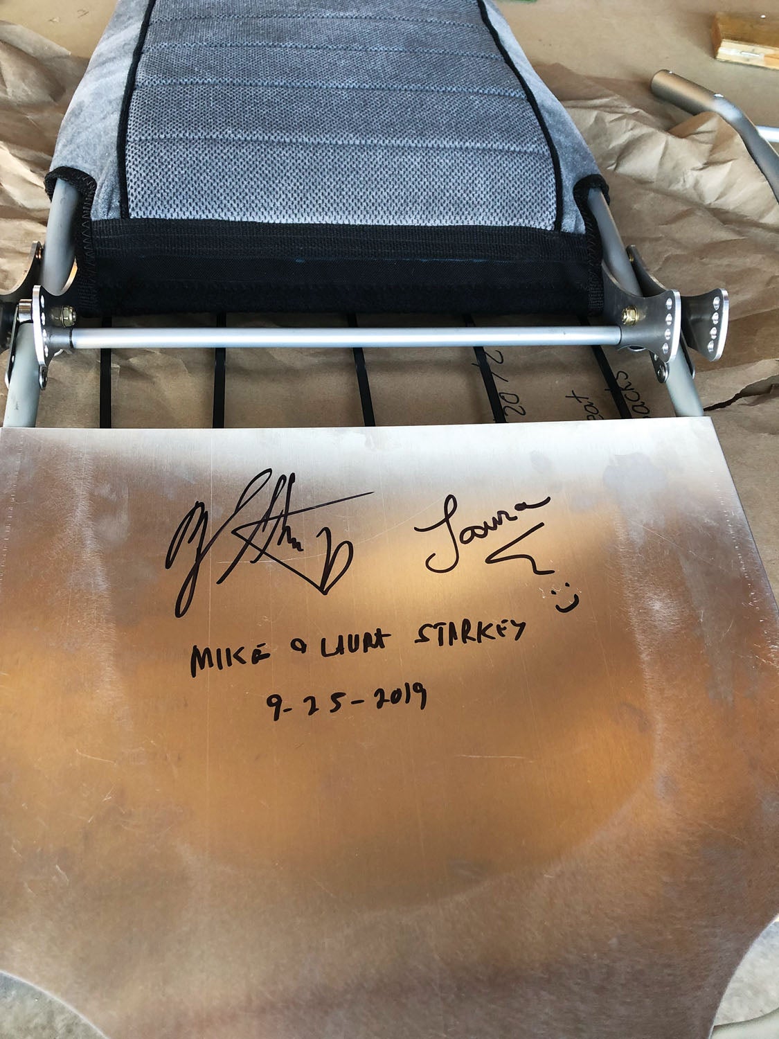

The official signing of the underside of the pilot’s seat to commemorate the build.

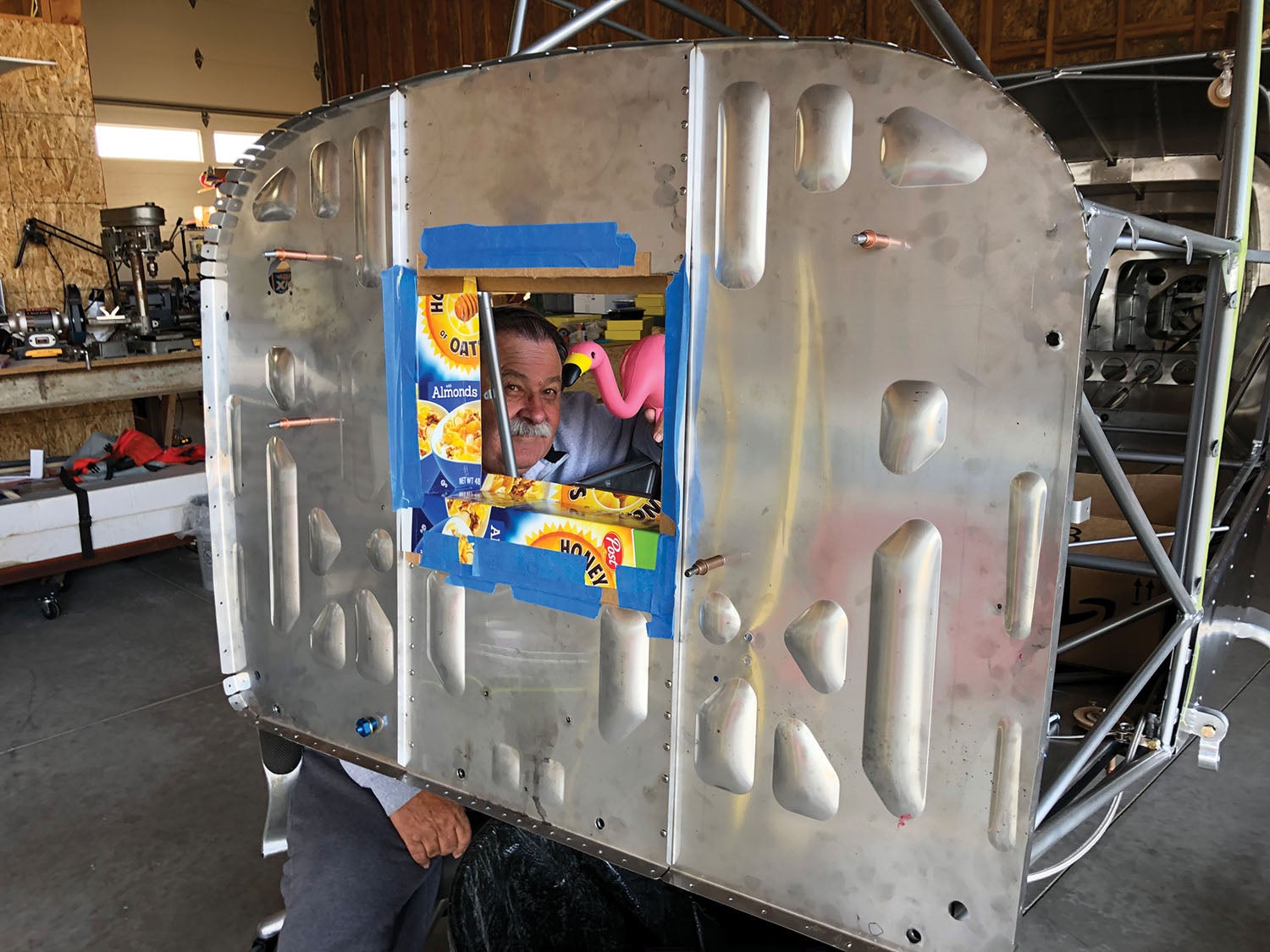

Who’s in the doghouse, now? Mike and his flamingo showing the cereal-carton pattern made for the doghouse needed to make room for the hydraulic prop governor.

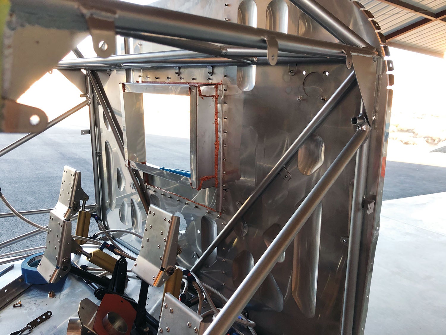

One of the needed modifications involved the firewall to accommodate the prop governor, which is on the aft side of the engine. A governor? Yes, we decided to go with a constant-speed prop. Of course, the governor sticks out in such a way that a hole needed to be cut in the firewall to create the space needed. Since this space is in an area that is a few inches deep and not in the way of any other structure, it is apparently a somewhat common practice to build a “doghouse” into the firewall to accommodate the space needed for the governor. At the moment, I was extremely uncomfortable with this concept! You have a firewall. It is called that for a reason. It protects the people behind it if there is ever an engine fire. Why would you want to cut holes in that or modify it in any way? At the time, I felt like this was a perfectly good question to be asking.
20 doghouse inside view
The final version of the recess as seen from the inside.
Once again, reassurance from other neighbor builders that this is not an uncommon practice. Stainless steel, like the firewall, is used to build the doghouse and any “holes” in the firewall are reinforced with a fire-retardant silicone sealant called Fire Barrier 2000, which is made for high temperatures.
Because there were no plans for this doghouse, Mike made a pattern for the stainless steel pieces out of a cereal box. The exact location and measurements were borrowed from another S-21 builder off the RANS builder Facebook site. (Another reason a vital builder community is so helpful.) As I later learned, there are a lot of things that get attached to the firewall and holes to be punched in it to accommodate wiring and hoses. I was less stressed about cutting holes, including one big one, once I realized that this was “normal.”

On the RANS, the front side of the firewall gets the Fiberfrax thermal blanket (left). Laura took on the job of building the filtered airbox (right), itself modified from the kit original because of the IO-320’s configuration.

We weren’t close to done on the firewall, and that was good, because Mike took the opportunity to add a layer of insulation on the engine side of the firewall—to reduce heat coming into the cabin and noise. He cut pieces of a material called Fiberfrax, which is a ceramic insulation blanket, and then cut pieces of stainless steel foil (0.003-inch thick) large enough to capture the Fiberfrax blanket, then covered the forward side of the firewall with these pieces. This Fiberfrax stuff is pretty amazing in that you can cover your hand with it and put a blow torch to it and your hand won’t even get warm. Mike demonstrated this, but I’m not trying it!

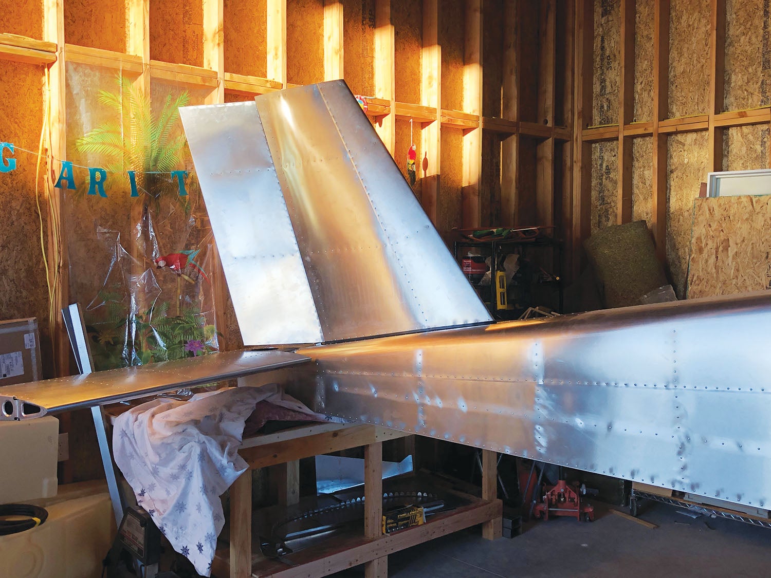

Sequences are important. An early read of the manual suggested the vertical stabilizer should go on first (left) but a more current iteration says the horizontal stab needs to be installed first (right). Ask us how we know…
Tales of the Tail

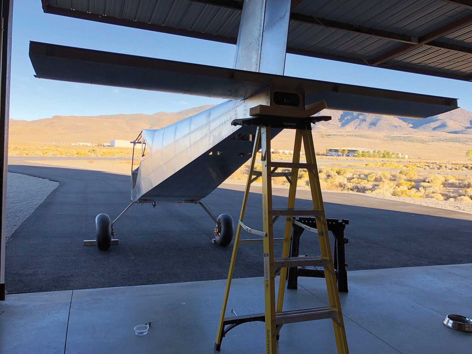

26 tail assembled 2
The easiest way to reach the area to attach the nuts, bolts and washers for the tail attachment required us to prop the tail up on a ladder for better access.
Now it was time to get the tail pieces on. Unknowingly, we were working from an older version of the builder manual. Both Mike and I had read through it and came to the same understanding that we were to mount the vertical stabilizer first, then the horizontal stabilizer and finally the rudder. Through much anguish we were able to get the vertical stab on. It is the perfect case for tiny hands and dexterity, thus I had the brunt of the work getting the nuts and bolts lined up and tightened down in this space that is nearly impossible to get to. What a bugger!
27 Tail assembled
Finally the vertical with the rudder attached was mounted into the horizontal stabilizer.
The horizontal stab was not as difficult to get attached, but then we discovered that the rudder could not be attached. What went wrong? I was super frustrated and we called it a day. Sometimes you just need to sleep on it to figure things out.
Mike got to poking around on the computer and discovered that the “revised” version of the manual was a bit more clear, stating that “the rudder must be installed onto the vertical stabilizer before the assembly is installed and that the horizontal stabilizer needs to be installed first as it will not clear the rudder.” Another ugh. It was totally “our bad,” but take this as a helpful hint to all builders: Make sure you are working off the most recent version of the manual to save yourself time and frustration.
