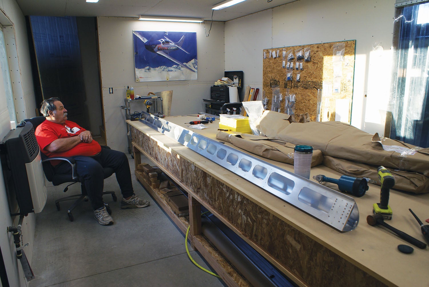

Part of forming the right builder mindset involves thinking ahead and making sure you have what you need when you will need it—nothing wastes time like a mad dash to find a part or a tool. During our down time, Mike likes to have what I call his “cogitation time,” where he just looks off into the distance and thinks  about the build. (At least that’s what I think he’s thinking about!)

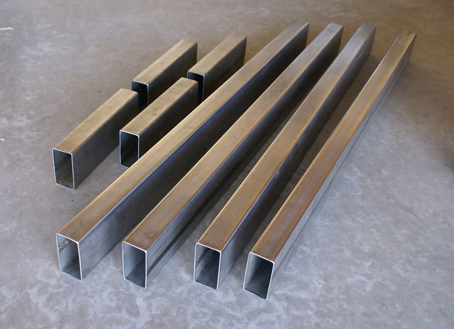

In between the tail components and the wing we were about to start on, Mike was considering the size of the pieces we’d be working on and thought about the support pieces and work tables. He concluded, “Let’s use some steel construction beams rather than wooden 2x4s.” This would give us a solid foundation to work from rather than relying on wooden 2x4s—in Nevada they have a tendency to dry and twist, which defeats the purpose.
02 Steel 2 x 4s
The beloved steel beams that come highly recommended if you want to build without twists—wood is good but metal is better.
We sourced rectangular steel 2x4s from a local supplier and took a day off from building to run into Reno and pick up a 20-foot piece of 2×4 steel that the supplier cut into two 10-foot pieces, thanks very much, and brought them home, where Mike further cut them into four 4-foot and four 1-foot pieces. These steel fixtures would prove to be essential to building parts without twist. I wish we had these from the get-go!
Another product of Mike’s cogitation time was this question: “What do we do with this wing after it is done?” The answer: We’re going to need a wing cradle to store them in. Turns out, we have a friend who lives about 30 miles away and who just completed a RANS S-20 Raven. Mike decided to see if he still had his wing cradle and, sure enough, we got lucky. Not only did he still have it, but he was willing to deliver it and let us use it with the understanding that we would pass it along to another builder in the future. What a deal, and further proof that airplane builders are the best. He brought it up to us the next day in pieces and parts, showed Mike how it went together, then we gave him a little tour of our S-21 build.

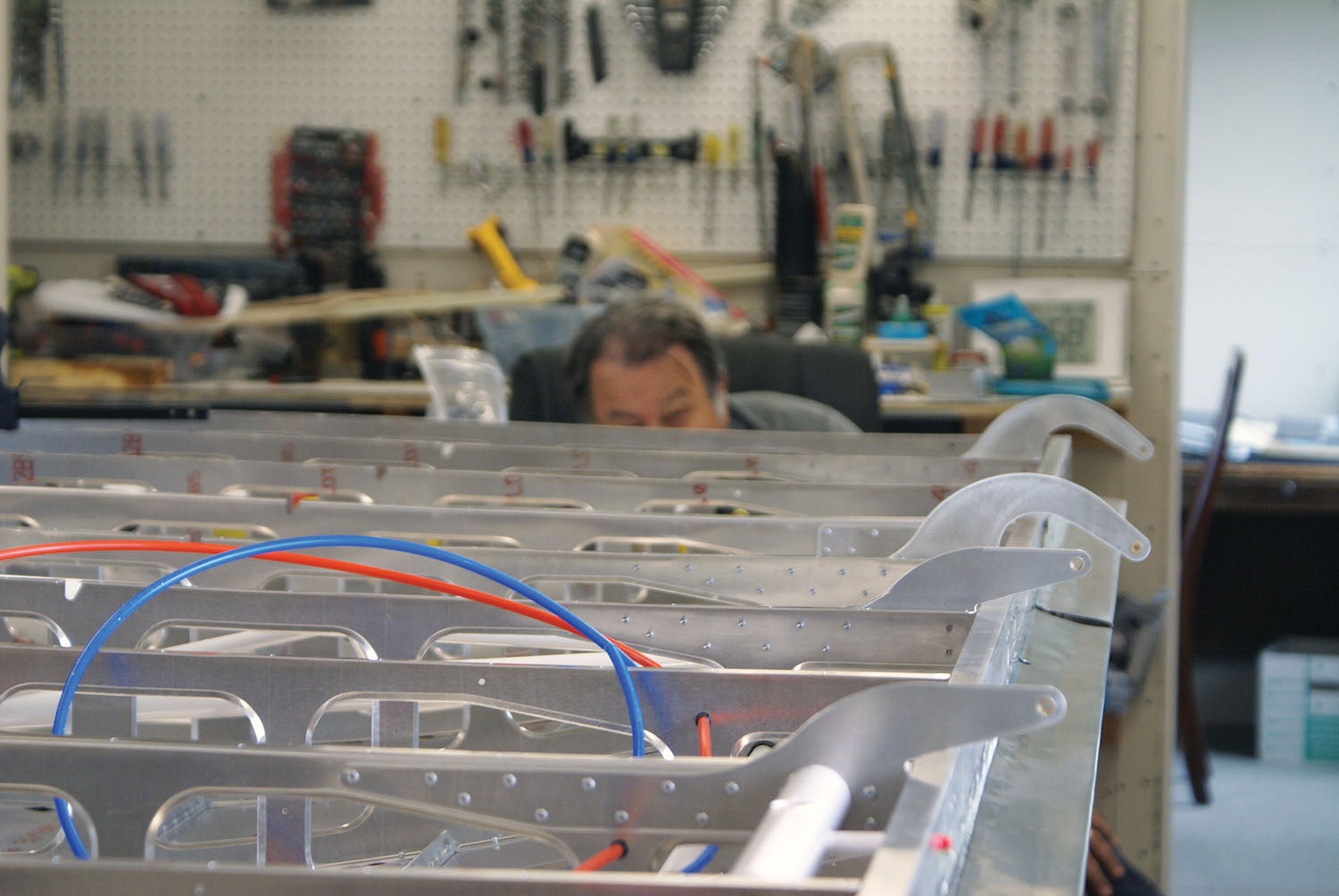

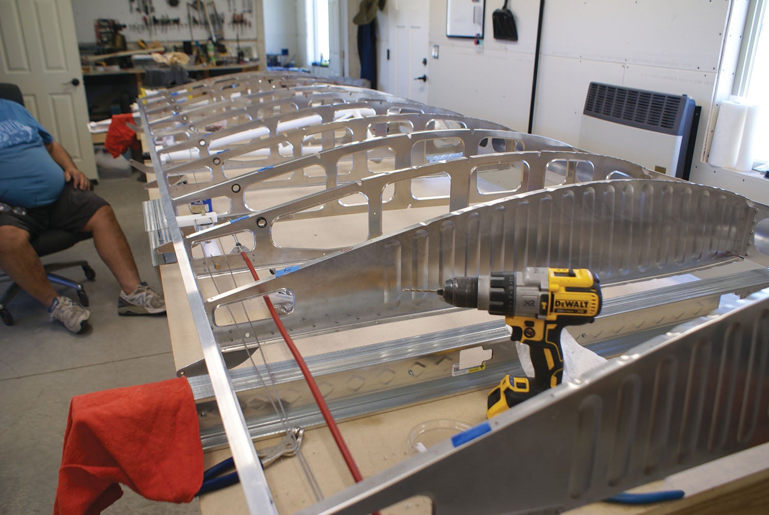

04 Ribs attached to front aft spars
More progress…the wing skeleton with spar/leading edge comes together. You can see the truss spanning the front and rear spars.

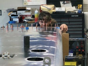

We got going with the left front and rear spars and doublers, and the correct orientation of the pieces. Because there are different rivets used throughout the wing, you have to pay close attention to which rivet is being used where. The manuals are useful to assist in the layout and orientation. But, still, I had to learn how to look at the diagrams in the parts manual to read them properly to know this information. It was pretty straightforward (most of the time)… just takes some getting used to.
During mating of the strut truss to the front spar, I had my first experience of where my “tiny hands” were quite useful. I had to literally stick my hand and forearm into the front spar to get the nuts screwed onto the bolts for the lift-strut assembly. It was a tight fit for me and there’s no way Mike would have gotten his arm in there. Advantage, me.

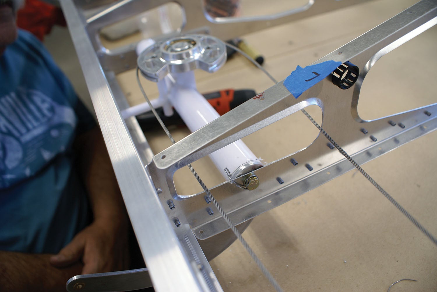

05 Aileron bellcrank attached
The aileron bellcrank shown fully assembled with cable and saftey wired in place.
When it came time to get the ribs prepped, we had a good system of me working on cleanup—ensuring the inventory stickers had been removed, the skins cleaned and any sharp edges deburred—and while I did that, Mike was working on the aileron and flap bellcrank assemblies and flattening the ribs with the fluting pliers. It all needs to be done, it just takes time. It was interesting getting the correct rib in the right place because the flanges were pointing right and left and the order was not exactly logical, so it was easier for me to lay the ribs out in the proper order and number them to keep their locations straight.

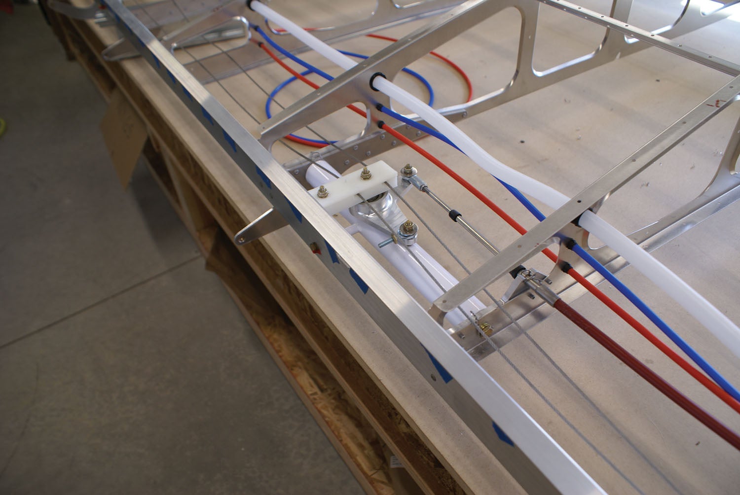

06 Flap teleflex installed to bellcrank
Here you can see the cabling for the ailerons and flap Teleflex fitting into the aft area of the wing through the ribs.

The aft area of the ribs were drilled to accomdate the tube for the wiring (white) and the pitot tube with AOA plumbing (red and blue).

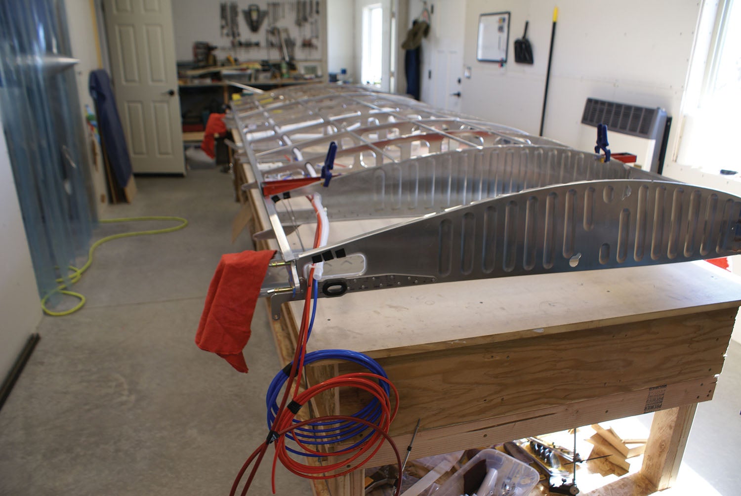

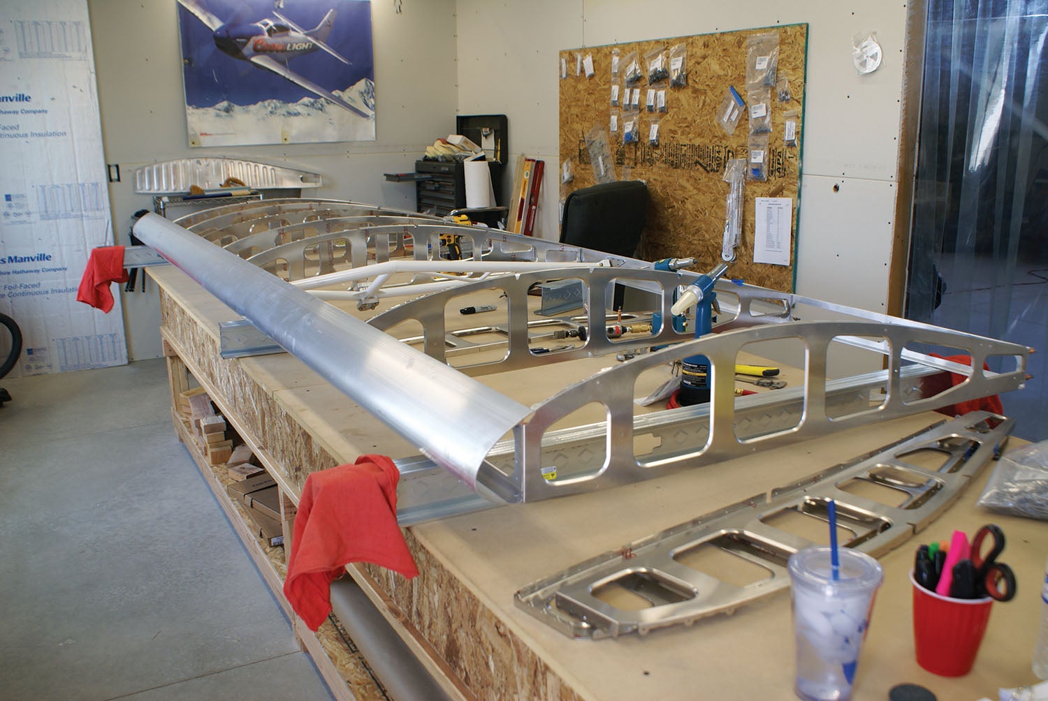

After getting the basic frame of the wing constructed, front and aft spar with truss attached, ribs going the correct direction and riveted, construction for the inner workings could begin. To have lighting at the wingtip and wires for the ADS-B out, Mike drilled a hole through the aft portion of the ribs, lined the holes with snap bushings to protect the tube from the edge of the rib and  inserted a tube for the wiring that we would install later. Two tubes for the pitot system were placed through holes drilled into the rib and protected with snap bushings also. Bellcranks for the flaps and ailerons were mounted, along with the cable for the aileron and Teleflex cable for the flap, and then all were safety wired in place.
08 Wiring tube and pitot tube hoses
As the wing really comes together, its size and heft become apparent. This is a big beast!
It was time to step back and check that all the inner workings of the wing were in place. We went through the pre-skin checklist to make sure that the all was in place—and it was. It makes a lot of sense that they include this checklist in the manual because once the skin is on this huge wing, you really don’t want to get back in there. Even though there are access panels, it’s so much easier to make changes and refinements with the wing open. So, our advice is don’t rush. There’s no massive hurry to close the wing.

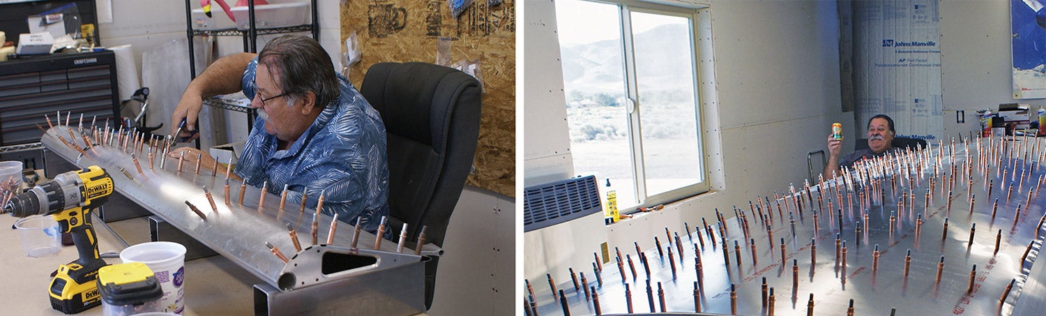

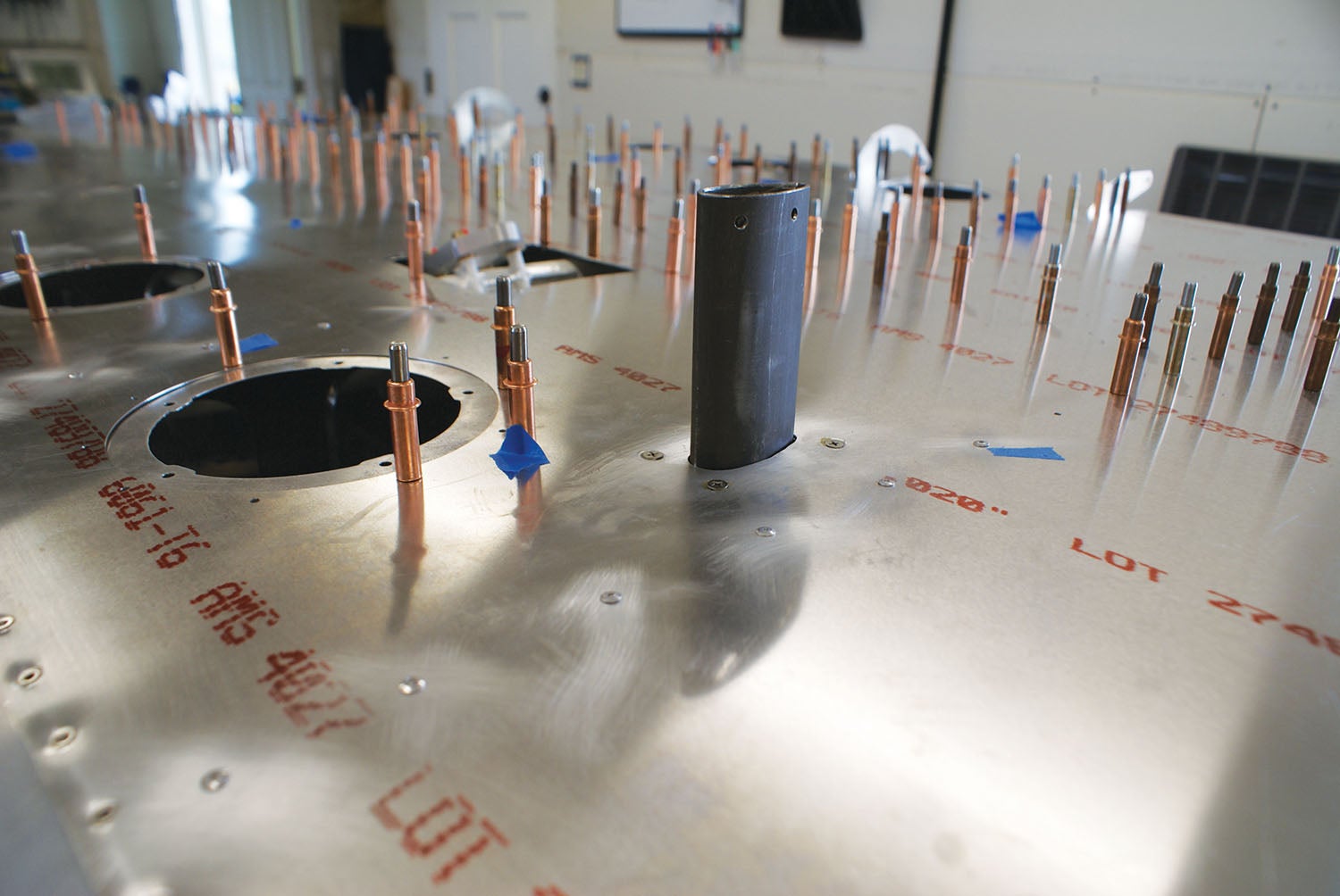

09 Dimpling leading edge skin
After using the edge forming tool on the skin, then transfer drilling the rivet holes into the leading edge, it is time to do the dimpling .

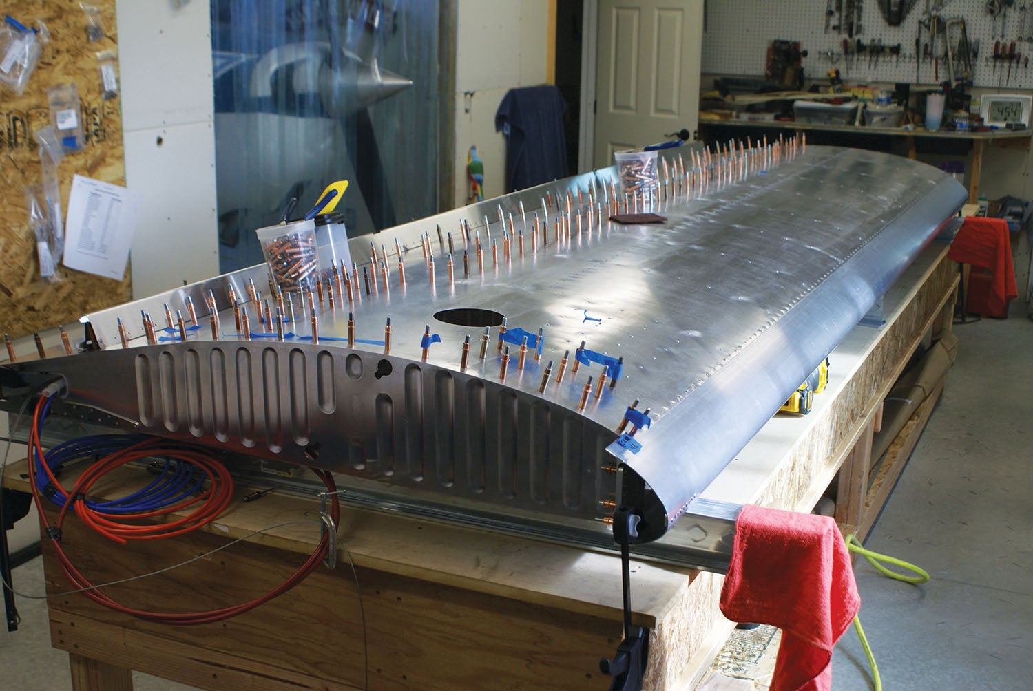

Still, that time comes—skinning the top side of the wing! In prepping, we secured all the cables and tubes coming out of the root of the wing and got the stringers in place. The stringers go parallel to the span to support the wing structure. Since this is a giant sheet of aluminum that you really don’t want bent, here was another job that required the assistance of neighbors. Did I mention that aircraft-building neighbors are the best?
Once the skin was placed on the wing, we had to fuss around with the strut truss and leveling to get the alignment flat and without any twisting. This is a large piece to be working with. It was pretty mind boggling to me, but at the same time really fun seeing it come together. There were a few new tools used during this part of the build that I can understand the need for. For example, you want to have a smooth leading edge to reduce drag, so the skin that overlaps the leading edge­—which is really the main spar in this design—needs to be slightly bent over with an edge-forming tool. Also, on the S-21, the main skin-to-leading edge mate receives flush rivets. The use of the edge-forming tool is a bit of an art that takes practice. We had a couple of spare pieces of aluminum we used for practice and that was really helpful. Better to mess up on scrap than your own wing skin.

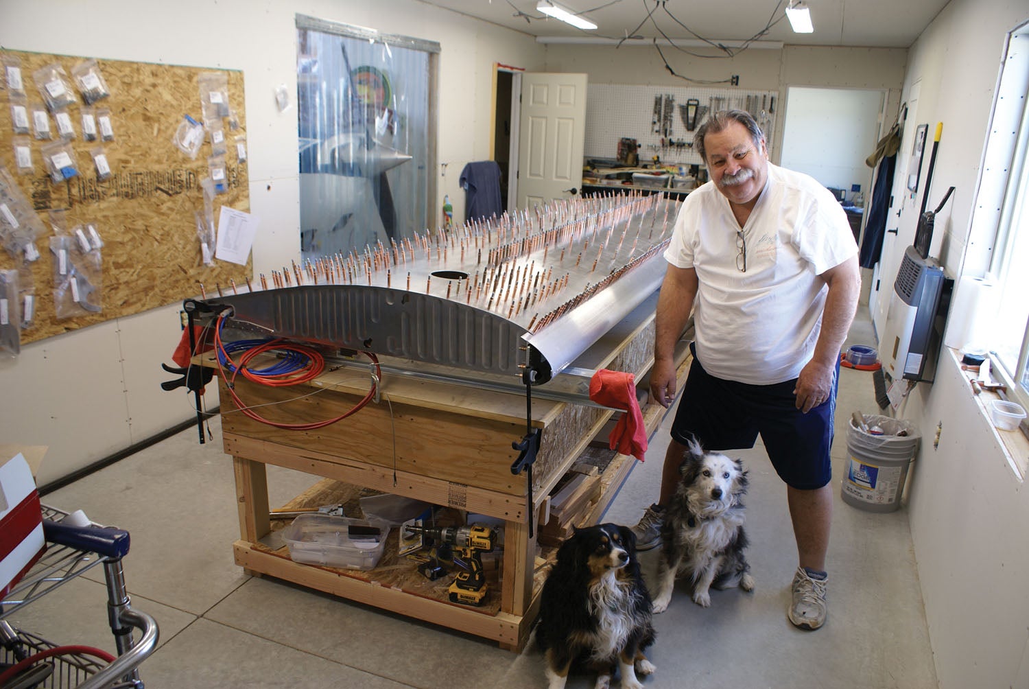

10 Fully clecoed

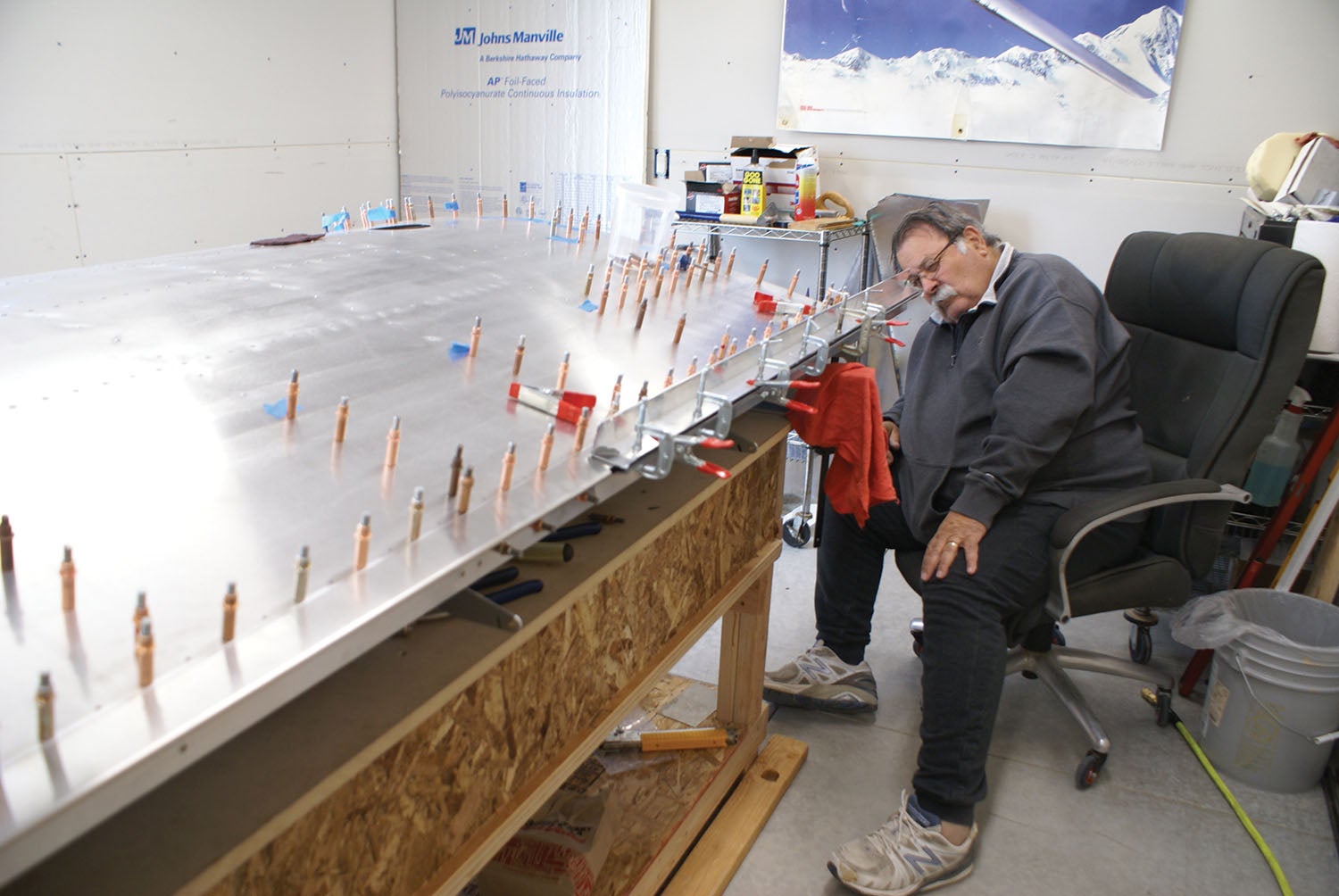

That’s one happy Mike and dogs with the fully Clecoed top skin ready for riveting .

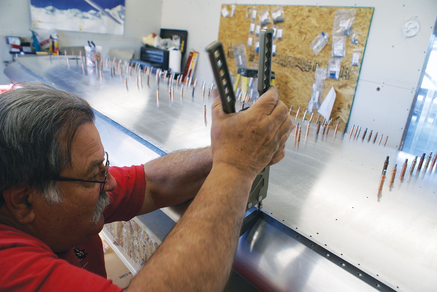

Flush riveting was something new for me on this project. Of course, it’s not just grabbing a different kind of rivet. Although we were using blind or pull rivets, the underlying concepts are the same as they are for driven rivets as typically used on RVs. We had to countersink the thicker metal of the spar and create a matching dimple in the thinner sheet over the top. It’s here you want to slow down and make sure your work is the best it can be. The big difference is in the last step, where the pulled rivet is secured from the outside, which is really a nice thing when you’re riveting round a tight radius or where access to the back side of the work is difficult.

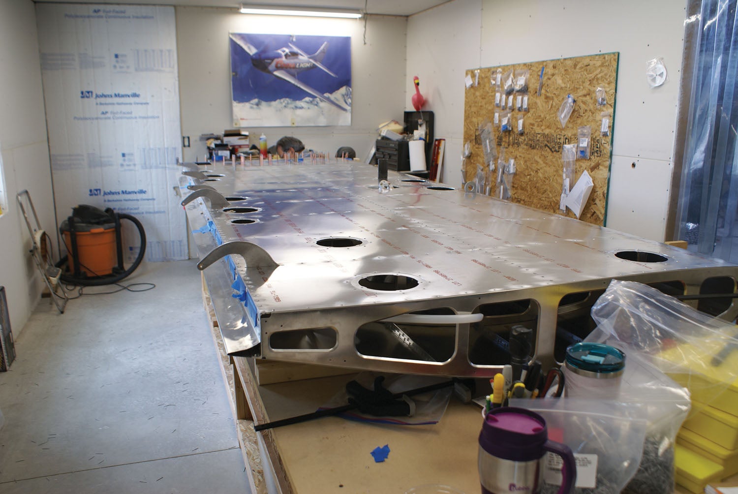

11 Riveting begins
Life moves fast with half of the top skin riveted. Notice areas not riveted yet still have work pending for fuel tank insertion and the gap seal on trailing edge.
It’s Tops!
Getting the entire top skin riveted was quite backbreaking and because there is so much surface area, it takes way more time than I was anticipating. I did all the riveting and Mike would call out if I had the rivet gun misaligned. I could tell when it was time to quit if I had too many rivets that were “proud,” as my neighbor Louise put it. There’s a simple gauge: If you can get your fingernail under the rivet, you need to drill it out and try again, I was told. There was one time I remember that I had three bad rivets out of about the last 10. I said to Mike, “three strikes, you’re out” and called it a day. I also have arthritis in my hands and was hurting from all the Clecoing and riveting, so you just have to know your own limitations and not continue pushing. The whole project will be there tomorrow.

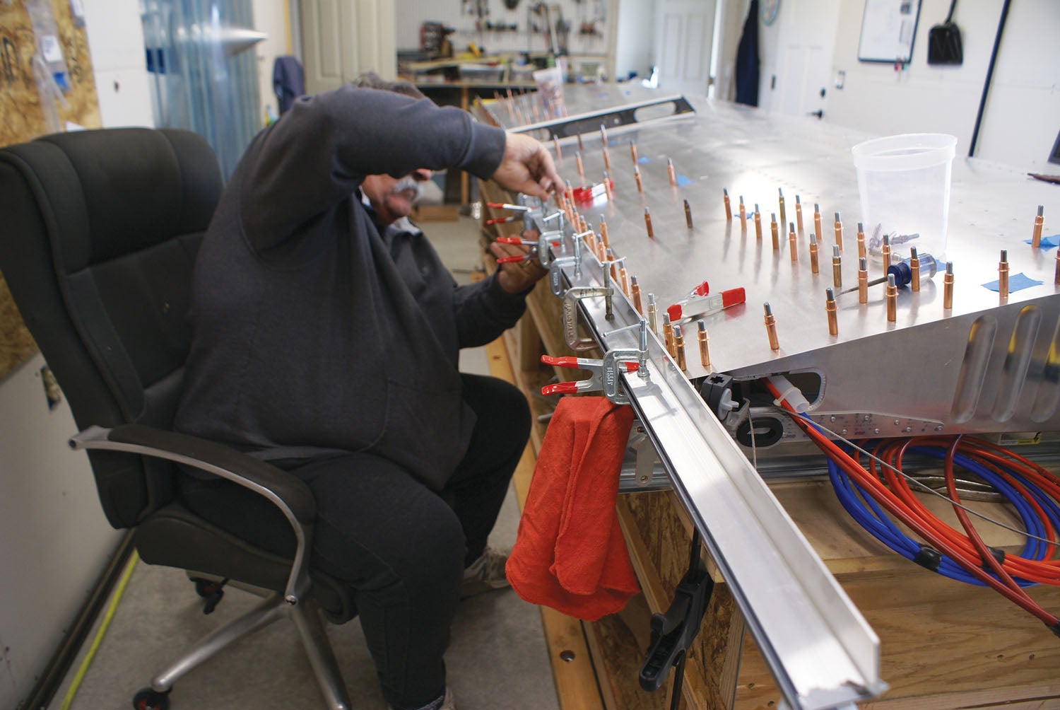

Before finalizing the top skin, there was one facet we needed to figure out: the “dreaded” gap seal. On the S-21 wing, there’s a roughly triangular piece that runs the length of the wing, spanwise, and closes the gap between the trailing edge of the upper skin and the flaps and ailerons. It needs to be flush to the wing and follow the upper skin’s contour. I frankly had never really noticed this part of a wing before, but so be it. It comes as a piece that is not bent to the final shape, so the builder needs to finalize it.

This was the most difficult part of the wing build. We attached it with Clecos and consulted our neighbor Paul, regarding what we thought the best approach was for us to bend this long flimsy piece of aluminum into the desired shape. The conclusion was to get two long pieces of angle aluminum, clamp one section of the three sections at a time with about eight to 10 clamps, squeeze it down a bit, unclamp them, check for the angle it had bent to and repeat as needed to achieve that flat wing-to-gap-seal surface. Of course, you had to go slowly to not overbend the metal.
13 Checking Gap Seal alignment
Clamping down the middle section of the gap seal, checking alignment by a good eyeballing estimate.

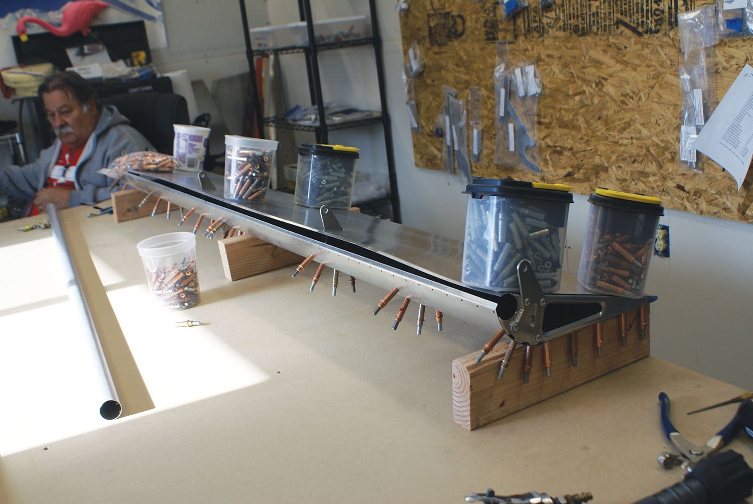

Oh, but you’re not done yet. While the top surface is flat, the lower surface of the gap seal has to be arched to allow aileron and flap movement. To get the correct curvature to the bottom side of the gap seal, Mike would take the rounded end of a screwdriver or a ball peen hammer, wax it up with beeswax and run it on the underside of the gap seal section while I pushed down on the topside with the angle aluminum. What guesswork! The end product was flat on the top, but pretty ugly on the underside of the gap seal. Not to worry. This part would be covered by the flap and aileron, so no one—but us—would know how ugly it was. It is my understanding that this part has been since redesigned by RANS.
15 Tightening down clamps on gap seal
The final gap seal segment squeeze involves preparation, consideration and patience. It’s funny how processes that seem difficult get easier as you go.

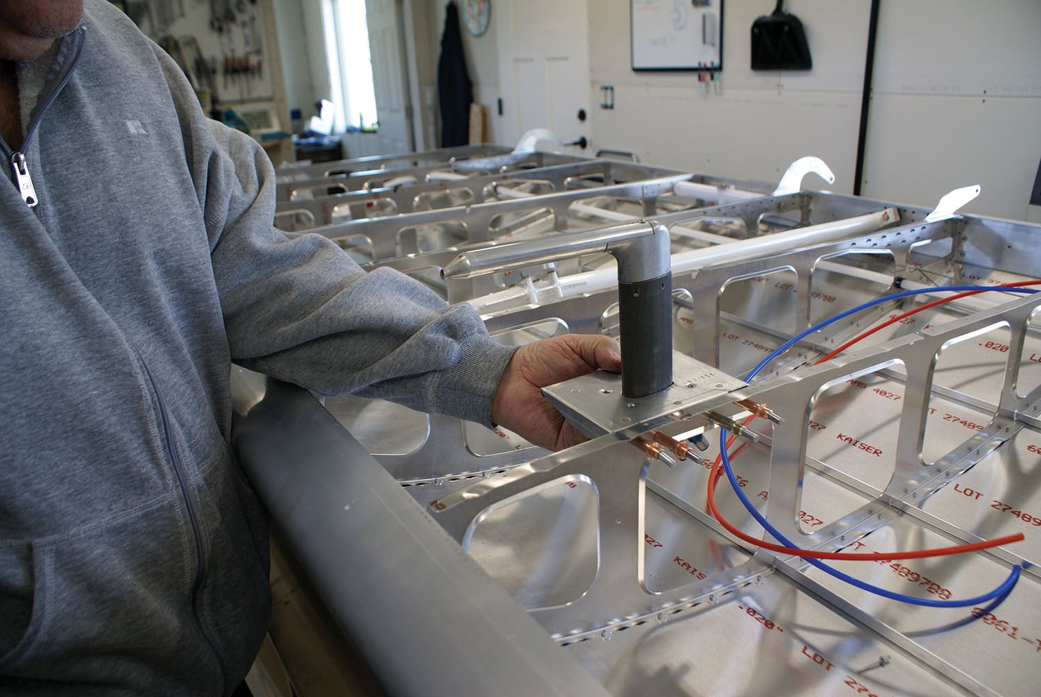

The main difference in the construction of the bottom skin for us is that Mike had decided he wanted a pitot system that included angle-of-attack capability, and that pitot head is a bit beefier than the standard issue from RANS. That, in turn, required a strengthening modification to stiffen the bottom skin and accommodate the mount. We also had to place it carefully to not interfere with anything else inside the wing. Once you deviate from the original design and plans, you’re on your own.
18 Pitot tube assembly will fit
We fabricated a mount for the pitot tube and checked the work before closing that part of the wing.
All this, of course, made me quite nervous cutting into the skin where there were no directions to follow. I just had to trust that Mike knows what he’s doing, even if that includes him figuring it out along the way! He sought out consultation on his design, once again with neighbors, and it ended up looking just like it should.
