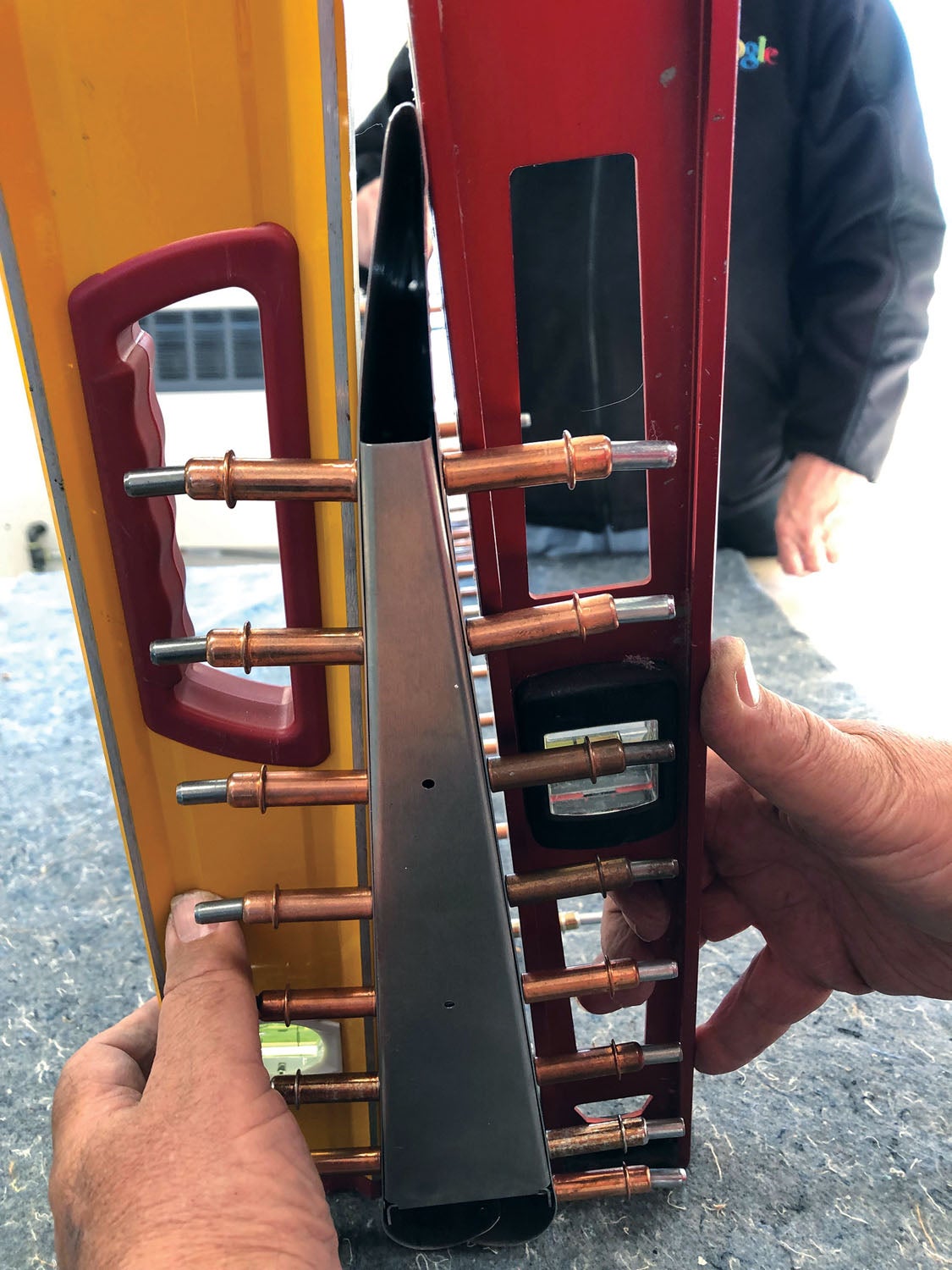

After Clecoing the rudder skin to the frame, Mike declared, “We have a problem.” With the levels on both sides of the rudder you can clearly see the offset trailing edge.

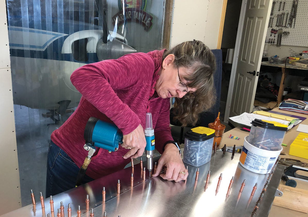

We started with the rudder frame assembly, where I got to pull my first rivet with the pneumatic gun. It was very exciting! (Remember that the S-21 is predominantly a pull-rivet airplane rather than using conventional driven rivets.) Like most metal aircraft, you start with the skeleton before you put on the skin, which seemed very logical for the nurse in me. Mike and I worked well together taking stickers off, deburring as needed and Clecoing the pieces together.
Clecoes are a builder’s best friend, as I was soon to learn. And it’s true that you almost can’t have too many of them. Because they’re durable, they’re a worthy investment in tools.
When we Clecoed the rudder skin to the assembled frame, however, Mike said, “We have a problem.” Not words I really wanted to hear! He held up the rudder and you could see a bend on the trailing edge. A neighbor, who happens to have been a designer by trade, was visiting at the time, and the three of us soon came to the conclusion that the rudder skin itself had been bent by the factory in the wrong place. The three of us documented the bend, and we called it a day, frustrated.

With the assistance of Barry, a designer neighbor friend, the Starkeys clearly documented the bend in a pencil drawing to relay to RANS the issue they were having with the rudder skin (left). Here’s a side view of the rudder skin that had been folded in the wrong place by the factory (right). Much to their credit, RANS was quick to send a replacement skin.
The Wrong Part?
That night I kept mulling the issue over. I remembered reading on a “RANS Clan” post, “If you think the part is wrong, check again because most likely you’re the one wrong.” The following day, Mike and I removed the Clecoes from the skin and verified that the holes did not match up properly, so there was definitely a problem with the part. It happened to be Sun ’n Fun week in Florida and the majority of the RANS staff was there. Mike called the factory and was able to talk to Eddie Gil, the builder we met when we toured the factory, and he said that they had a problem with some of the rudder skins not getting folded properly. He apologized and promised to get another in the mail to us. While it was frustrating to get started with a defective part, I was so happy that issue was resolved with the factory so easily! Kudos once again to the RANS folks for coming through!

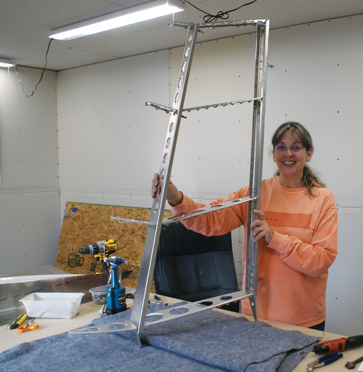

Laura’s happiness after fully riveting the vertical stabilizer skeleton together is in full view.

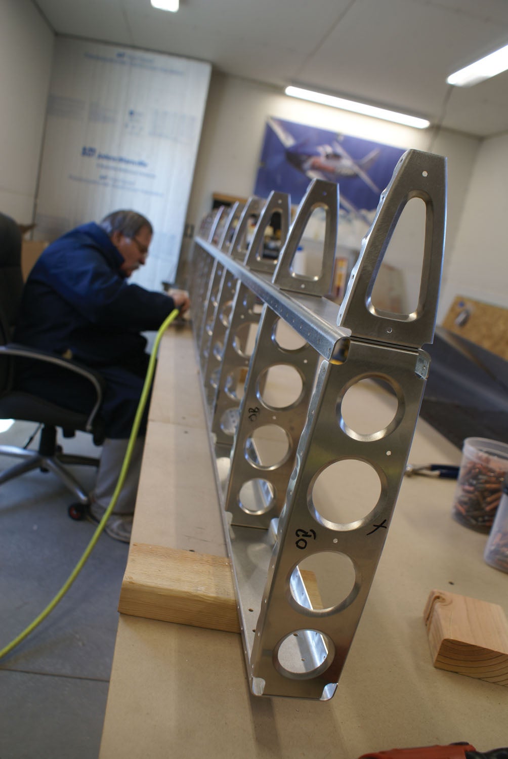

One very important part of the prep work to building is having a straight frame. Mike was magic with the fluting pliers, working carefully to get the ribs to lay flat. With the frame now riveted and level, it was time to get the skins on. Side skins were Clecoed onto the frame and transfer-drilled to the spar with the holes on the leading edge skin as the guide for drilling. I inserted Clecoes as Mike drilled, and got both left and right side skins drilled and assembled. Leveling was checked several times and all looked good. We riveted the left-side skin and went to rivet the right side and noticed a great twist.
How could this have happened? I was mystified and confused. We checked for level several times along the way while we had it Clecoed together. But we didn’t pick up on the twist until after one side had been riveted. We had our builder neighbors, Paul and Louise, come over for a visit to discuss our situation. Immediately when Louise saw our work, she put her finger on a spot where the left skin was offset 1/8 inch from the leading-edge skin where the transfer drilling had taken place. I could not believe that such a tiny amount of offset could be causing this huge twist. But Paul and Louise pointed out that a tiny mismatch like that amplifies itself through the entire part and can cause this much of a twist. That was so hard for me to believe!

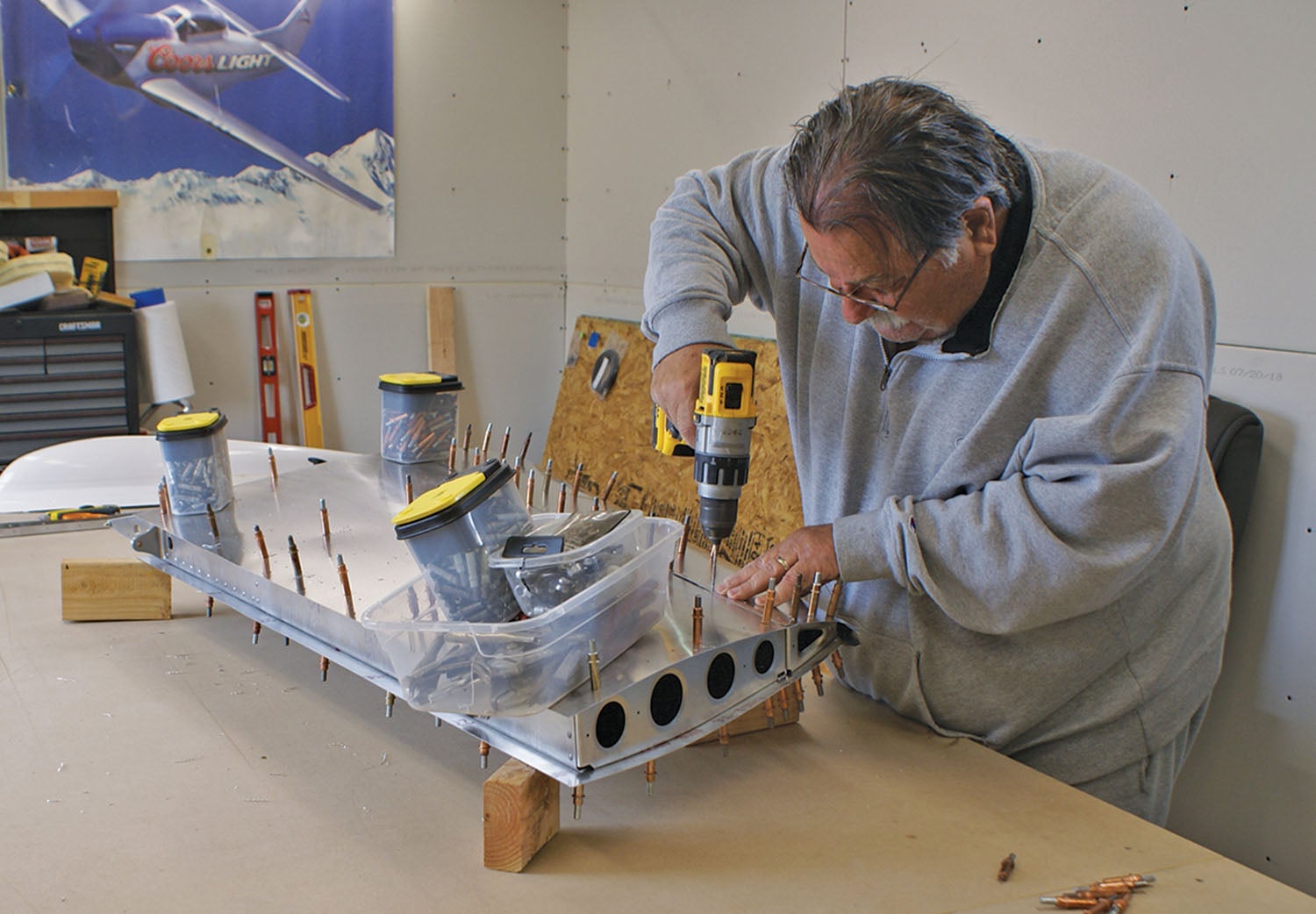

Here, Mike is diligently transfer-drilling the side skin to the spar, with the holes on the leading edge skin acting as the guide.

I had another night of dreaming about a twisted vertical stabilizer. I know it sounds crazy, but this stuff can really get to you. Since it was the weekend, we had time to think about our options. We could either see if we could repair the skin(s) or replace them. We had to do more analysis on it to try to exactly identify why it was off. Mike and I both came to the conclusion that we needed to remove the rivets from where the left side skin met up with the leading edge skin on the spar—where the transfer drilling had taken place—to see what would happened to the twist. When we removed the final rivet that was in the spar connecting the two skins, it seemed to have a lot of tension on it, and when it was drilled out the skins relaxed into place and met up, even as could be! It was flat and the right skin was fine. We had found the culprit—exactly as Louise had identified. The holes on the left side skin where it had been transfer-drilled to the spar were mismatched and we decided that replacing left skin was our option. We photographed our issue and sent it to RANS on Monday requesting a new stabilizer skin and more rivets.

The explanation was actually quite simple. Mike and I had been incorrect in the way we were checking for level. We did not fully understand the directions. The manual tells you to measure off a Cleco in the end rib, and that made no sense to us. Mike had been checking for level by measuring the height of the leading-edge skin instead, but had to estimate the exact center of the curved section.
We finally figured out what they meant! There are tiny holes in the web of each end rib for this purpose, but we thought they were talking about the rivet holes in the flange of the rib. Now we figured out that mystery!
Going forward, Mike used one of his cool tools, a Starrett machinist height gauge, that could pinpoint an exact height off the Cleco in the end rib to precisely check the part for straight and level. Paul also had a helpful hint that the best way to transfer-drill a piece of metal like this is to use a few Cleco clamps on the skins, start at one edge that is matched up and then drill from that end first. That way it sets the metal in the correct position and you can Cleco as you drill. Mike used Cleco clamps, but had started drilling in the middle of the piece. I noticed that it didn’t exactly match up when we were doing it, but didn’t think anything of it because it was “so close.”

Time to move on to the horizontal stabilizer with the assembly of the under-skin skeleton. Here, the ribs have been straightened, parts prepped and Clecoed together.

Another finishing step I learned is that I like to have smooth rivets—Any mandrels sticking out and sharp are not acceptable, so I marked any rivet that was sharp and sanded down the mandrel so the “final product” had no sharp edges. DNA samples from your own flesh are going to happen during the build, but try to minimize them if possible. Flip it, check for level and rivet the other side.
I learned early on that I loved to do the riveting because it gives me great satisfaction to pull a nice rivet! I even got to the point that one type of rivet became my favorite, because it was pretty, which made me wonder if, even at this early stage, I had already been doing it too long! We got the horizontal stabilizer done and what a great sense of satisfaction! It was level, no twisting and looked really nice! The feeling of satisfaction that comes with successfully completing a part had finally been established!
