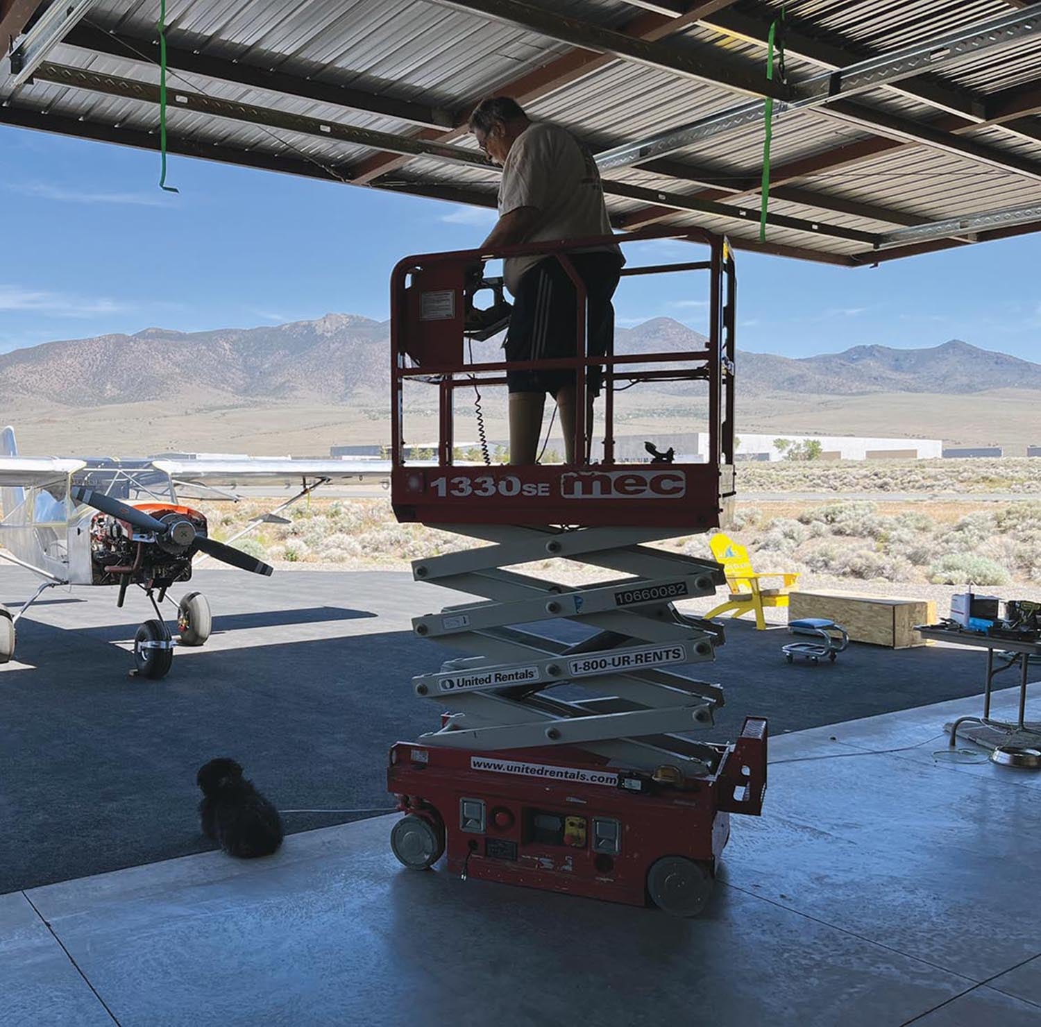

Nevertheless, Mike started on the paint booth with his usual resolve. He built a frame to hold an exhaust as well as frames to carry the filters. By the end of the day, Mike had one beam of the steel frame structure attached 90° to the west wall about 4 feet away from the left wingtip (to give John plenty of room to move around while painting) and suspended from the 16-foot rafters with a tie-down strap. All this work had been done by Mike on a ladder, which made me very nervous. Plus, he really didn’t like it too much; in fact he hated it. After a neighbor who was rumored to have a scissor lift didn’t actually, I was able to find one for rent locally for a very reasonable amount of money. Mike was delighted­­—a new tool!

Once the scissor lift relieved Mike of the ladder work, things started to come together nicely for the floating ceiling to support the paint booth (left). Mike’s amazing progress on the structure to hold the Visqueen up and create the booth (right).

Harold assisting with the aileron removal as Mike has the best view in the house (left). No, he’s not napping. Harold’s final two-fisted technique for scuffing comes to the tail end (right). A well-scuffed surface provides the best chance for primer adhesion.
