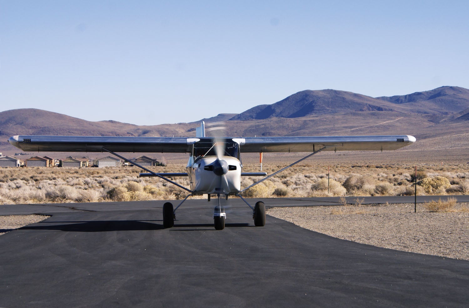

Ten hours into our Phase I flight testing, it’s finally time for me to fly our RANS S-21 Outbound. Mike and I had agreed that we’d let the RANS get 10 hours into Phase I and find solutions to several small problems before I flew it.
We had sold our Cessna 172 in February 2020, which was about the time the RANS needed to move into the big hangar, displacing the Cessna. During this time of transition, when we didn’t have a flying plane of our own, my neighbor and CFI, Jere Marble, allowed me to rent his Piper Cherokee to remain current. I also had several neighbor friends who took me up in their planes to assist in keeping my “head in the game” of flying during the interim. Many builders forget to stay current while building.
My concerns about learning our S-21 centered on the glass panel—I’d always had round gauges to fly by—a stick instead of a yoke and the constant-speed prop. The glass-panel concerns were severalfold in that I needed to know at a glance where to gather my information for flight. Also, I had never used ADS-B when flying, only looking out the window for traffic. I knew that this would take time to get used to and I just had to be confident enough in my skills as a pilot to keep from fixating on the screens.

Finally, on December 3, 2021, I got my first chance to pilot our RANS with Paul in the right seat. There was a great mix of emotions—anxiety, excitement, anticipation, fear. I had it all, but was ready to settle in, focus and do this! The plan Paul and I had discussed was to do Test Card #2 and get me comfortable with the avionics.
The Real Deal
On my first pre-solo flight, we took off way faster than I was used to. I was amazed at the short ground roll, even with the two of us in the airplane. When we got to altitude, Paul had me practice slow flight at 70 mph by holding altitude and then accelerating back to maneuvering speed. We then did some steep turns and a few stalls (buffet, mush controls, no real drop-out at 49 mph) that showed the S-21 regained flying speed rapidly by dropping the nose. We also did a simulated landing in the sky to get the feel prior to the real landing. During this time, I was getting used to seeing other traffic on the GRT displays and had begun to learn where to find the altitude and airspeed information, among other things. It was all coming together.
After about 45 minutes of flight, Paul was comfortable with my progress but wanted me to practice some landings prior to letting me loose. We did a few at the home airport, and I was happy to see that the S-21 was stable and confidence inspiring. Even better, it felt much like the factory’s S-21 that I trained in with RANS founder Randy Schlitter. No big surprises. With a few more landings completed, Paul gave me the thumbs-up to fly solo and suggested that I go out that afternoon after having some lunch.
And Now Solo!
Finally, it was time to fly the plane by myself. I took Paul up on his suggestion to roll the plane out on the runway far enough to make sure the nosewheel is pointed in the right direction, come to a complete stop, hold the brakes, apply full throttle and go. It worked great and I was off in less than 500 feet. Here I was at last in the plane, alone and flying. I planned to just review the maneuvers that we had done that morning and that was exactly what I did. Once again, no surprises and it felt really solid in flight. The panel was still a bit overwhelming for me, with way more information than I am used to looking at!

Mike took the plane out for a jaunt to Hawthorne (about a two-hour round-trip flight but still within our Phase I test area) with the excuse to go get some cheap fuel and test the autopilot some more. When coming in for a landing, he did a go-around that I thought was a bit suspicious because he was lined up just fine.
Turned out that when he landed and rolled up the ramp at home, the hours on the plane were exactly 40.0!
We finally got to use that Phase I completion sticker that our DAR had preprinted for us, pasting it into the aircraft logbook and writing these words: “I certify that the prescribed flight test hours have been completed and…” Well, you probably know the rest. Still, what a wonderful feeling of completion and accomplishment!
Even so, we were not done: We removed the cowl and inspected the engine area for any signs of wear or anything unusual. We went ahead and readjusted the way the wiring was bundled on either side of the engine where the rough skin protecting some of the sensor wires was rubbing against some other wiring and showing some wear. Other than that, everything looked really good.
The following morning, we went out together to breakfast at our favorite little local airport breakfast spot in Minden, Nevada, to celebrate with a few friends from the airport. It was cool to finally be able to fly together in the plane. Mike flew over and I flew back.
