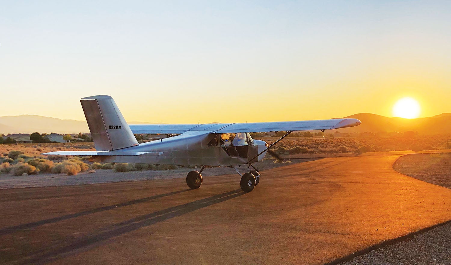

02 Morning of first flightIn our last installment of this build series, we had covered, through 12 installments, much of the building of our RANS S-21 Outbound as well as the logical culmination of all that work: first flight. Our neighbor, Paul Dye, committed the first three flights for us, which we documented int the KITPLANES® December 2021 issue. First flight, as every successful builder knows, is just the beginning of Phase I flight test.

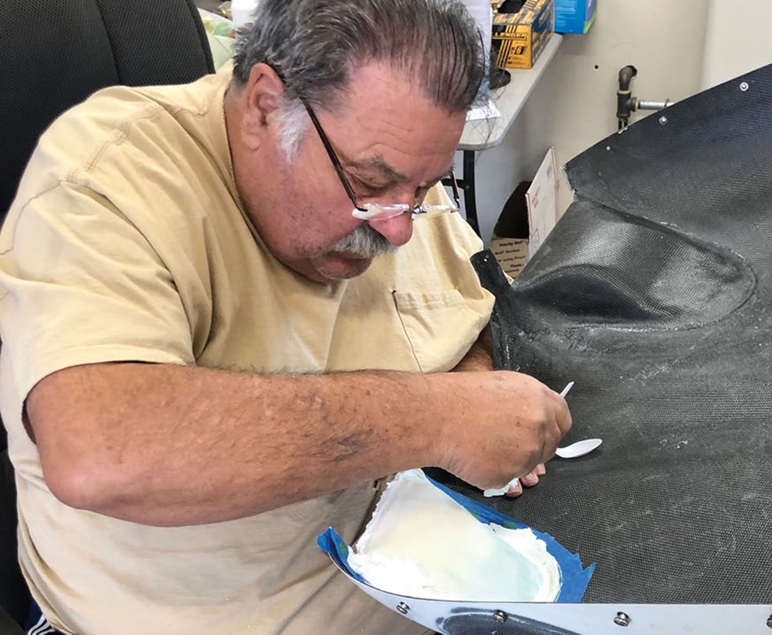

The high CHTs were a more involved problem. There were several avenues that Mike took to address this issue. Early on, he decided to contact Ross Farnham, who manufactures the SDS digital fuel injection and ignition system and is very knowledgeable about the system setup. Mike explained to Ross that we are in the process of breaking in the engine and described the issues of the high CHTs. Ross suggested retarding the ignition timing to 20° (normal being 25°) during break-in to keep the cylinders cooler. Mike also did more work to the cowl by making the intake ramps a bit bigger (more fiberglass work, oh boy) and enlarging the lower-cowl outlet. He also installed some air dams for cylinders 1 and 2 to help get more airflow to cylinders 3 and 4.

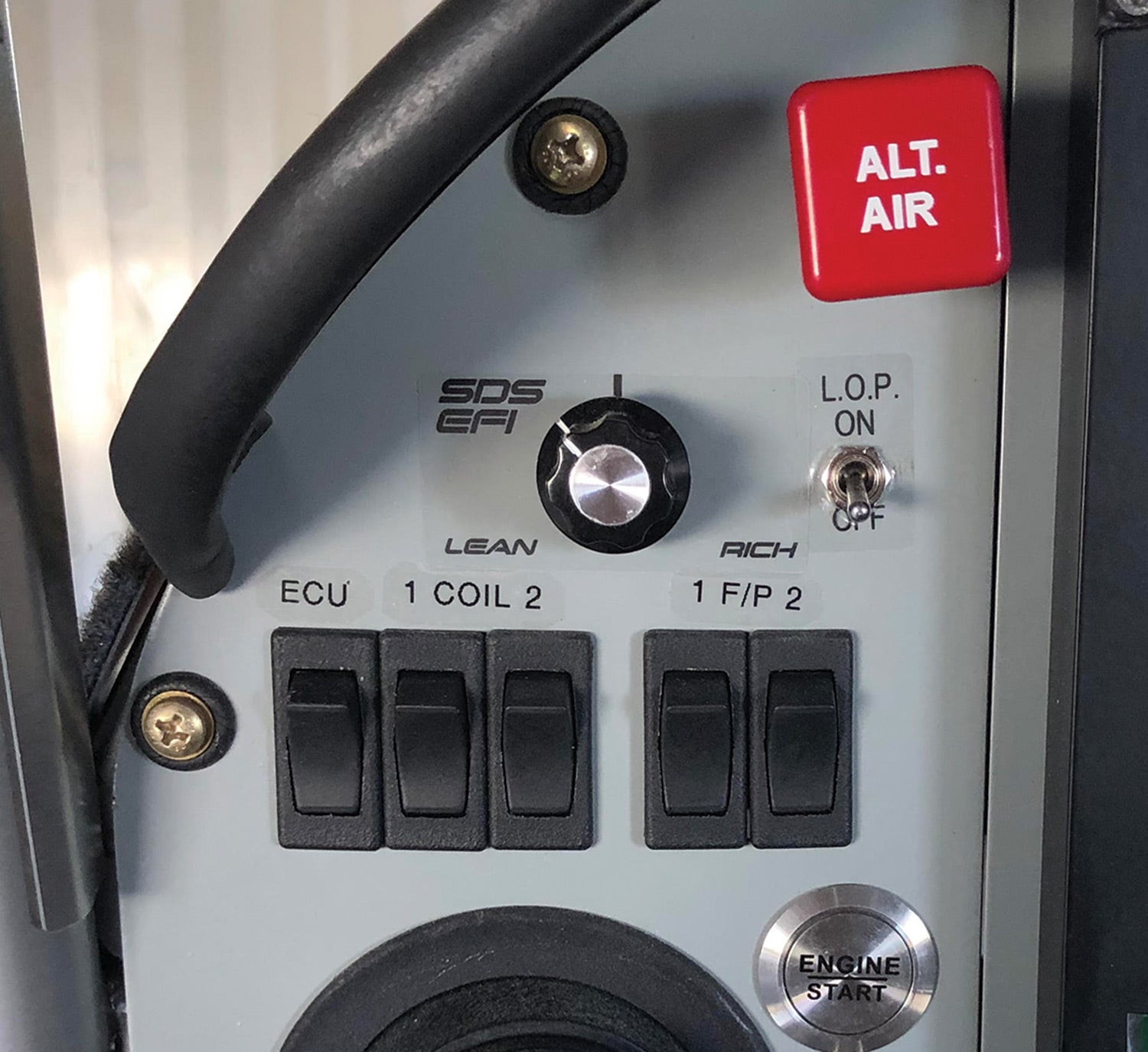

The knob labeled “SDS EFI” manually trims mixture settings of the electronic fuel injection. Rotating left is lean, right is rich. This was one tactic to help reduce high CHTs.

Since the SDS system is not yet dialed in to automatically change mixture based on engine speed, there is a small knob on the instrument panel to manually set the mixture to lean or richen as needed.  Paul dialed it up from 10 o’clock to noon (richening), with the CHTs soon coming down, although three of the four were still just above 400°. Paul circled the runway, did some Figure 8s, richened the mixture to the 2 o’clock position and the CHTs continued down. A few minutes later, he richened it again—this time to the 3 o’clock position. Now the CHTs came down to 377, 350, 366 and 360. There we go!

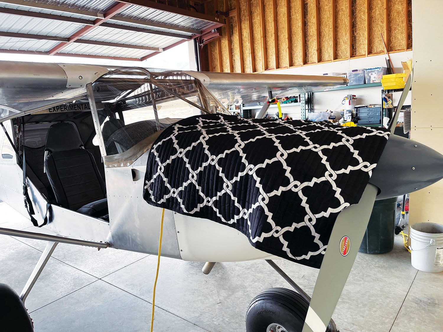

13 Cozy and sump heater plug in for cold nights
Summer becomes fall and then winter, so the S-21 gets bundled up with blanket, cowl plugs and sump heater to keep it cozy on those cold nights.
