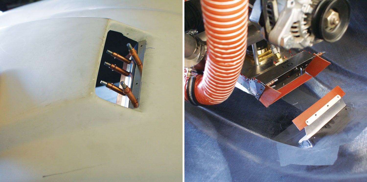

A custom fillet fabricated by Mike is used to smooth the airflow to cylinders and to prevent leaks in the fixed baffling (left). A “capture strip” holds the red silicone flexible baffling material in place (right) and also helps prevent leaks. Every little bit helps engine cooling.
Next, it was time for Mike to address engine cooling. You need to direct the airflow in such a way as to have it circulating around the surfaces of each cylinder without air leaks and details count. As part of his detailing, Mike cleaned up the casting “flash” common in the cylinder-head fins that restricts flow and can make the cylinders run hot. Then he custom fit red silicone material to the fixed engine baffling, a painstaking process that took quite a while. How the cylinder-head temps do during flight will be the true test. While working on the baffling, Mike did some custom fiberglass work to further improve cooling-air flow (see “Building Cooling-Air Ramps” below).
