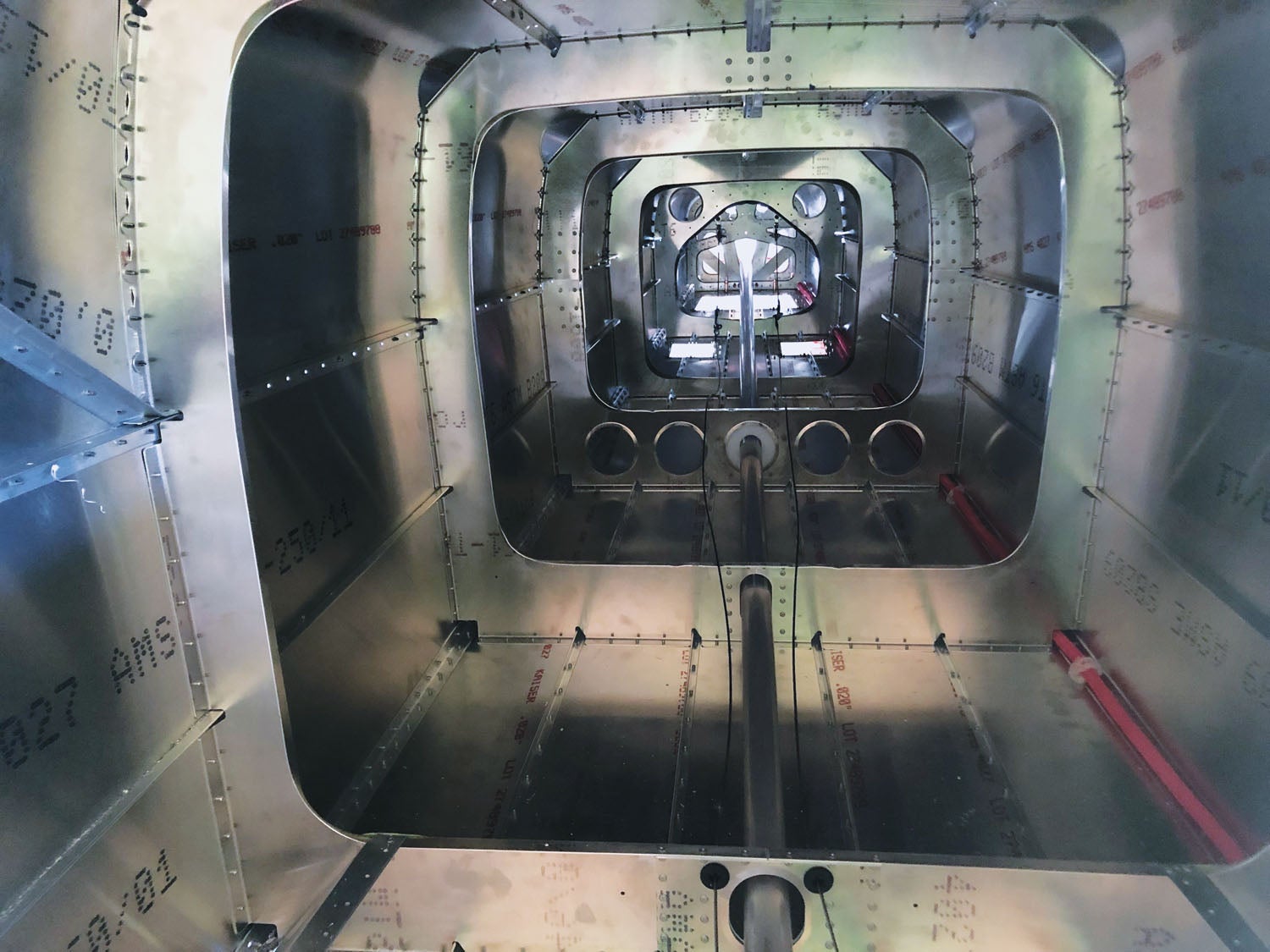

It took us a full day of prepping with locating all the right pieces for the tail cone build and choosing the right place to accommodate it. Here’s the dilemma: The S-21 is more than 22 feet long overall, with much of that between the cage and the tail cone. It was clear that we didn’t have room in the separated shop space for the finished assembly—the tail cone and the fuselage cage together. And then there’s the matter of how to get the bottom skin and the bulkheads started. These pieces wanted to be built upside down on sawhorses, so that suggested we move out into the hangar.
Actually, not so fast. We took advantage of the nice flat workshop table to begin attaching the stringers and longerons (long metal pieces) to the bottom skin. These provide strength to the part and help it maintain shape and could easily be done on the table.
Once that was completed, though, we had to move out to the hangar. That’s because you build the tail cone upside down balanced between sawhorses and attach the bulkheads (rib-like frames inside the tail cone) hanging down from the bottom skin of the tail cone.

Once again, Mike did his magic to make sure each bulkhead was flat, adjusting them with the fluting pliers. It is super critical at this time of the build to make sure everything is straight. You really don’t want to have any twist built into the tail cone! One of the little things I learned was to identify the areas not to rivet and tape them off so I didn’t continue on with riveting in the wrong holes when the time came.
Pretty soon we were able to get all the bulkheads pointed the right direction, then get them all Clecoed and riveted in place. Another helpful thing for me was to label each bulkhead with a station number (per the manual) because the text of the manual frequently refers to the various stations—they are numbered front to rear, so it’s pretty easy to figure out that Station 7 is ahead of Station 8—even upside-down! It was really fun to see the shape of the tail cone starting to appear. There were more stringers and longerons to get into place on the sides of the bulkheads to give the tail cone strength.

Next logical step was to get the side skins on. We were lucky this day to have our neighbor friend Heather over to assist us. It turned out to be extremely helpful to have another set of hands. While she was here, we were able to get the left side skin Clecoed on, riveted, flipped and carried into the workshop where we attached the right side skin. It was fun having Heather there to assist because even though she is a very experienced pilot, she had no experience building. It was great sharing the build with someone when it’s as basic as, “Here’s how a Cleco works!” This was a great part of the build for her to see, because you could witness huge progress for the day’s work.

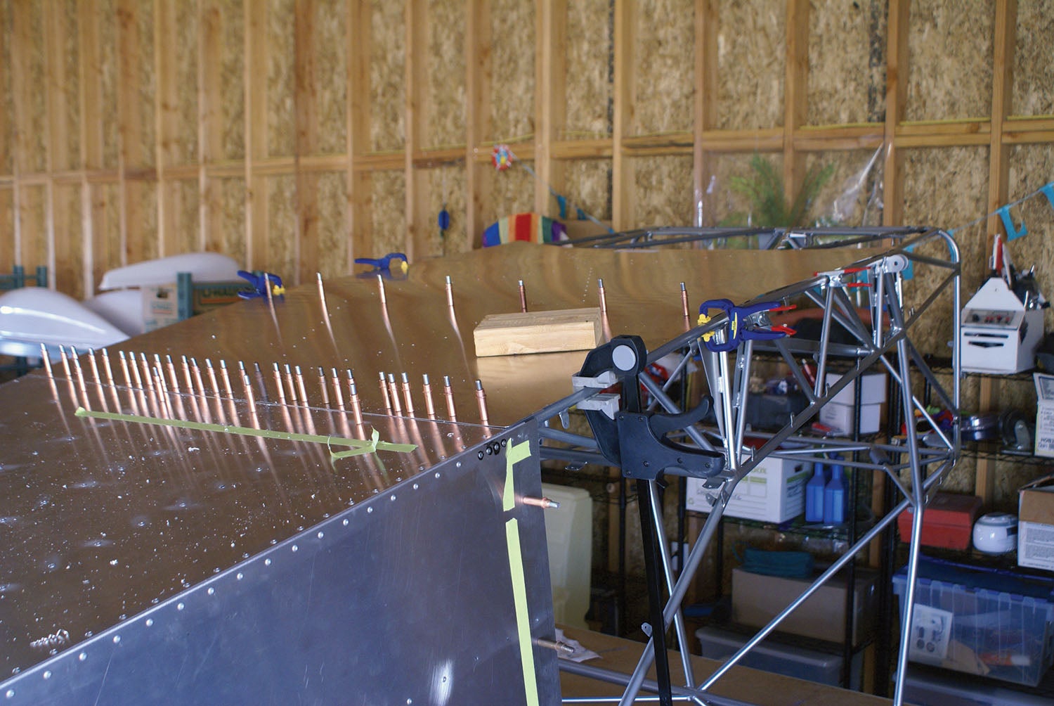

Now that all the inner workings of the tail cone were in place, it was time to close out the tail cone with the right and left top skins over the tail cone and the right and left front top tail cone pieces, which are actually on the aft end of the cage locking the cage with the tail cone. The tricky part of this was to not have any pillowing of the skins, so you really need to be mindful when fitting to get the skins just right and to do your transfer drilling in exactly the right places. I got to use the edge forming tool for the first time after practicing a bit on some scrap. It came out pretty nice if I do say so myself! Another tricky part is to get the stringers that extend over the aft part of the cage bent correctly. It is critical when joining up the skins that the measuring for level continues throughout the skin fitting process, because once these skins come together the tail cone shape is locked in.

With the lower canoe complete, it’s time to fit the top skins (left and right). Taking a moment to slow down here before transfer drilling and Clecoing helps prevent errors, though the structure is already fairly sturdy.
Final fitting of the S-4 bulkhead close-out (the tub) came after the top skins for the tail cone were fitted, but before the aft cage right and left top tail cone skins were fit—for ease of being able to reach the area we were working in. This part was a bit of a pain because we had to pull the tub in and out of the plane several times to get the cutting and filing of the piece just right to fit the area. In the end it all worked out, and it was set aside for a later date when closing out the tail cone was to really happen—someday in the future!
The only difficulty we had with the fitting of the aft top tail cone skins was that they needed to be drilled from the inside of the cage through the stringers  into the top skins. We decided the best way to accomplish this feat was for me to lie on my back inside the tail cone and drill over my head, then have Mike insert Clecoes from the top down. It was a bit of role reversal from our usual routine, but I didn’t mind that. It was nice to know that I was capable of getting into a tight spot and fully capable of doing the drilling myself.
20 tailcone skins clecoed copy
Resembling a copper porcupine, the Clecoed-together tail cone (left and right) is carefully measured to be square and straight before riveting begins. The lower surfaces have been completed so this step moves somewhat quickly.

At this point, our little plane looked like a porcupine with all the Clecoes coming out of it. Final alignment check gives us zero twist. Victory is ours! This part of the work is now familiar once again. un-Cleco, deburr and de-sticker all pieces and parts only to Cleco all the skins back together again for “Rosie” to take over. I started riveting the centerline (the spine) of the top tail cone and worked my way down each of the right and left skin side rows toward the bottom to avoid pillowing of the skins, then did the same for the top front tail cone skins working from the center out. There was a lot of balancing on ladders and working from on top of the table with long reaches, but taking every bit a little at a time is the key to getting through it.
