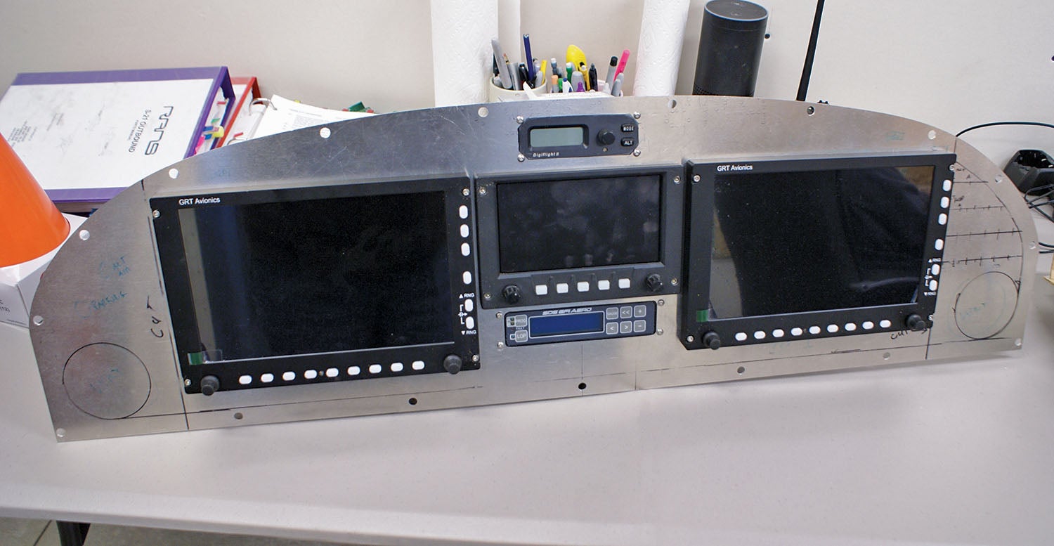

Near the beginning of the S-21 build process, Mike began shopping the used market online for the instruments. He is quite the miser; pinching pennies is what he is all about. I am more of the “pick it out and order it” type. I figured that we are spending so much money at this point, just go for what you want. (That can be a pretty expensive attitude when you are looking at instrumentation!) Anyway, Mike was able to find an 8.4-inch GRT HX used (it’s a recently discontinued model) and a WS EFIS that he wanted to use for engine monitoring, not navigation. Problem is that he was only able to find and purchase one 8.4-inch HX used, and the fact that it’s a discontinued model made ordering a new one impossible. Of course, we wanted two of them.
As the time passed and Mike could not find another, we decided to look at the website to see what the latest and greatest EFIS GRT had available was and priced it out. I fell in love with the GRT Horizon 10.1-inch screen—oh, the resolution and functionality it had! That was what I wanted. So, we decided to bite the bullet (the money bullet, that is) and get two new GRT Horizon 10.1 displays.

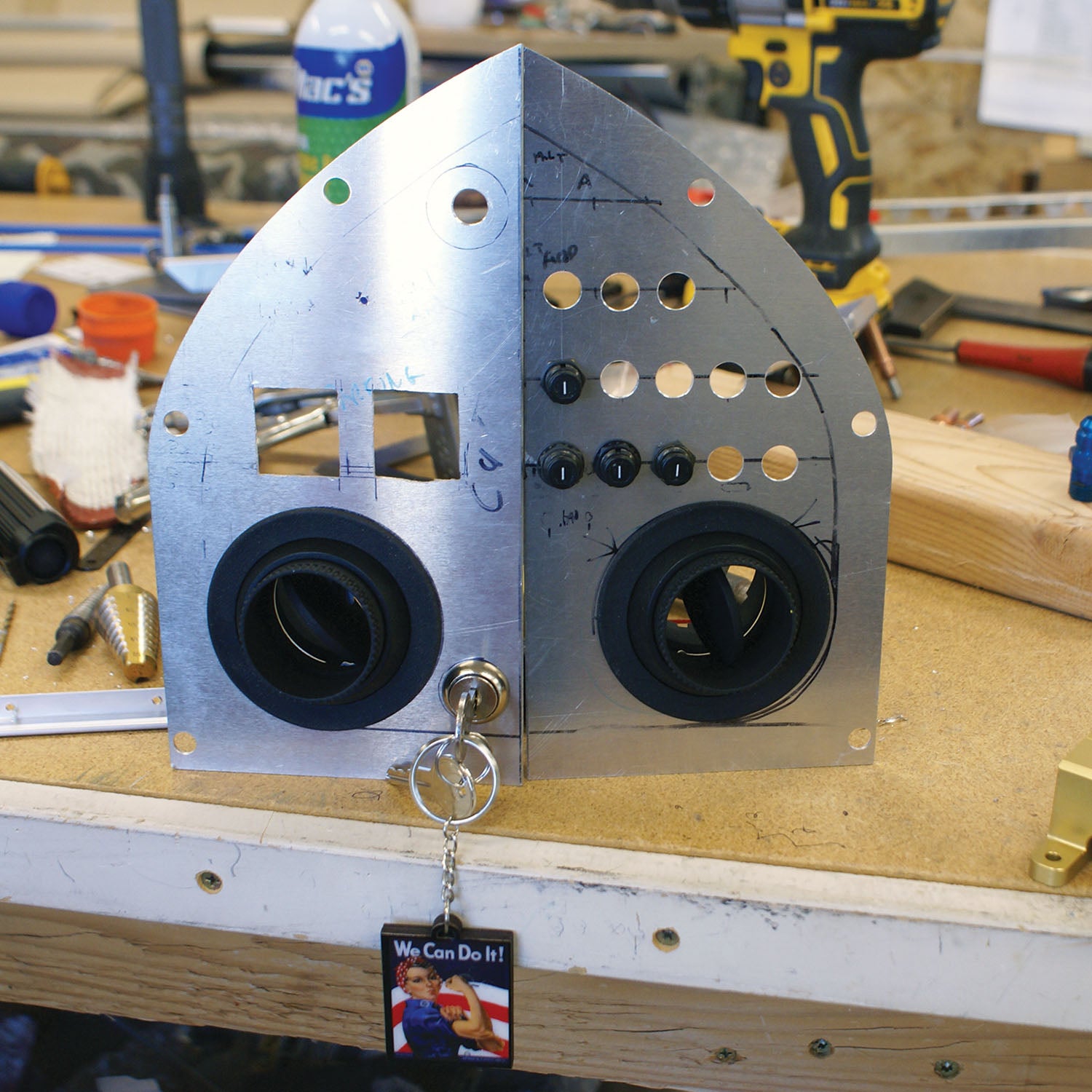

The time finally came when he was ready to design the layout of the panel. Now having the instruments on hand, he was able to draw onto the panel the exact layout desired. Mike had the theoretical ideas in his head of how he wanted it designed yet was not sure if all would fit. You not only have to consider the face of the instrument size on the panel itself, but how deep it is and where the wires are going to go—as well as knowing if there will be any support required behind the panel. Plus, you have to design for maintenance access.  Once the cutting begins on the panel, you are pretty much committed!
We had several discussions on where to locate switches and indicator lights. We want to have either of us fly from either seat and tried to mirror form and function on either side of the panel to achieve that end. In the long run, we decided that no matter what, if only one of us was flying, that person would be in the left seat, so we designed the panel around that concept. The key switch and other engine-related switches and such are all on the far left side of the panel. We agreed upon the placement of the instruments and switches before any cutting began.

Mike drew the dimensions and exact locations of the instruments and items on the metal with a marker, leaving two lines where sections of the panel would be cut. The center section of the panel would be hinged on the bottom and screwed into the top of the panel frame to allow it to drop down (toward the seats) for ease of access. The side panels, which would remain stationary to the panel frame, contain the vents, circuit breakers and engine-control switches. (See more of this in “The Big Cut,” below.)
Mike was like a little boy when he was cutting on that panel, a dream come true for him! I was quite impressed at how meticulous he was with getting the instruments’ fit just the way he wanted, taking things a bite at a time and fitting the instrument several times, a bit here and a bit there until it was just right. Then repeat the process for the next instrument.

Once those side panels were created and riveted in, Mike showed me another fine idea he had up his sleeve, one that I really didn’t appreciate until I saw it. He added a swing-away, drop-down subpanel to the left side panel that will remain folded up during flight, because it is something that is set and largely ignored during flight. (See “Hidden Gems” below.)

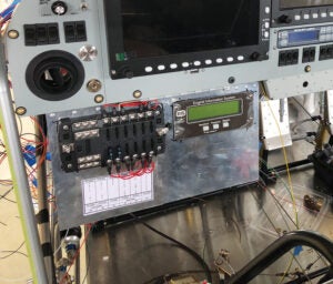

Another interesting idea Mike was planning all along, that I really didn’t appreciate the need for until I saw the end product finalized with all attached pieces and parts, was that he built out of some extra aluminum a shelf behind the instrument panel below the boot cowl for the many devices that are required for the function of the GRT EFISes, autopilot, voltage regulators and SDS system that are “behind the scenes” for the functionality of the system. We will go into more detail in the next article when we discuss the wiring.
