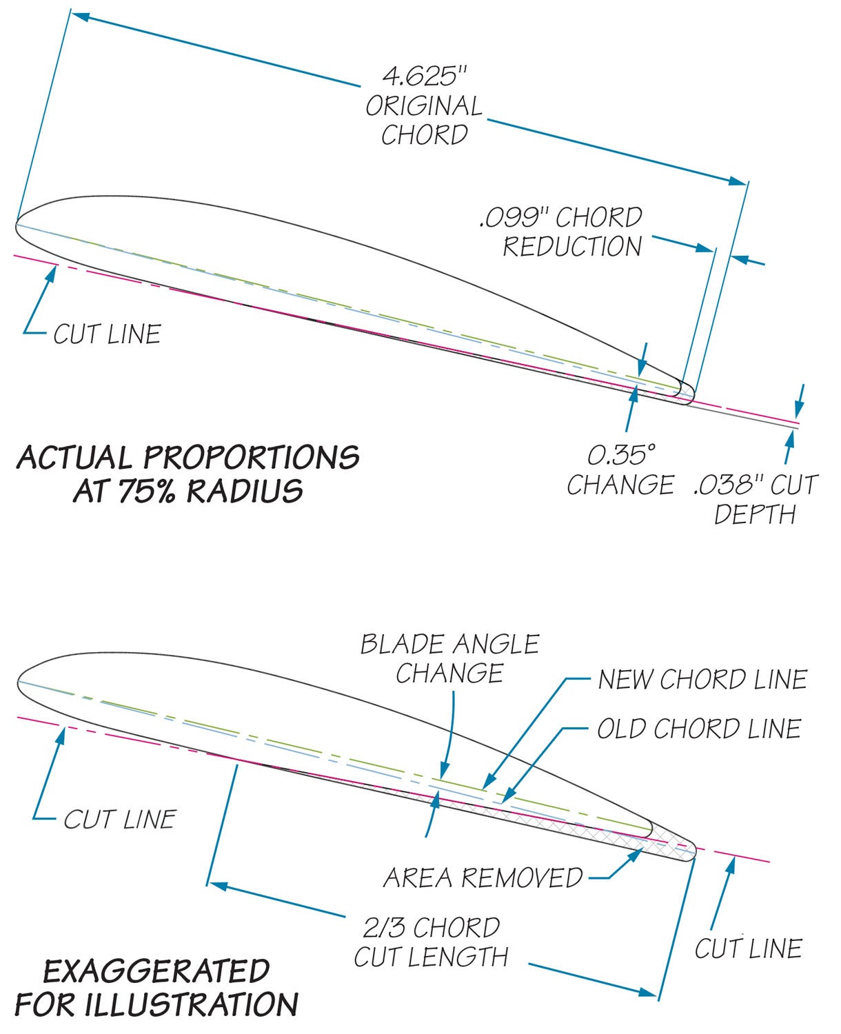

PROP PITCH
Cross section showing material removed at 75% radius. Actual proportions shown above, with cut area exaggerated for clarity below.
I had ordered a 74×47 wood propeller to replace the 74×50 metal prop. The increased blade thickness, and thus camber, in a wood prop means it will need less geometric pitch than a metal prop. I had (correctly, as it turned out) suspected that even 47-inch pitch might still be a bit too much, but it was a good starting point.
While a wood prop can be reshaped to reduce the pitch (within limits), it’s not so easy to increase it. Ed Sterba will rework any prop he makes to reduce the pitch for free, and after initial testing of the new prop I did send it back to him for a pitch reduction. The rework (to 46-inch pitch, not quite as much as I was looking for) improved climb performance somewhat, but testing showed it needed to be reduced still more to get the engine rpm where I wanted it and hopefully improve performance a bit more.
A reduction in either diameter or pitch will increase rpm. After considering the options—send it back again, trim the diameter a bit or rework the pitch myself—I settled on the third option. It’s not that difficult, but it does require careful and accurate work.
The pitch of a metal prop is adjusted by twisting the blades; no material is removed, and it can be increased or decreased. It’s not practical to increase the pitch of a wooden prop, but it can be decreased by removing a small amount of material from the lower (back) face, from mid chord back to the trailing edge, which makes the blade chord narrower at the same time. This moves the chord line up a bit in the back, lowering the angle of attack and thus the pitch. The resulting airfoil shape changes somewhat to a flatter camber, though maybe not enough to matter. All these things contribute to raising rpm by reducing the load on the engine. The leading edge and upper (front) surface are not altered. If one tried to increase the pitch of a wood prop by reworking the upper surface, the effect of the pitch increase would be counteracted by the chord reduction, so the change wouldn’t have much effect.

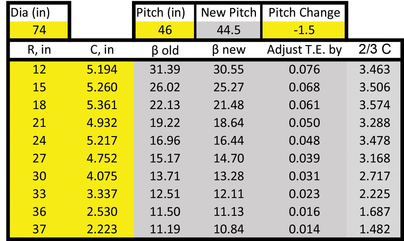

I decided to shoot for a 1.5-inch pitch reduction to 44.5 inches, which should give an additional 75–150 rpm. The first step was determining exactly how much material needed to be removed. Not only is the actual amount very small, it varies along the blade due to the changing blade chord (width) and the radius. As described in the previous article, propeller pitch is defined as 2*π*R*tan(β). Working the other way, the blade angle β is given by:
β=arctan(pitch/2*π*R)
The material to remove at any given radius, then, is the tangent of the angle difference multiplied by the blade chord at that radius or:
material removed=tan(arctan(old_pitch/2*π*R)-arctan(new_pitch/2*π*R))*chord
spreadsheet updated
A spreadsheet made the repetitive calculations easy.
A spreadsheet made the calculations easy. For 1.5 inch of pitch reduction, the actual amount that had to be shaved off the trailing edge thickness varied from .014 inch at the tip to .076 inch at 12 inches from the hub. Inboard of 12 inches the airfoil is truncated by the hub faces, so I didn’t try to rework that area.

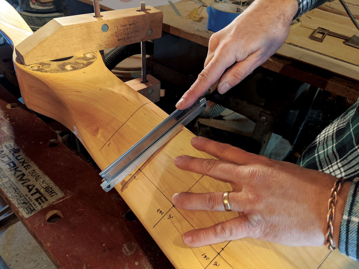

But how to do it accurately? Fourteen thousandths of an inch is a number more normally associated with precision metalworking than wood carving! One way to shape a wood surface is to make a series of saw cuts to the desired depth, then remove material between the cuts until the cuts disappear, not too different in principle from squaring lumber with a broadaxe between crosscuts when building a log cabin. Not wanting to take an axe to my propeller, however, a fine saw and an orbital finishing sander seemed a better choice.
IMG 20200301 134932
Setting the cut depth with the back end of a dial caliper.
Making the Change
I experimented first on a scrap board with a Zona razor saw inherited from my father. By clamping aluminum strips to the sides of the saw so that only the required distance protruded, it was possible to make cuts of the proper depth and no deeper. I tried a few different ways to set the saw guide precisely using shim stock or adjusting screws, but simply tapping it into position with a tiny hammer and checking it with a dial caliper worked best.
IMG 20200301 135148
The guide is two aluminum strips clamped to the blade by 10-32 screws. Cutting grooves to establish the amount of material to be removed (right). The clamped-on guide makes it easy to go to the required depth and no deeper.
The cuts are full depth at the trailing edge, then the saw is carefully tipped forward to extend the cut forward until it fades out around two inches from the edge (I used 2/3 of the chord on the actual propeller). The orbital sander with 120-grit paper was then used to sand the face down until the cuts disappeared. This part is slow, as a finishing sander isn’t made for heavy material removal, but it makes it less likely to go too fast and remove too much material. The results on the scrap board were good enough that I was ready to try it on the real thing.
The first step was to draw chordwise lines at 3-inch increments, with a mark at the 1/3 chord point (i.e., 2/3 forward from the trailing edge) on each line, and lines connecting those points to give an approximate line to sand to. Next, the saw guide was set to the proper depth before making each cut.
Taking a deep breath and dismissing the “Am I going to wreck a perfectly good propeller?” thoughts, I made the first cut, then the rest of the cuts, readjusting the guide for each pair. Then came sanding. The birch propeller is a bit harder than the soft pine test board, so it was even slower, but this is a place where it’s important to take your time. If you remove too much, you can’t put it back! Gradually the cut lines disappeared as the surface approached the desired new shape.

Once the surface was down to the desired contour, the material removed meant the trailing edge would now be too thin. Trimming it back to where it’s thick enough not to be fragile is what accounts for the chord reduction. A steel scraper took care of rounding it to approximately what it was before, about a 1/16-inch radius, with a bit more sanding to smooth it out. I must have removed the material evenly as the prop still balanced perfectly when I was done. New angle measurements, this time using a new homemade fixture and the Spirit Level Android app, showed a pitch of 44.3 inches, just about what I was shooting for.
After removing the remaining marker lines with denatured alcohol, it was ready for the first coat of rattle-can polyurethane varnish. I applied five coats over the next few evenings, then rechecked the balance. One side was a bit heavy at this point, so I shot another coat of varnish on the light side, which brought it into perfect balance and ready to mount.
