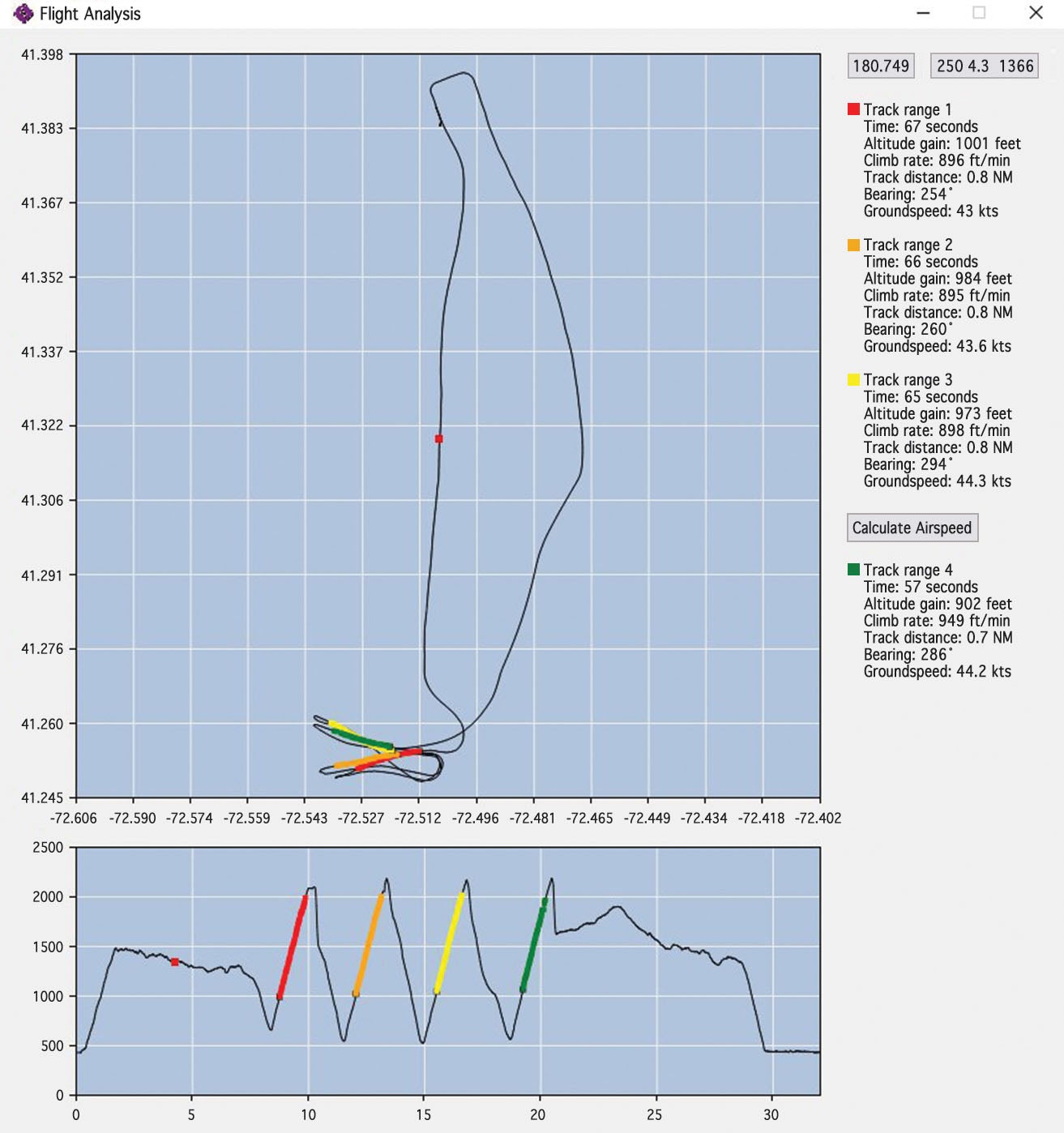

A month later there was a forecast for a good warm day during the week, so I decided to go flying on a long lunch break from work, having reinstalled the altered prop the night before. I didn’t have time for a complete test, and it was again bumpy, but I flew around for a while and did some takeoffs and landings. It was a noticeable improvement; acceleration on the takeoff roll and climb seemed better, but it still wasn’t reaching the engine’s rated 2600 rpm in level flight, much less during climb. I made a few more short flights when weather permitted, but it was another month before I got good weather on a weekend day with enough time to test, swap and test again. Instead of measuring climb rate at different speeds this time, I made multiple climb tests at 60 knots, which is my usual climb speed.
Flight Analysis plot 20200223
Test data from Trackreader, a GPS log analyzer written by the author. Climb rate averaged over four runs is the comparison parameter.
The results were again somewhat ambiguous. I took off into another typical New England winter day (cold and bumpy) and made a full-throttle level run and four climbs from 1000 to 2000 feet before my fingers were too numb to continue. Back on the ground and once my fingers warmed up enough to manipulate the safety wire, I removed the wood prop and put the metal prop back on and repeated the exercise. It was again too bumpy to tell for sure which performed better, but the wood prop was still turning slower while cruise and top speed were still about 5 knots higher.
Could I do better by reducing the pitch some more? Possibly, though the gain might be small; another 100 rpm would only mean another 2 hp, and since the prop is shaped by hand, it’d be all too easy to go a little too far. One inch of pitch is a very small change in terms of the actual material removed, and I might end up with worse performance instead of better. Another option would be to keep the pitch the same, but simply trim the ends to reduce the diameter an inch or two. Ed suggested I do that myself, without risking shipping damage on another round trip to Florida. I resolved to wait until I had another chance to swap props on a good day before making any decision.
Finally, in February I got the perfect day. Not only was it unseasonably warm, but the winds were off the ocean, meaning glass smooth air over the coastline. Instead of testing at different speeds, I did four 60-knot climbs and a full-power run with both props, then just flew around for a while enjoying the beautiful day before going home to analyze the data. This time it was much more consistent. The rate of climb with the wood prop averaged 144 fpm less than the metal prop, but surprisingly it was still turning the same 75 rpm lower as before in climb as well as at full power, where the speed was still slightly higher than the metal prop. Clearly, it wasn’t quite there yet.
Now I had a dilemma: I could send the prop back to Sterba for another adjustment, I could trim a bit from the diameter to bring the rpm up, or I could attempt to rework the pitch myself. Trimming the tips would be easy, but more diameter is usually better, and the issue was too much pitch, after all. The decision was clarified while discussing the options with a friend who said, “Face it—you know you want to take the craftsman approach!”
