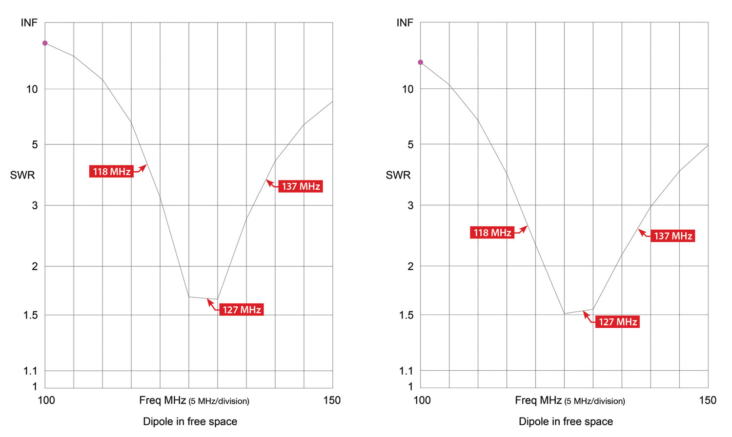

nweasuring antennas 03
Using #14 wire, notice how narrow the bandwidth is and that the band edges (118 and 127 MHz com band) are well above 3:1 VSWR. This is not a good antenna (left). The same band coverage as the #14 wire, but by using thick ½-inch copper tape we get the band edges down around 2.5:1 (right). I will demonstrate in the next issue what this means to the com transmitter.

So what does VSWR do to you? It reflects any signal or power back down the transmission line and does not deliver it to or from the antenna. How much? 1.5:1 VSWR means about 5% of the power (or signal) gets bounced back down the coax. Five percent isn’t that big of a deal. But what happens when we go to the ends of the band instead of the middle? 2:1 VSWR is a 10% power loss and it just gets worse from there. I’ll show you the calculation next month on how to easily calculate the loss.
So, how can you get your antenna down to a lower VSWR? There is only one simple answer: Make it fatter. If you are making a plastic airplane, use wide (1/2 inch) copper tape or some other low-resistance conductor instead of thin wire.
