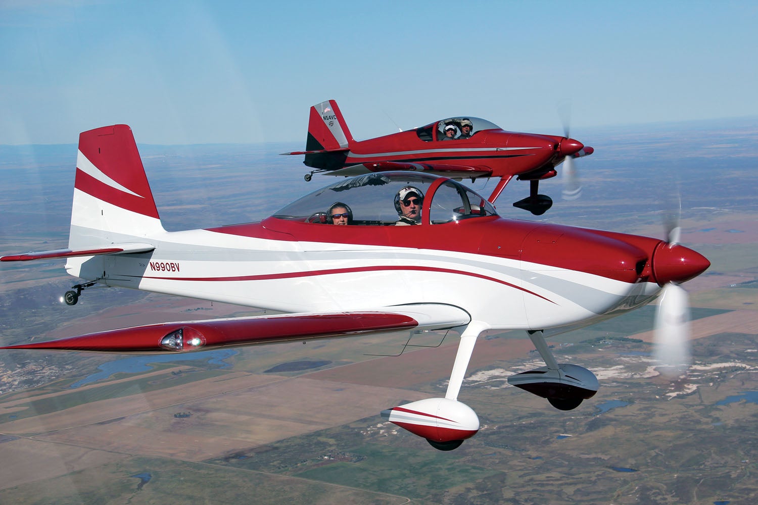

For those who have experienced it, the fun of going on a flying trip with your friends and their families in the airplanes you built comes pretty close to maxing out the fun factor for many of us. What really makes this experience enjoyable is being able to share it with a group of competent pilots who understand that the key to making the trip enjoyable is all about the preparation, especially as it relates to maintenance. Having just returned from one such trip again where we had 100% dispatch reliability across 11 airplanes over the course of a week and 25+ hours of flying, I want to share with you some ideas, learnings, and observations for those of you who might be considering such a trip.
We’ve all heard the adage that “luck is where preparation meets opportunity.” I can’t emphasize enough that preparation is the key to having fun on the trip, as well as flexibility during the trip. We all agreed that in the month leading up to the trip, all of us would take a hard look at our airplanes and have others put another set of eyes on them as well.

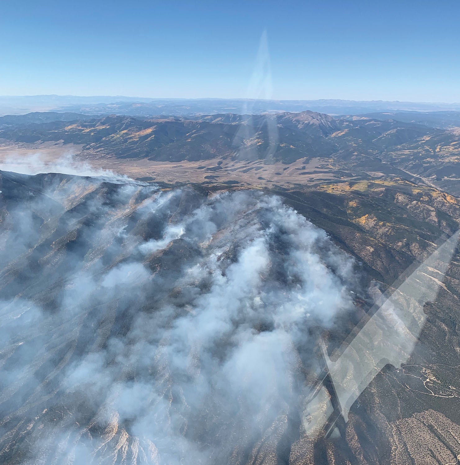

This fire presented a very visual picture of a mountain wave. While the picture doesn’t do it justice due to the angle, the smoke was blowing straight down the mountain. We could see it quite clearly as we approached, so we guessed there would be wave activity associated with it.
Now the meteorology lessons started. It was also fire season, and we noticed a TFR for firefighting along our route. We could see the smoke from quite a distance, and our route took us clear of the TFR by a couple of miles. It was a pretty large fire (that grew even larger after we flew by and also had a much larger TFR surrounding it), and as we got closer I noticed something that just didn’t seem right. I have seen large mountain fires in the past, with some of them having plumes that look like an atomic bomb plume, especially in Alaska. In this case the smoke was blowing completely down the side of the mountain. No smoke at all was going up. Can you say “mountain wave”? During the next 30–40 minutes, we flew through no fewer than six mountain waves. At one point, I had a 46-knot ground speed with 10 degrees nose-up pitch to maintain altitude. Luckily, each time we were able to maintain altitude and fly through it. It was amazing how smooth it was.

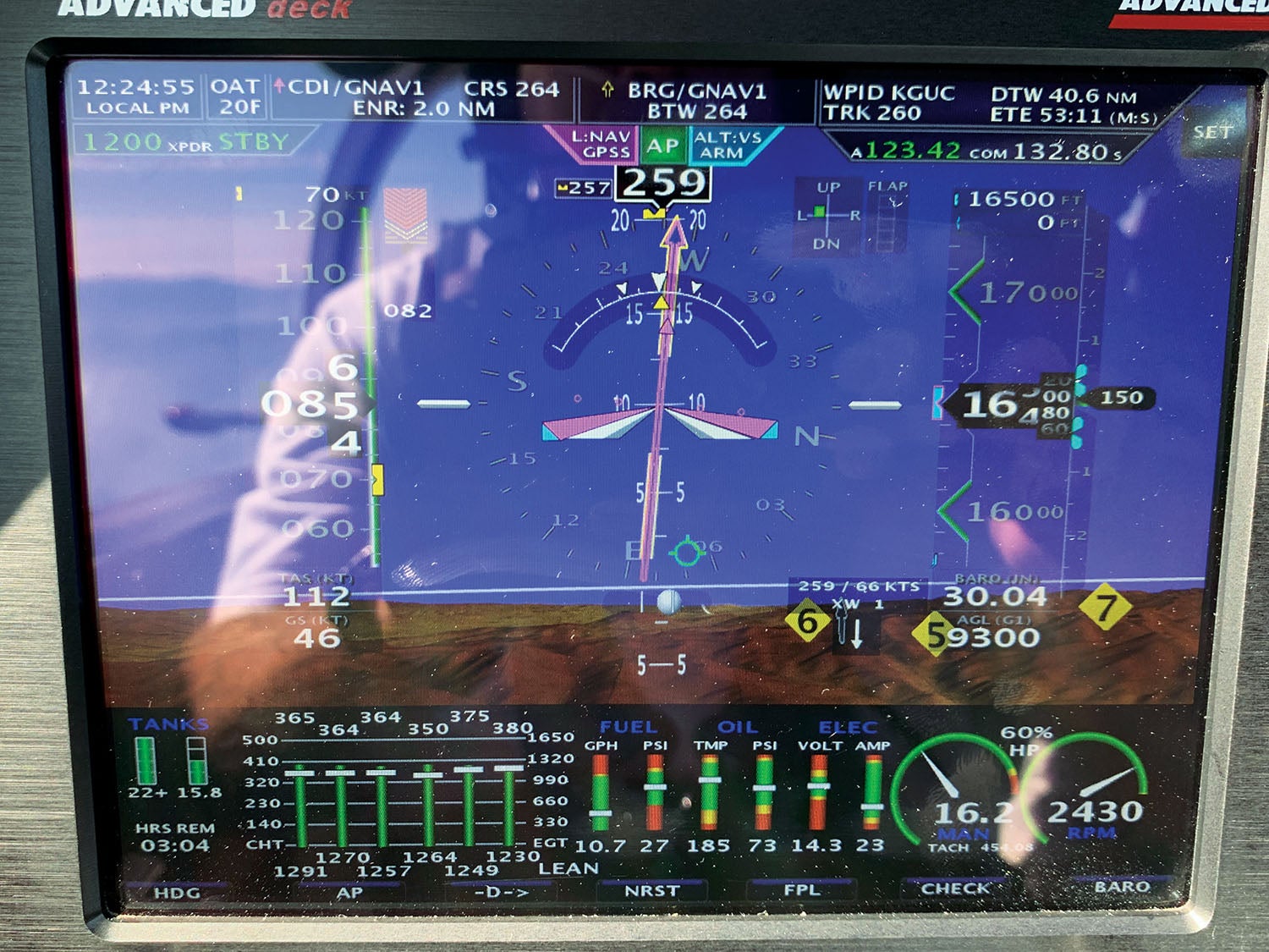

As you can see from the EFIS, at 16,500 feet I was 10˚ nose up, with not much forward ground speed. We were out of it in about 2–4 minutes, with about six more less strong waves to follow.

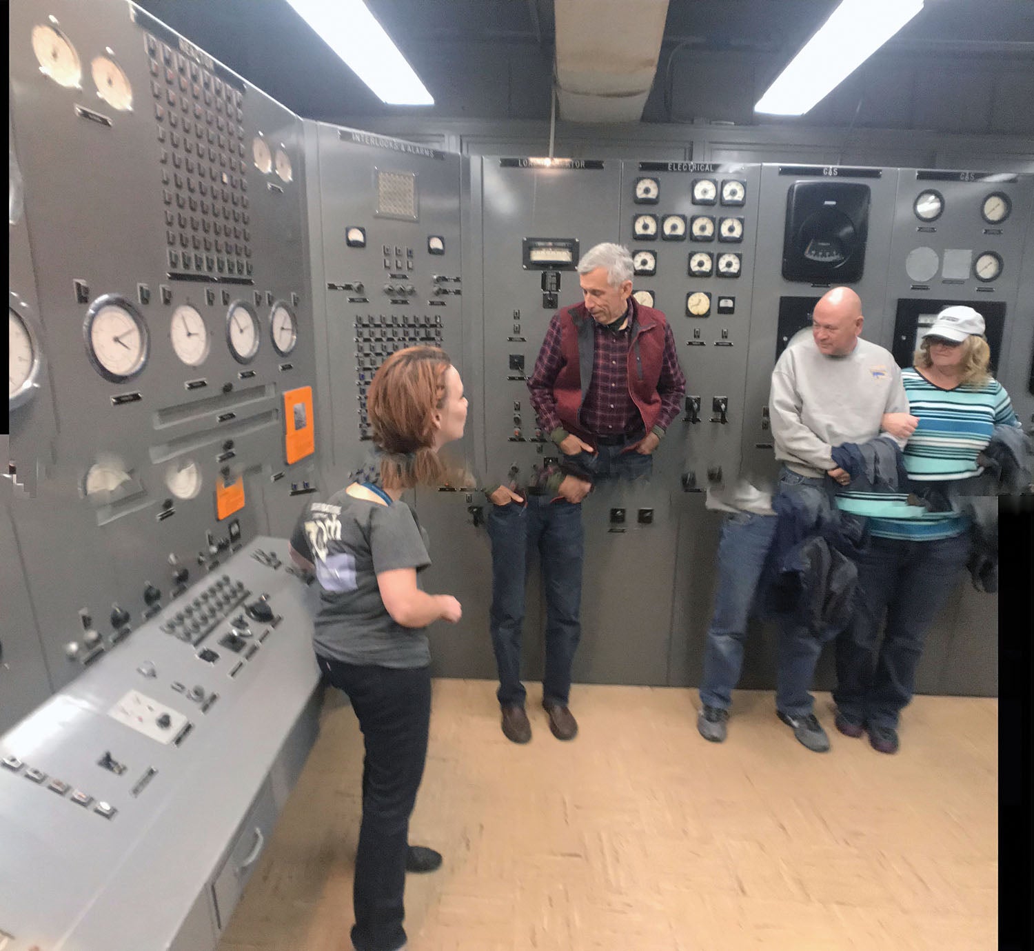

You can’t fly every day, so we visited the decommissioned breeder reactor near Idaho Falls. You’re probably wondering about the picture. It’s an untouched photo taken by one of our group in the control room. We figure there must still be some loose neutrons running around inside there, but you can be the judge. Many weeks later we all still appear to be normal.

We were aware of the TFR for firefighting when we departed. A week later it had grown quite a bit larger. Little did we know that this one would give us a lesson in mountain waves.
