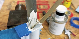

We also need to take the time it takes to get good at the skills of building and maintaining. They’re not hard but they do require instruction and practice. If you’re building a composite aircraft you’re either going to get good at mixing and sanding or you’re going to have a shoddy result. For metal airplanes, you’re going to pound thousands of rivets and it gets easier with practice.
You can bolster your skills through many resources but always consider the source. I will never forget a cringeworthy moment at an EAA meeting where I overheard an “expert” tell a newbie not to worry about misshapen rivets as drilling them out and replacing them can cause more damage than it cures. Of course, the correct answer is to learn how to correctly set rivets and identify those that don’t meet the standard (it’s not hard and there’s a glut of guidance). Learn the skills and take the time to correctly remove and replace poorly set rivets without causing additional harm.
