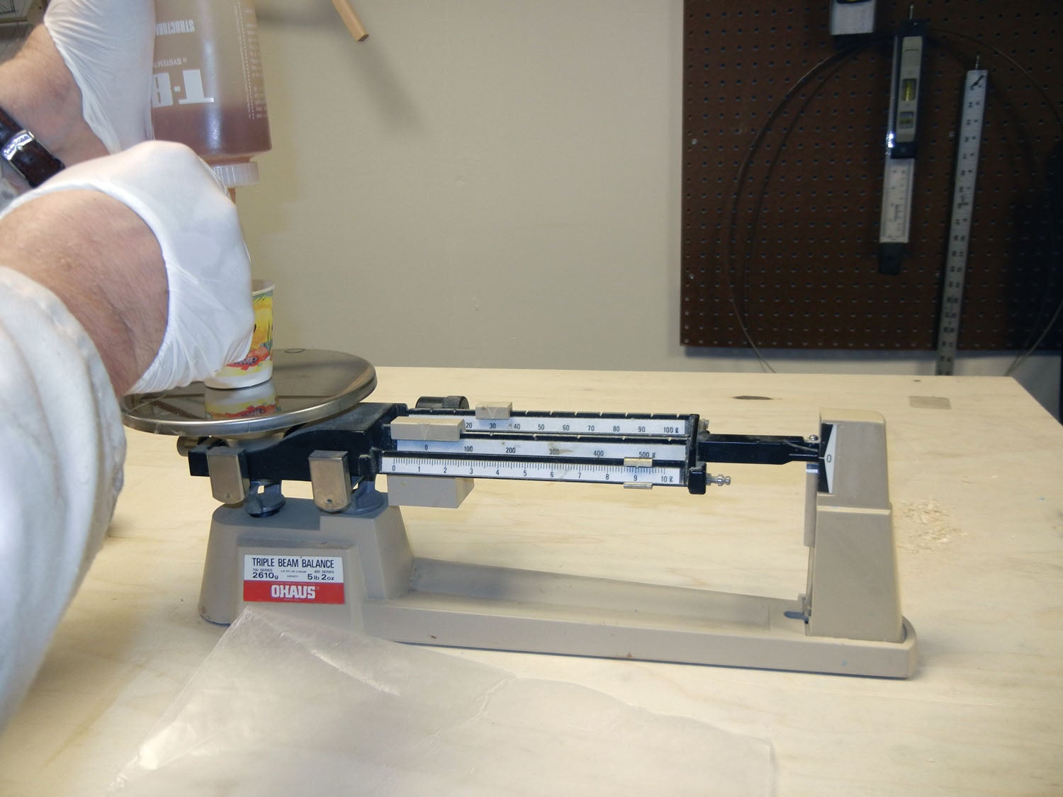

Mastering a very small mix is the key benefit of the triple beam balance and leads to great cost savings over time (left). Measuring out the resin. The cup is never removed from the balance during the procedure (right).
For the purpose of this article we will use T-88’s ratio, 1:0.83. The easiest way to obtain this is with a triple beam balance. These can be a bit costly but can be picked up used. The advantage of spending money for one is that over the length of a full project, you will save more than enough in unwasted epoxy to make up for the cost. You can also use an inexpensive digital scale, but most of those have a display time-out feature that gets in the way when you are moving between steps, and they don’t always show a continuous readout of the weight change as you pour the material.
mastering epoxy 06
Add hardener until the balance levels at the preset target weight.
The basic process is to start with an amount of resin, determine its weight, apply the ratio to figure out how much hardener you need, add that to the resin weight, then set the balance for the target end-weight of the mixture and the cup.
On a balance this is easy: Weigh an empty cup, then add some Part A, read the combined weight and subtract the weight of the empty cup. That gives you the amount of resin that you put in the cup.
Once you have that weight, multiply it by 0.83. This tells you how much hardener (T-88 Part B) is required. If you then add the needed hardener weight to the weight of the combined cup plus Part A, you have the entire final weight, the target end-weight, to yield a perfect mix.
Take a look at the spreadsheet above. In this example we’re using a 2.2-gram cup (more about that later), then adding some resin, which results in a total cup-plus-resin weight of 10.2 grams. After we subtract the weight of the empty cup we’ve found that there are 8 ounces of resin in the cup. Multiplying the resin-only weight by the T-88 hardener ratio of 0.83 results in requiring 6.64 grams of hardener.
The target weight that we then set the balance to is the total of the cup plus resin plus hardener, and that is 16.84 grams.
The cup is never removed from the balance through this entire procedure. We’ve just started with an empty cup, weighed it, added resin, weighed it, did some math, reset the balance to the desired end-weight, and added hardener until the balance leveled.

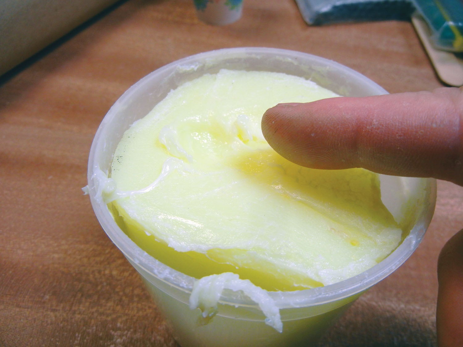

Epoxies can be turned into putty, which turns out to be quite strong and nice to work with. My favorite technique is to mix it with microballoons. You can purchase a pound of this material from aircraft supply houses, and that will probably be enough to last a lifetime. This material gets airborne quite easily and looks like a light powder dust, but it is far lighter and harder to control once in the air. You don’t need this stuff going into your lungs, so make sure you wear a respirator and have ventilation when handling.

Back to putty: First mix the epoxy as normal, then add microballoons and mix until you have a firm putty. It takes a surprisingly large volume of the balloons for each gram of epoxy, so start small. Don’t worry, the stuff weights nearly nothing, so there will be plenty left of that pound you bought.
Once the putty is where you want it, you can spread it with a wooden stick, putty knife, the glue spreaders mentioned earlier or almost any other implement you can think of to fill the gap. This putty mix is one time you can get very liberal with the amount you apply to the project. It won’t run vertically and sands perfectly smooth when dry. Remember also that this is for filling gaps only. It should not be treated as structural bonding.
