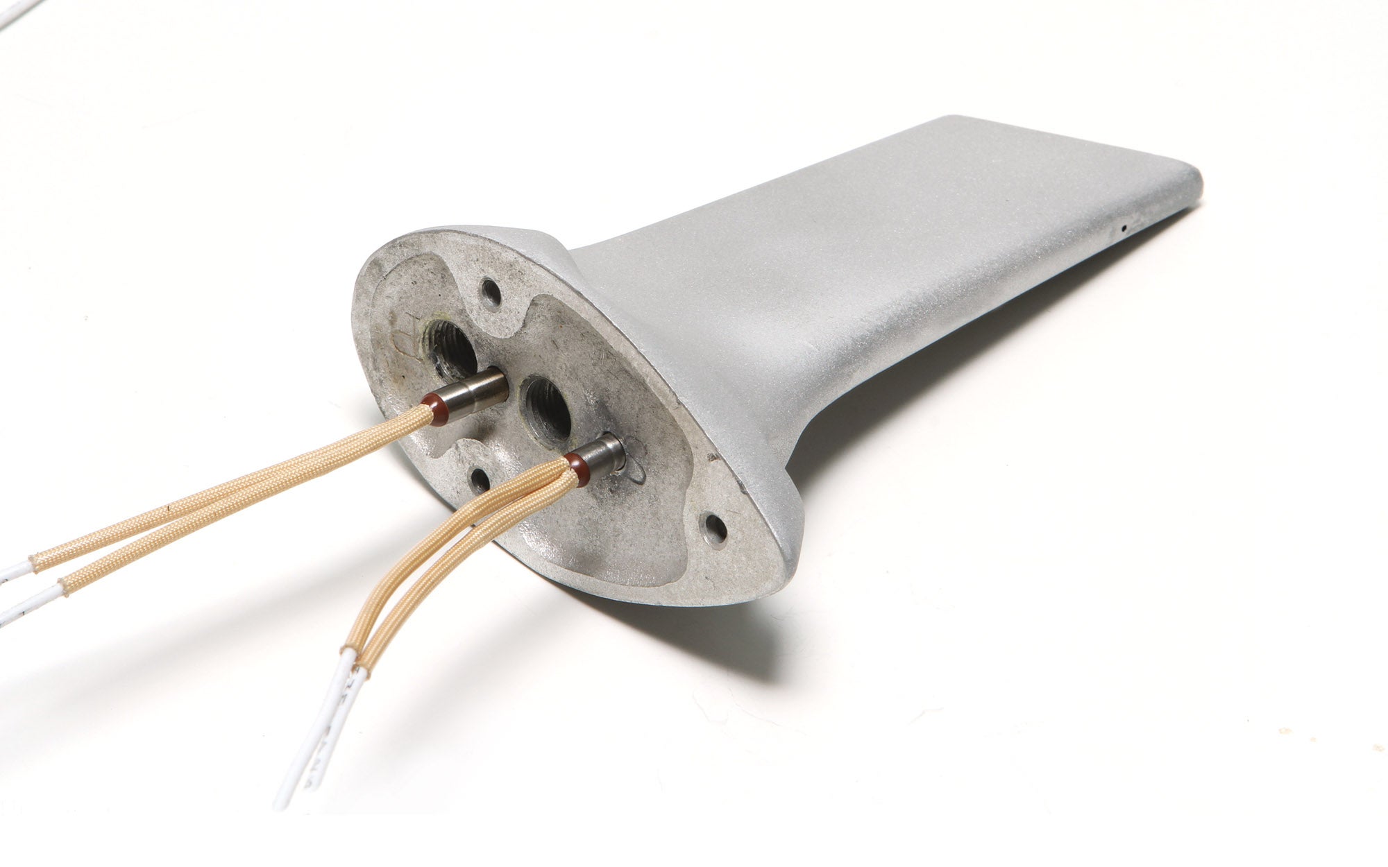

From salvage to salvation: After being drilled and fitted with heating elements, this Piper Cherokee pitot mast is ready to take to the skies once again. Note that the static port is the tiny hole on the trailing edge.

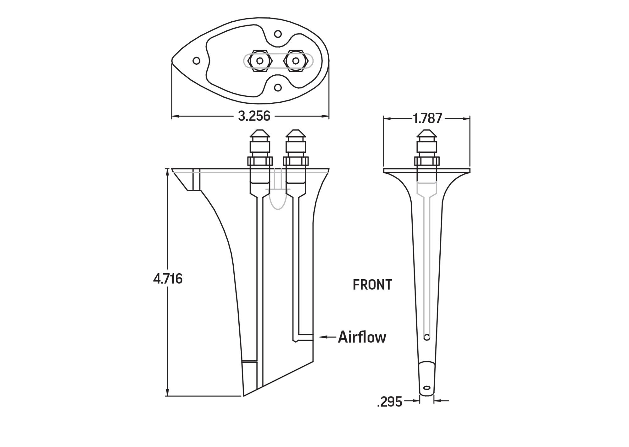

KITPLANES’ editor at large, Paul Dye, is a proponent of using Piper pitot masts in place of the L-shaped pitot tube typically installed on RV builds (see sidebar below). The Piper pitot mast comes in two basic flavors: heated (type 59041-XX) and unheated (type 65797-XX or 65797-XXX). The two parts are practically identical, at least on the outside. The obvious difference is the heated version has a pair of heating elements that sandwich the static port. Since a heated pitot tube is a requirement for IFR flying, heated is Paul’s preferred choice.Pitot mast schematic

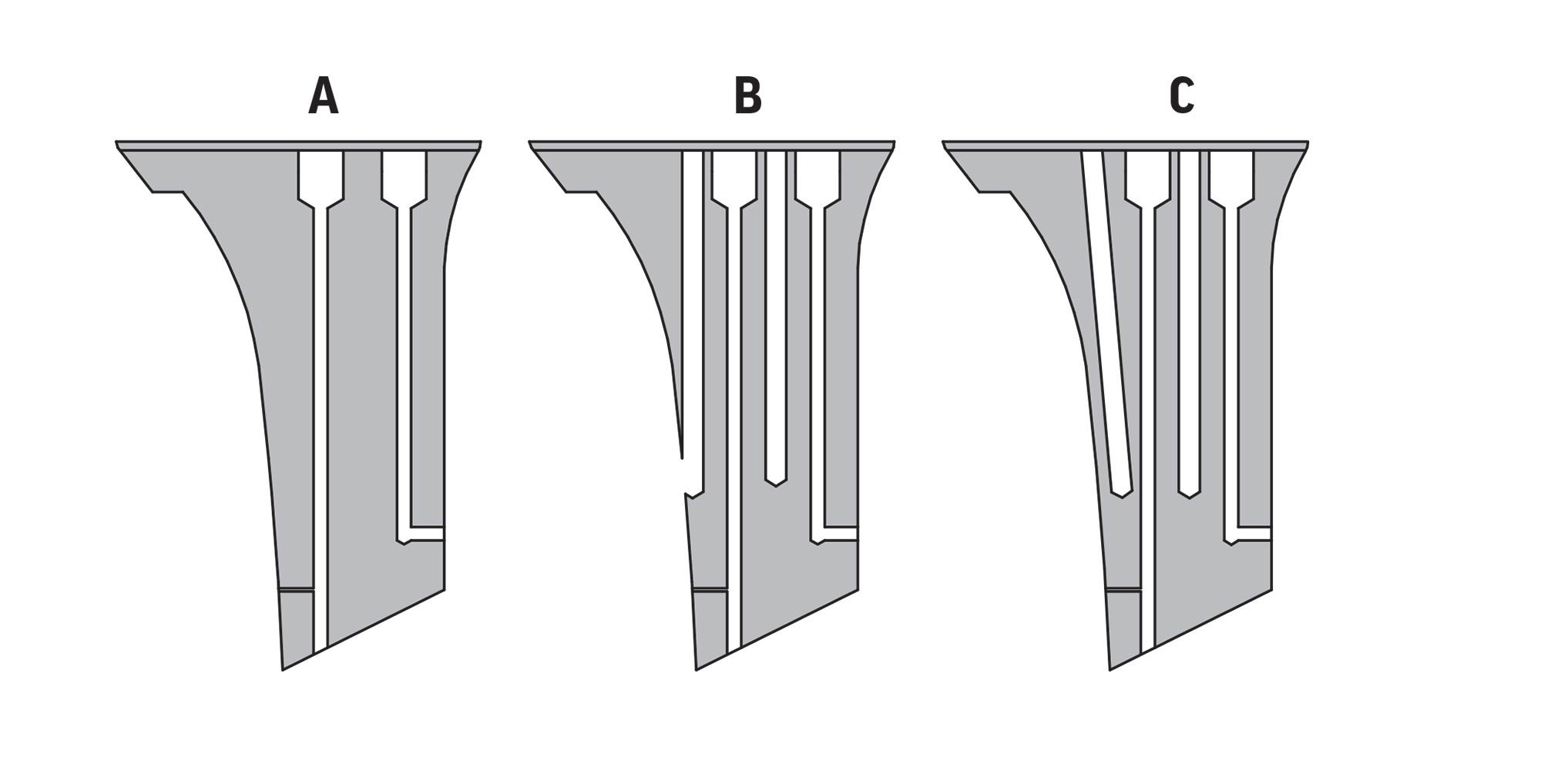

All variants of the design have part numbers 65797-XX and –XXX. To convert a 65797 casting (A) to a 59041-XXX heated variant (C), you need to drill two 3/16-inch holes at least 3 inches deep. Note how the hole adjacent to the static line must be angled, otherwise you’ll blow out the back side of the casting (B).
And it’s not just the shape that is the problem. At the 3-inch depth necessary to accommodate the CA464-356 (McFarlane part number) heater probes, there is barely 0.050 inch worth of material on either side. If you drill even the slightest bit off center, you’ll break out and ruin the part. As if that weren’t enough, the rearward hole has to be drilled at a 5° angle to maintain clearance between the static line and the back of the mast. If you make a mistake there, you could break out into the static line or the back side of the casting. In other words, there is little room for error.

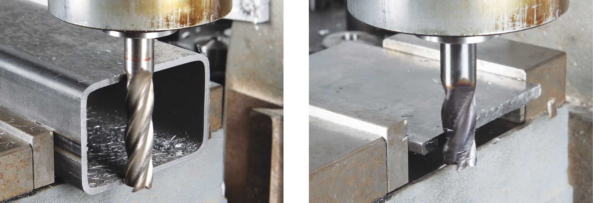

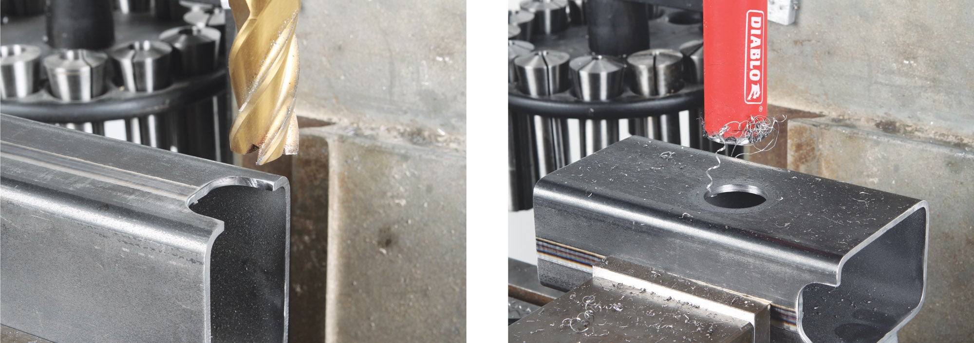

A 4-flute long-reach end mill was used to face the ends of the 2×3-inch steel tube for the stage (left). A shorter 4-flute end mill was used to square the ends of the top plate, which was 0.187-inch-thick steel, 3×4 inches (right).

Since the pitot mast casting was a bit longer than the stage, a clearance slot (left) was milled at one end so the casting would fit. A 1-inch hole was made slightly offset to one side of the stage to provide a “confirmation” window (right).
I often talk about how making a fixture can often take more time than the task itself, and this is certainly an example! The time it took to drill the holes was but a few minutes. But getting to where those holes could be drilled…that took up the better part of an afternoon!

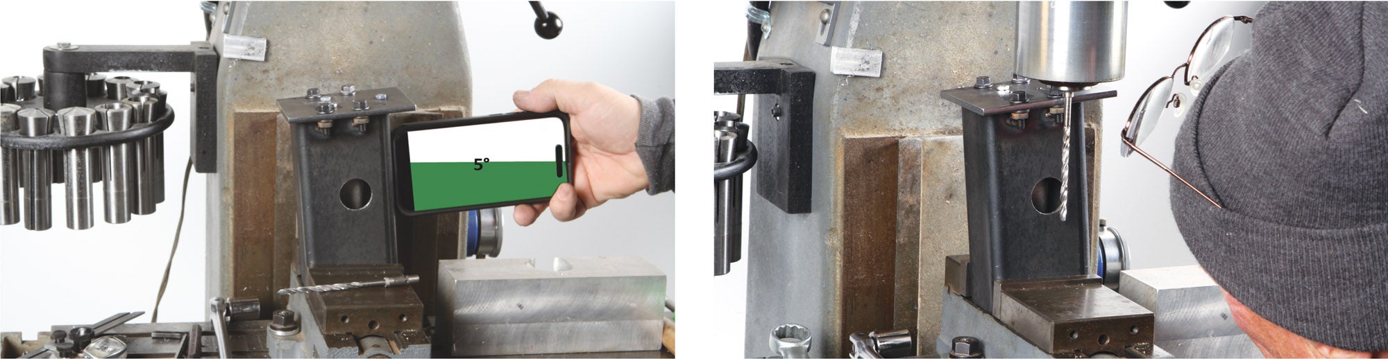

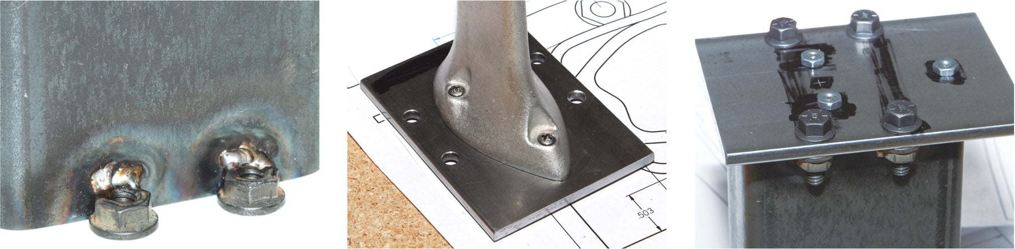

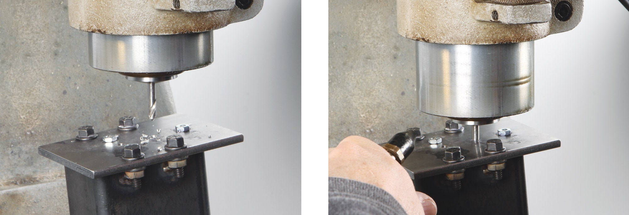

After a bit of discussion—and contemplation of what materials we had on hand—we developed a drill jig based on a length of 2×3-inch, 0.120-inch-thick rectangular steel tubing left over from the horizontal stabilizer jig Paul made for the F1 Rocket. This provided a “stage” to mount a top plate, which was designed to position the pitot mast on the centerline of the stage. With the top plate bolted securely to the stage, the mast was in perfect alignment for drilling.

Hex nuts were welded to the stage to secure the top plate (left). The top plate/drill guide was carefully marked and drilled to fix the pitot mast on the exact centerline (center and right).

After drilling the first hole, which was perpendicular to the face, the stage was tilted 5°, centered under the spindle and lined up with a center point marked on the top plate (left). The mill table was then cranked back, the long drill bit installed and the quill drawn down to visually confirm, via the window, that the part orientation and setup were correct for the angled hole (right).

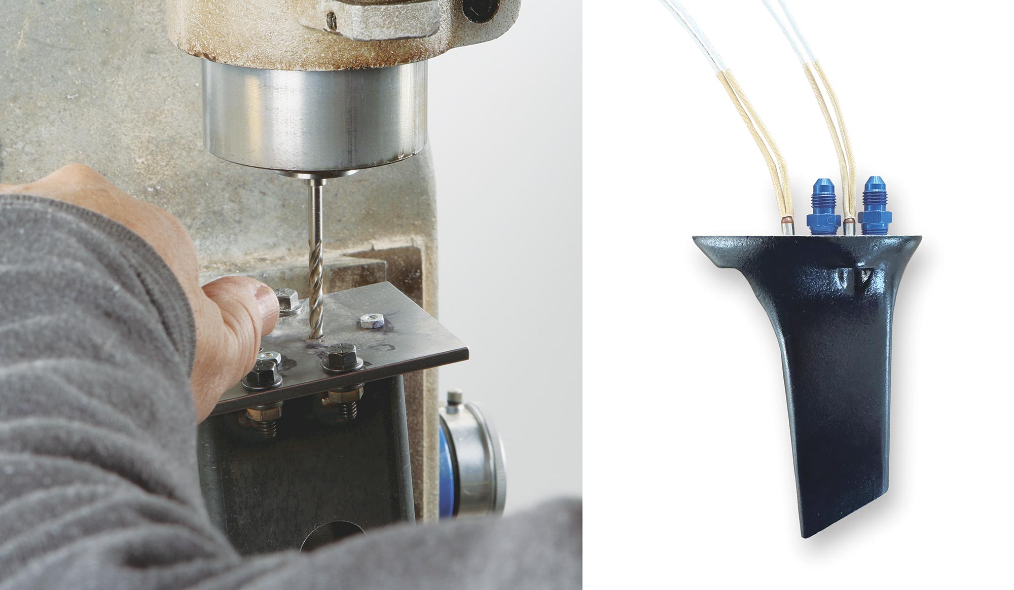

After confirming the angle and position, the hole was started using a short “stub” drill (left). Stub drills are more rigid than normal drill bits, which tend to deflect when entering a workpiece at an angle. Because stub drills have very short flutes, you have to peck drill (light material removal followed by full bit extraction) and blow out the chips between each peck (right). If the flutes of a stub drill get clogged with chips, it could seize up and break off inside the hole.

After going as deep as possible with the stub drill, it was swapped for a long drill (above). The same peck drilling procedure was used, primarily to prevent the drill from wandering off-line. Painted and ready for installation (right). A daub of heat sink compound on the heater elements completed the preparation. Photo: Paul Dye
