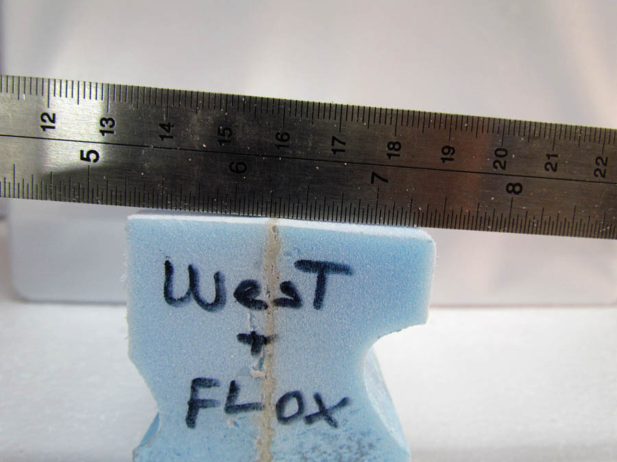

This project deals with several common problems we run into when building with foam or repairing foam structures. In the process of making a plug for a cowling, wheel pants, wing tips, or other fiberglass mold, small foam blocks are often glued together to make a large carving block. Before shaping begins, dents, divots, and uneven seams have to be filled. The block is then carved and sanded into the desired shape and finished before making a fiberglass mold around it.
When foam blocks are glued together with T-88 or an epoxy/micro or epoxy/flox mix, a hard glue line is produced that is difficult to sand or carve. Additionally, any glue that squeezes out of a joint is hard to remove without damaging the underlying foam. If large gaps are filled with an epoxy mix, considerable weight is added, and the thick section is even more difficult to sand true to the surrounding foam surface.

Electric carving knife zooms through Gorilla Glue/Spackle, foam, and seam.
sandable foam glue 08
Knife stopped by the epoxy/flox glue seam.

sandable foam glue 11
Epoxy/flox seam after sanding.
