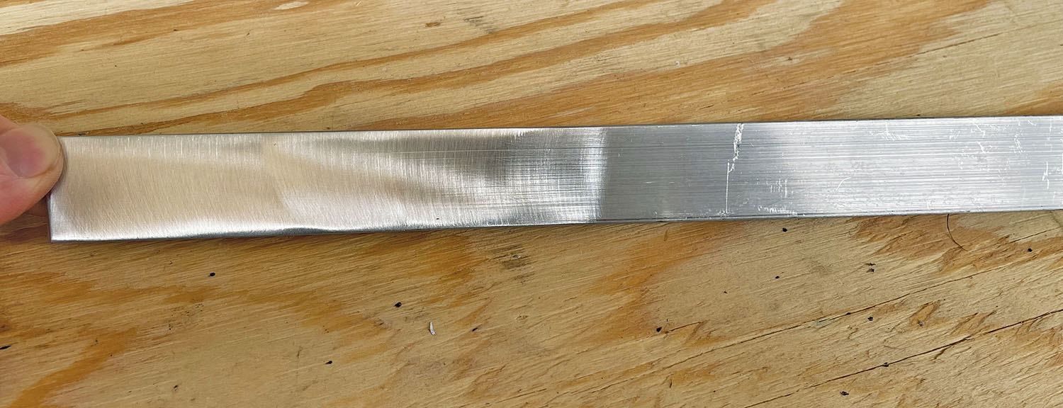

A bag of 2-inch pads and holder available from non-3M suppliers (above). Half of this aluminum angle has been quickly buffed (right).
Demonstrating the procedure for buffing is not easy without a video, but the results can be appreciated with photos. The result of just a few seconds of buffing can be seen in these pictures. While this is not polishing, it is the one step prior to that. Minute amounts of material are being removed in this process. The amount of surface conditioning is controlled by the pressure and duration of buffing. The grain of the metal (fine lines left over from manufacturing) can be removed entirely. Swirl marks will be left on the surface to some degree, depending on the skill of the operator.

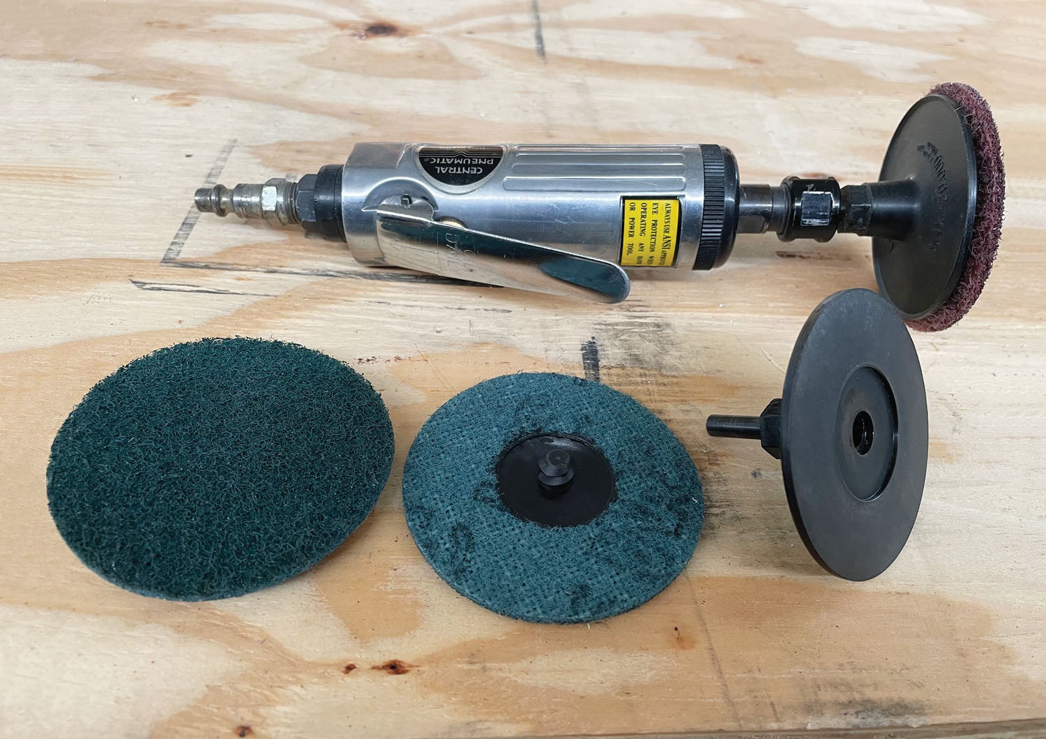

The tool that is required is a high-speed (usually air-powered) die grinder. The inexpensive variety from Harbor Freight is more than adequate. For those without a suitable air compressor, there are battery-powered high-speed versions also from the likes of Harbor Freight. Unfortunately, an electric drill will disappoint as the speed requirement is 10,000 rpm and above under heavy load.
The pads themselves are known as Scotch-Brite Roloc Surface Conditioning Discs. The Roloc part (3M invention) is the fastening system for the pads that is used. The pad is installed and removed with a quarter twist onto the holder. There is a plastic, threaded button on the pads that makes this happen. It is very easy and fast to change pads.
Since 3M has many, many varieties of pads that use the Roloc holder for sanding, grinding and finishing, it is important to specify when ordering that you want Scotch-Brite Surface Conditioning Discs with a Roloc TR attach system. Your local aircraft supply store usually only carries these as they know what you are using them for! However, if you order from an industrial supplier, you need to be specific.
Tools
An air-powered die grinder with a Roloc attachment holder and Scotch-Brite pads.
There are three popular grades of Scotch-Brite that we can use: Blue AVFN (fine), Maroon AMED (medium) and Brown ACRS (coarse). By experimenting with these grades, you can become an expert at eliminating swirls (or adding them for a decorative finish!) There are several size diameters for these pads, with 2 and 3 inches being the more popular. A simple holding device that accepts the Roloc pad needs to be inserted into your air tool. Select one that matches the diameter of the pads you are using.
While the 3M company is the original creator of this Roloc and Scotch-Brite system, you may or may not be surprised that there is a large market of third-party discs with the “same” material and disc attachment system. Where can you find these? Amazon, of course. Search for “Roloc pads.” As you can imagine, the prices are substantially less than the 3M equivalents. You get what you pay for, but I have found them to be a good value. Angle
