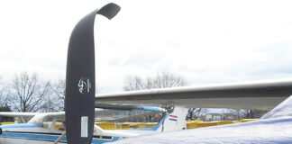

After a prop strike, a crankshaft should be magnafluxed to detect any hidden cracks. Merely checking the straightness or runout of the crank leaves many possible problems undetected. (Photo: Light Plane Maintenance)
Prop Strikes
While perusing the logbooks be sure to look for entries that would suggest a prop strike or some other mishap. This is why it is a good idea to look at not only the engine logbook but also the prop and airframe logbooks. A repair or replacement mentioned there may suggest engine damage that was not properly repaired or even logged. Many engines are not torn down and inspected after a prop strike, even though it is required by both Lycoming and Continental. Note that Rotax has different guidelines for dealing with prop strikes due to their gear reduction systems.
Prop strike engines sometimes become available at very attractive prices, but generally should be avoided unless the required inspections and replacements have been performed, in which case they wouldn’t be advertised as cheap prop strike engines. An unexamined prop strike engine is worth less than a core engine, in this author’s opinion. It may be worth something, but you have no way of knowing without tearing it down. What you find when you do can be very expensive to fix.
