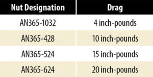

maintenance 12The question often arises, “Do I need to adjust the torque to compensate for the nylon insert drag?” The answer is yes. The torque used to overcome the drag of the locking insert does nothing to tighten the nut you are using. Here are some drag numbers derived from testing a number of new stop nuts.
