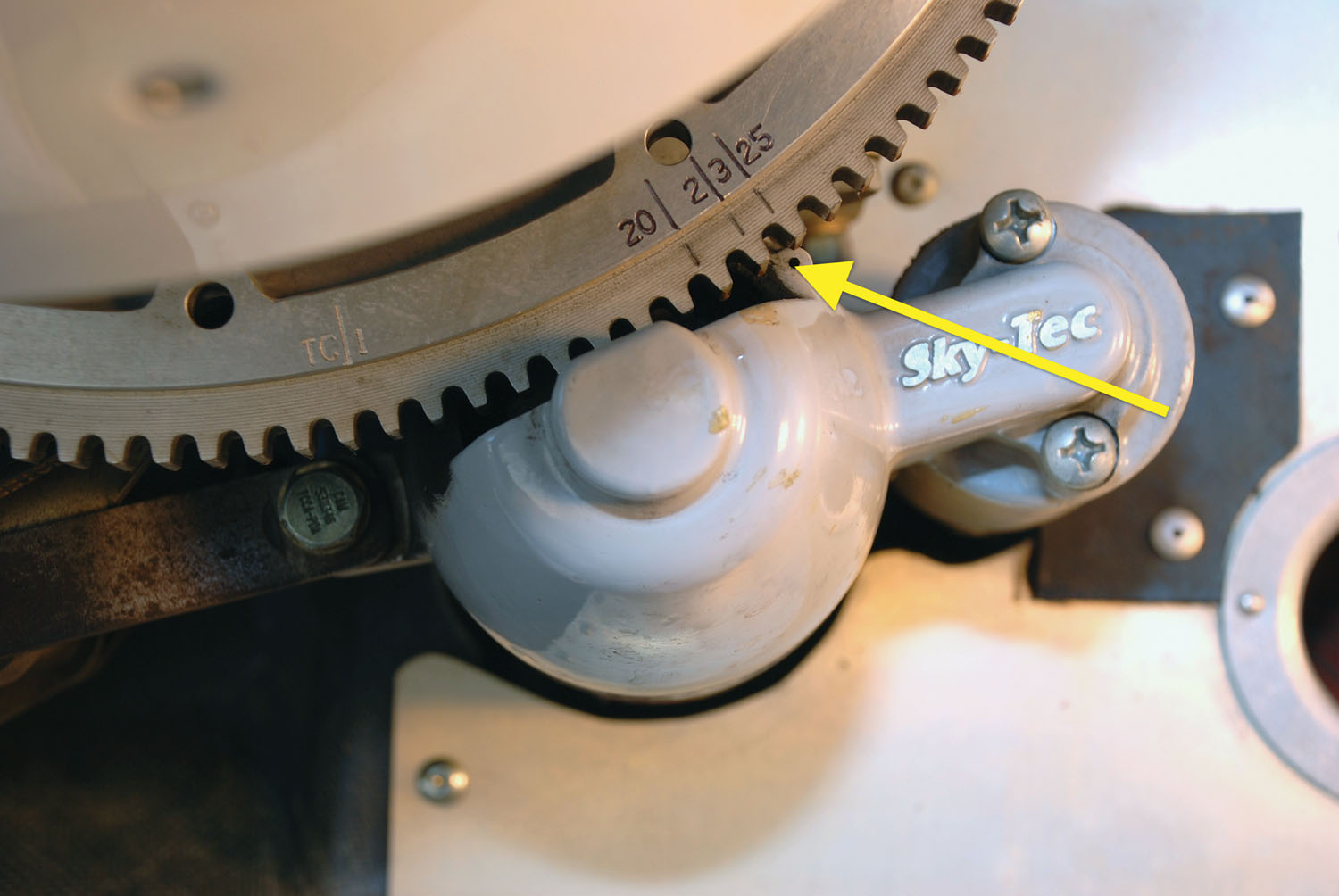

One set of timing marks is on the front side of the starter ring gear. Line these marks up with the 1/16-inch hole in the starter housing (see arrow). As an option a small pin can be inserted in the hole to make it easier to line up with the marks.

External timing is adjusted by rotating the magnetos until the precise timing is achieved at the Number 1 cylinder (front right on Lycomings). To do this, first remove at least one spark plug from each cylinder. This is vitally important because you will be turning the propeller with hot mags that could cause a cylinder to fire and thus severely injure you.
With the spark plugs removed, turn the engine to the firing position for Number 1 cylinder—typically the 25° mark, but be sure to check. Hold your thumb over the open spark plug hole to be sure the cylinder is on the compression stroke. Now turn the starter switch to the Both position or disconnect both P-leads. Then connect magneto timing box to each magneto P-lead and to ground. Next, turn the engine in the normal direction of rotation past the timing mark until you hear the impulse coupling click. It is not subtle, so you shouldn’t have a hard time hearing it. Then back the engine up to a position before the timing mark and re-approach the mark in the direction of normal engine rotation, stopping at the mark. In a perfect world, both magnetos would be in the firing position and your buzz box would be buzzing, but such is not likely to be the case.

  2. Readers should be aware that the Sky-Tec XLT starter (For Lycoming) does not have a timing mark. Timing will need to be done using the upper crankcase seam and the marks on the aft side of the flywheel. Since I had a baffle that was in the way, I riveted a small angle on the face of the baffle, in line with the crankcase seam, and when timing, temporarily install an aluminum pointer on the angle with clecos. Works great! Picture: https://www.flickr.com/photos/baditude_rv-4/4961952200/in/dateposted-public/
