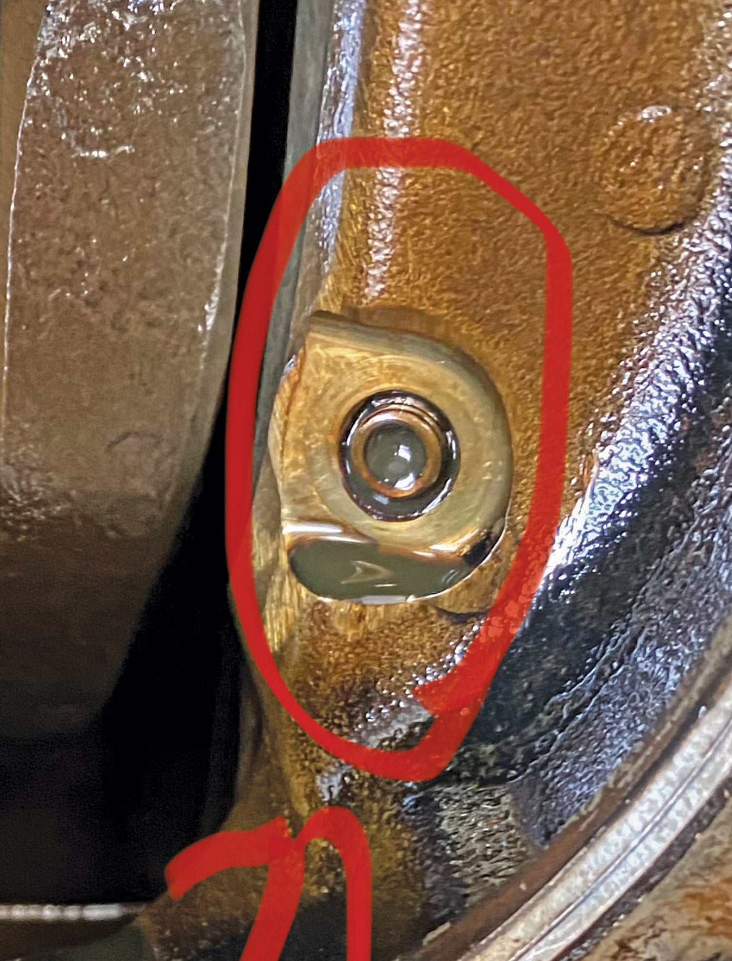

piston squirter galley
This is the galley into which a piston squirter should be installed. Its purpose is to squirt oil at the base of the piston, which should have stopped the connecting rods from overheating.
Cylinders 2, 4 and 6 were removed first. They all showed that there was no choke left in any of the cylinder bores, with some excessive pitting (Yes, there were some periods of inactivity of the aircraft, and it is routinely based in Florida). The connecting rods on cylinders 4 and 6 were severely burnt, and the piston squirters were not installed. Piston squirters are usually installed in high-compression engines to squirt oil at the base of the piston to help with heat. Now the engine pretty much needed a complete teardown.
