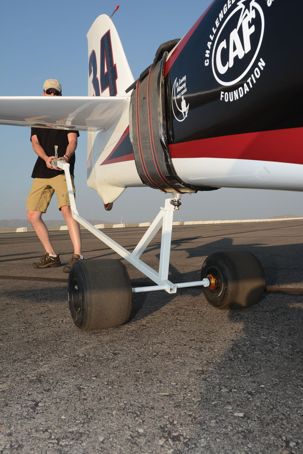

Racers tow their airplanes all over huge airports using dollies and trucks or golf carts. Jon Latall demonstrates the Limitless team’s nifty dolly here; it features a padded strap around the fuselage with ratcheting straps and pivots on a rod end bearing. The dolly turns far better than the fixed tailwheel.
Save for the reality that few projects—and absolutely no racing machines—are ever finalized, the last steps before trailering Limitless to Reno in 2018 for its debut race and what turned out to be its debut win were the installation of intersection fairings and the final surface finishes. Most involved of these were the wing-to-fuselage fairings, followed by the vertical tail and wheel pants. Just before Reno the fuselage was vinyl wrapped. As an expedient, the sponsor’s logos were added on top of the base wrap, but in the future the logos will be incorporated into the main wrap, thus saving numerous exposed edges. Of such things race wins are made.
