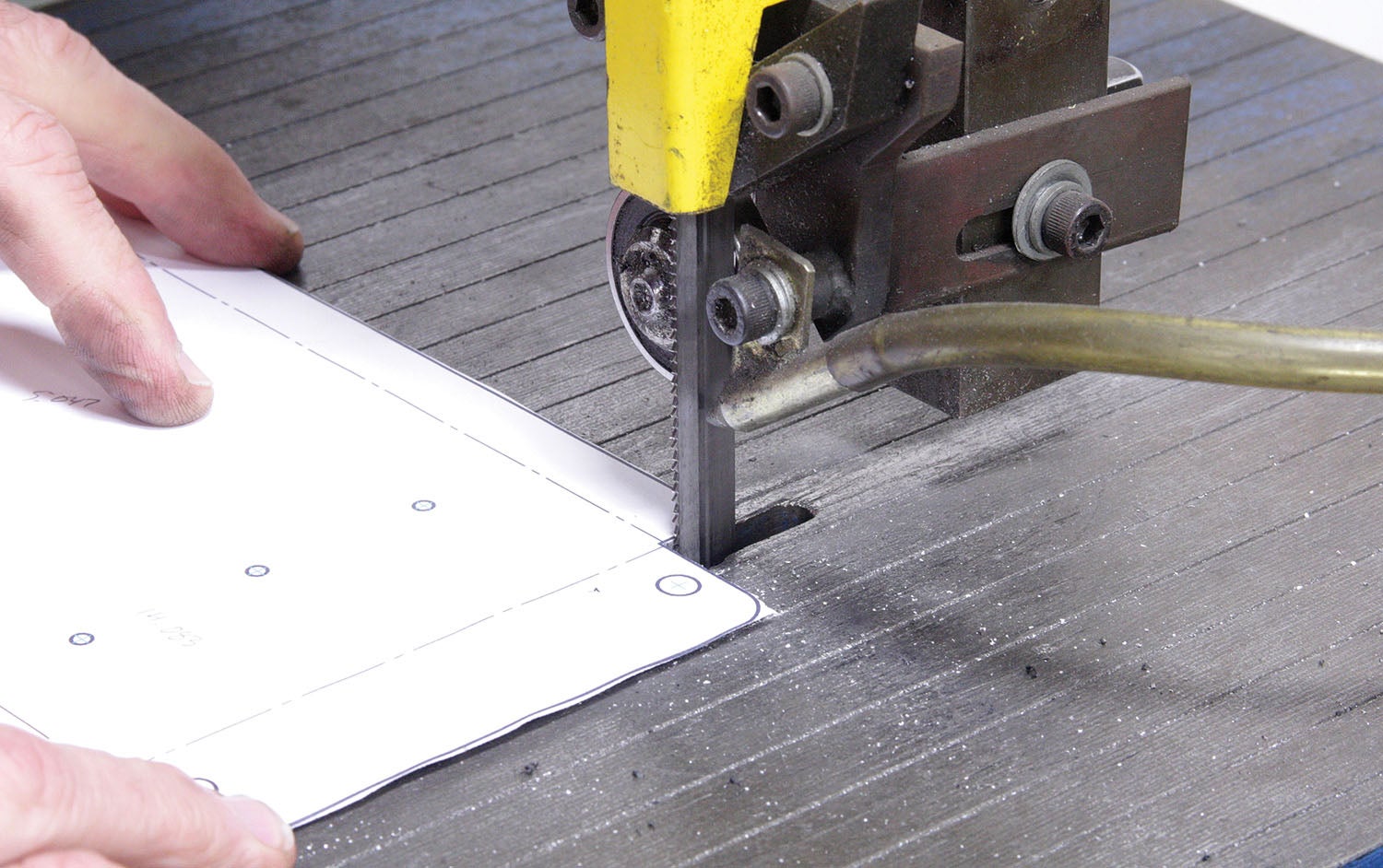

The tools and construction techniques for the project included lathe work for the bolts and pins, mill work with the indexer for the aluminum pivot bolts and nuts, basic tap and die threading, sawing, some drilling, sheet-metal bending with a pan and box brake and TIG welding.
Like many of my “not going to the moon” projects, I designed my stepladder based on material I had sitting around the shop. I happened to have some 1×1.8×0.062-inch rectangular 6061 aluminum tubing that was originally extruded for a mountain bike frame. I used this material for the legs. Since no one is likely to come across this particular tubing, I changed the drawing to make the legs using standard 1x2x0.062-inch 6061 aluminum rectangular tubing.Photo 4 bandsw pattern
The top was made from 12x24x0.073-inch aluminum diamond tread sheet from Home Depot. Like the leg material, this was a leftover from another project and not purchased specifically for this stepladder.
The stretcher braces and reinforcing channel for the top were made from 0.040-inch 6061 aluminum sheet. The pivot bolts, nuts and alignment pins were made from 6061 aluminum bar stock.
Photo 5 Bend 1
With the paper pattern still adhered to the smooth side of the diamond tread sheet, the sides and ends were bent using a pan and box brake.
