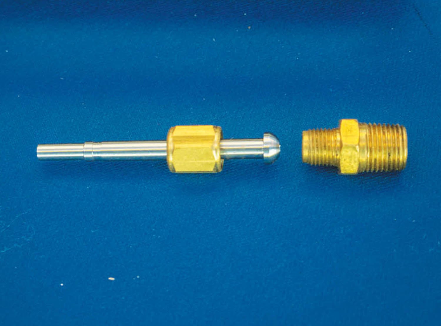

ASF extends the stem on its ball-end primer and injection lines and can bend them to any angle a customer needs

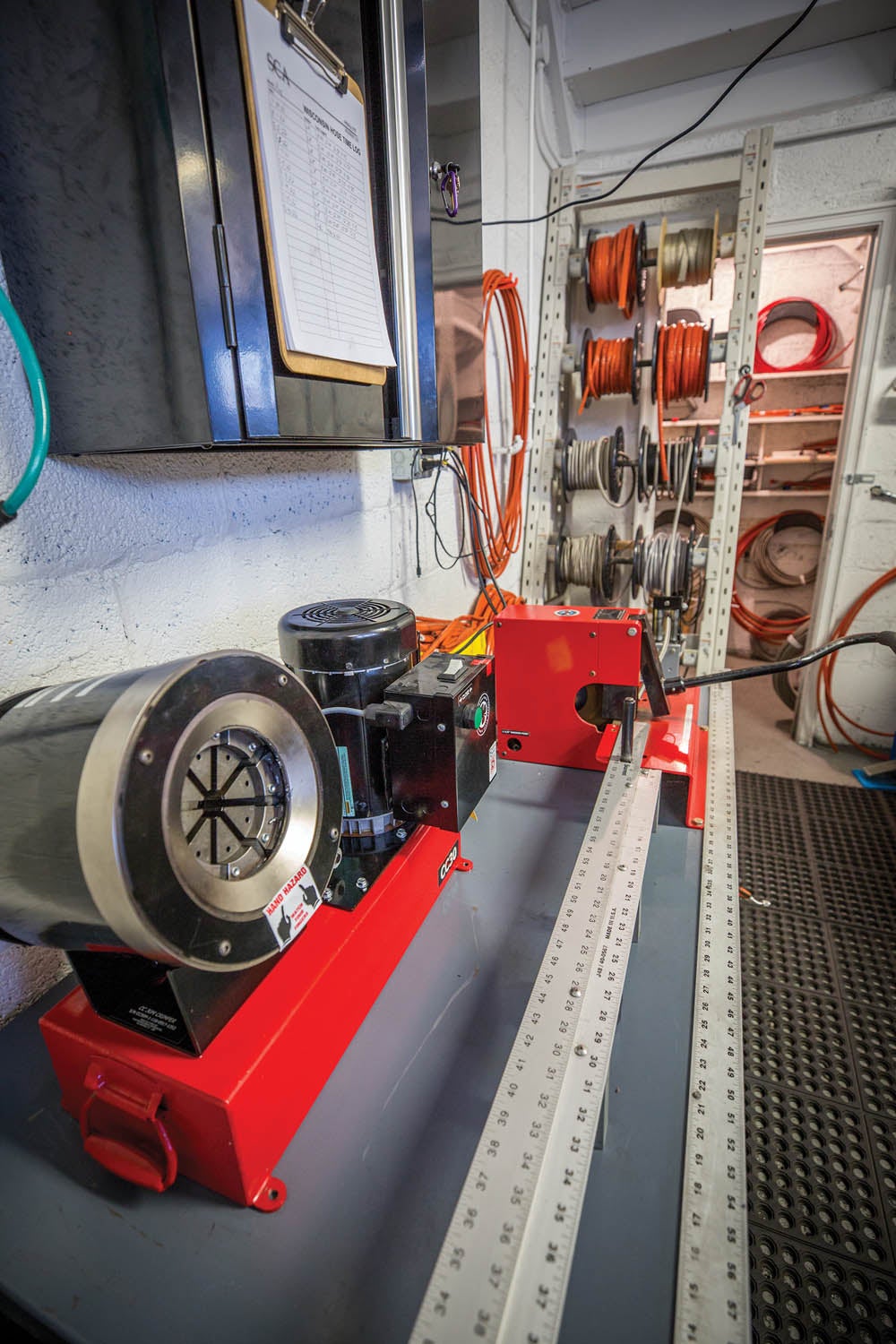

Picking up another fitting, he explained that the stem matches the diameter of the hose and is held in place by a crimped collar. With proprietary dies, the CNC crimper sizes the collar perfectly. A Bluetooth digital micrometer calibrates the crimper, which automatically and continuously adjusts for springback.
Connected to the stem are the flare and nut that connect the hose to the aircraft component. “Because we make them in-house, we can put anything we want on that stem, so we are not limited to making just AN hoses,” he said.

Along one wall is the CNC hose crimper that uses proprietary dies (left). A third corner of the prototype shop is home to a CNC router, which is next to the CNC laser etcher (right).

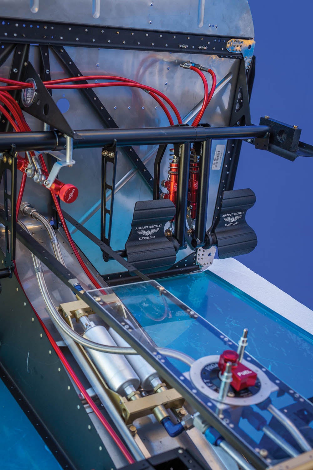

The SDS automotive fuel injection kit mounts dual electric fuel pumps in the tunnel between the seats. “We manufacture a new valve bracket, mounting plate, tunnel cover and necessary hoses and tubing.” Another kit moves the fuel filter from the cockpit tunnel to the wing roots, complete with shutoff valves for mess-free filter changes. Another option is plumbing systems for fuel tank selector valves, with different ergonomics.
Naturally, all the tubing is CNC bent and pre-flared. Another kit combines pre-bent rigid tubing with flexible lines that provide the necessary geometry without the frustrating gymnastics of snaking a 4-foot rigid tube into a tight space.
“We use rigid tube to provide the necessary geometry in tight spaces and connect flexible hoses to them. This is a full duplex system with a fuel feed and return. The fuel flows from the tank to the valve to the engine, and the duplex valve has a line that returns the excess fuel to the tank it came from so it won’t overflow. All builders have to do is put the pieces in the airplane and connect the fittings. They can plumb their entire airplane in an afternoon.”

Next to the stockroom, the hose corner of the production facility measures, cuts and crimps hoses.
With silicone cuff seals at each end, the premium firesleeve is silicone that’s extruded onto the hose itself, said Tschurwald. It weighs about the same as the standard sleeve, but it costs roughly 15% more. “To get an integrated firesleeve in the past you had to buy an expensive FAA-certified product. Since we serve the Experimental market, we went to our hose manufacturer and asked for essentially the same hose. Because of our volume, we can make premium hoses at a small upcharge over a standard firesleeve hose.”
ASF’s assemblies are crafted from hoses with Teflon liners that are impervious to fluids, so they are not time- or life-limited. “They are also lighter, stronger and more flexible than rubber 303 hoses, which have thicker, heavier walls that are less flexible,” Tschurwald said.
