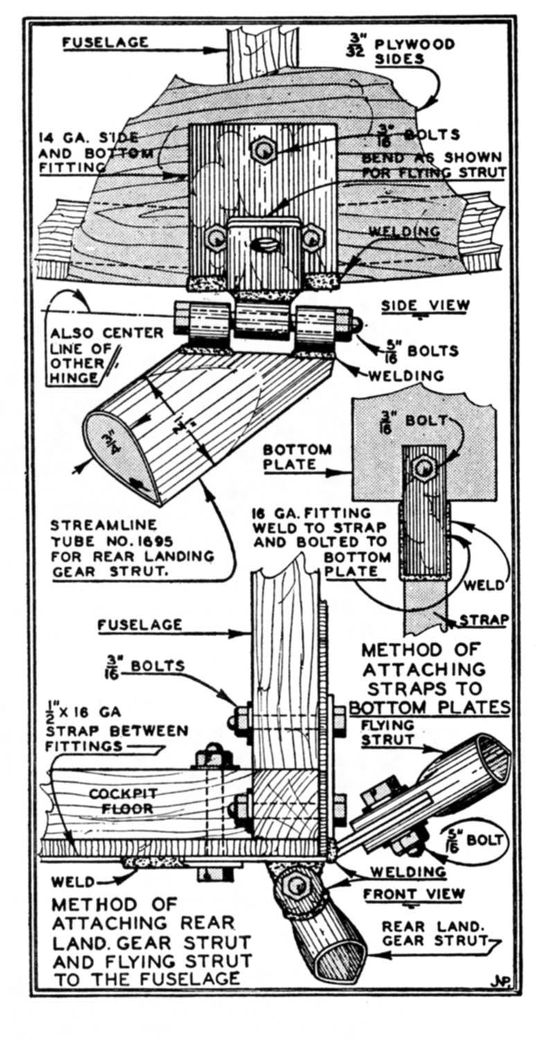

Sky Scout Plans BT FORES
To today’s builders, these plans may seem to lack detail, but everything needed is there—the diameter of the bolt. The bolt’s length, washer usage and nut type are all dictated by best practices.
