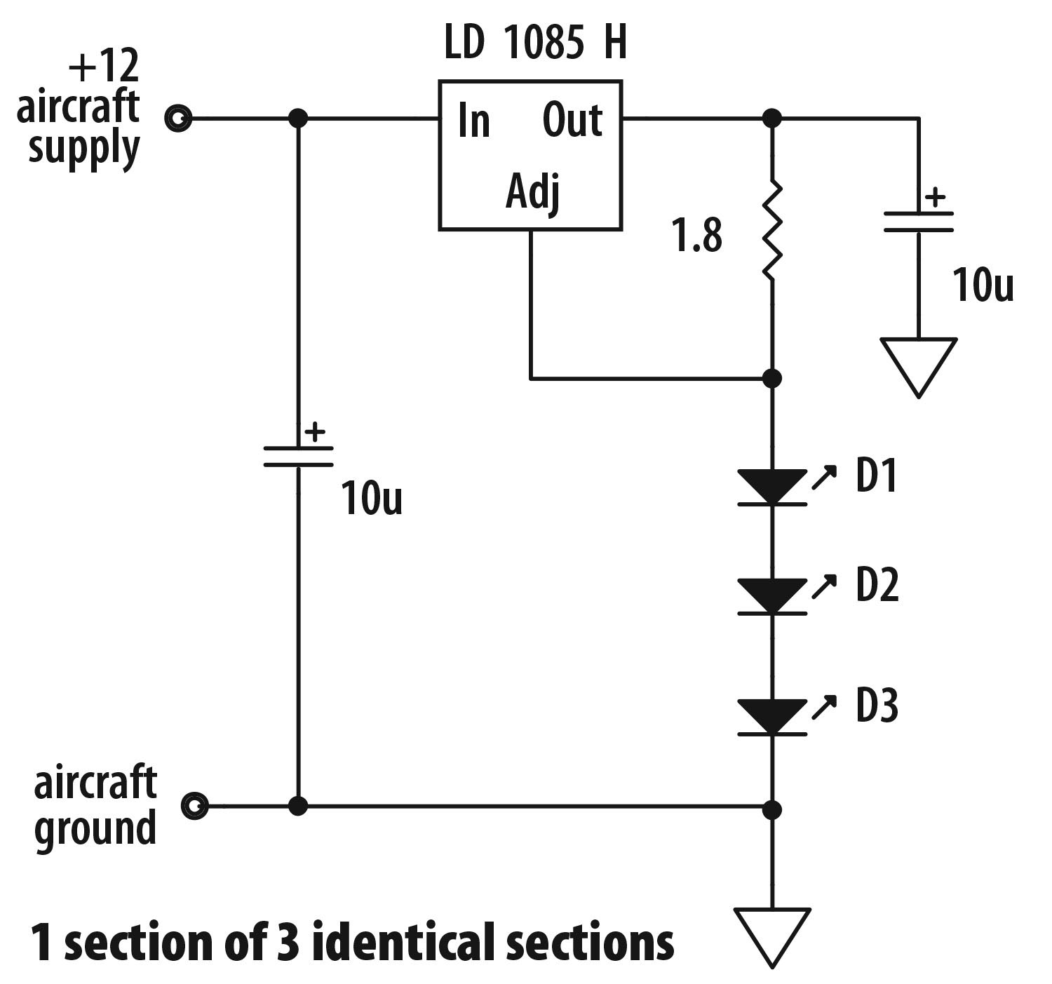

KPsch
The electrical schematic of the LEDs and driver.

One way of solving this problem is to convert a voltage regulator into a current regulator. This is a fairly simple thing to do with an integrated circuit regulator and a single resistor. Using a regulator chip in a plastic package means that we can bolt the regulator directly to a metal chassis without using a separate insulator, fiber shoulder washer, and all that folderol.

  1. Now I’m confused. I don’t have a CLUE what RF1 is, and I said IF I was going to use a resistor it would be 6.8 ohms. I went on further to say if I converted a voltage regulator into a current regulator I could do it with the voltage regulator and a current sensing resistor of 1.8 ohms. I have no idea what 2.6 ohms is or where it came from.
    The 1.8 ohm resistor that I used with the voltage regulator comes from the regulator’s internal reference voltage (1.25 volts) divided by the current required (700 mA or 0.7 amps). 1.25/0.7 = 1.78 ohms. The closest standard value to 1.78 is 1.8 ohms.
    Thanks for reading. jw
  2. Jim, agree with your answer, thanks! My confusion is with your picture with the nine LEDs. It looks like the color code of the resistors is red-blue-gold….which I read as 2.6 ohms. Clearly I am confused! Your help is appreciated. Thanks again.
