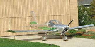

It started with a visit with the Rutan guru Robert Harris of what was the EZ Hangar in Covington TN, now EZ Jets. I wanted to build a Long Eze but Robert suggested using current information and technology instead of 1977 when the plans came out. From then on, this airplane was not a Long Eze… it became my design. Originally I wanted an IO-360 in it and progressed this route. Then Robert said “why not make the fuselage bigger for a real sized person?”
The fuselage is 4 inches wider right down the middle, 6 inches longer in the rear seat. The center section spar and wing are from the E Racer, modified of course. Outside it looks the same, but the internal structure is different. Blended winglets structurally integrated with the wing spar. The canard is a GU canard modified for stiffness. The gear is moved aft 1 inch so it will safely sit on all 3 wheels without anyone in it. Oh yea, it stands a foot taller than a Long… noteworthy if you fall out of it like I have… twice. The floor stopped my fall both times.
You’ll notice I don’t have one of those spinny things on the back. We went jet. It’s a GE-T58-8 engine modified to pure jet. It puts out about 840 lbs of thrust. For you guys with the spinny things it’s about 600 hp. It pushes it along doing 190 knots true in the climb at 2500 fpm all the way up to 17000. Fuel burn drops to 31 gallons per hour doing 250 knots true. It carries 24 gallons in the two inboard pods and baggage in the outboards. All total I can carry 160 gallons…enough to go 4.5 hours with a reserve or you bladder, which ever occurs first.
The goal was to have a simple jet which flies like a Long Eze. Goal achieved. It’s simple to operate but the systems to achieve this ended up being rather complex. It comes off at 80 kt when heavy and over the fence at 80 kt on all landings. It’s not harder to land than a piston type aircraft, just different because of the engine. The time lag from idle to power can be up to 4 seconds. It just takes planning.
