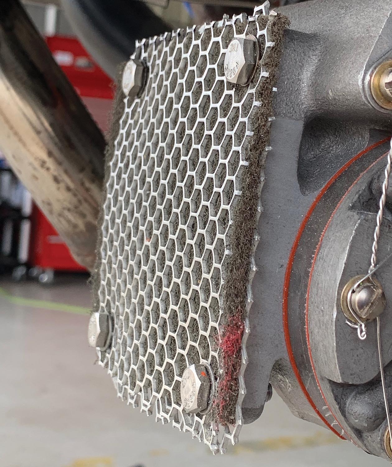

No Scotchbrite
It is important that the right filtration medium is used. The example pictured here of Scotch-Brite being used is kind of scary. Scotch-Brite is very abrasive, and it tends to fall apart while you are using it. Can you imagine what it is doing to your cylinder walls as it breaks apart and sheds right into the intake system?
