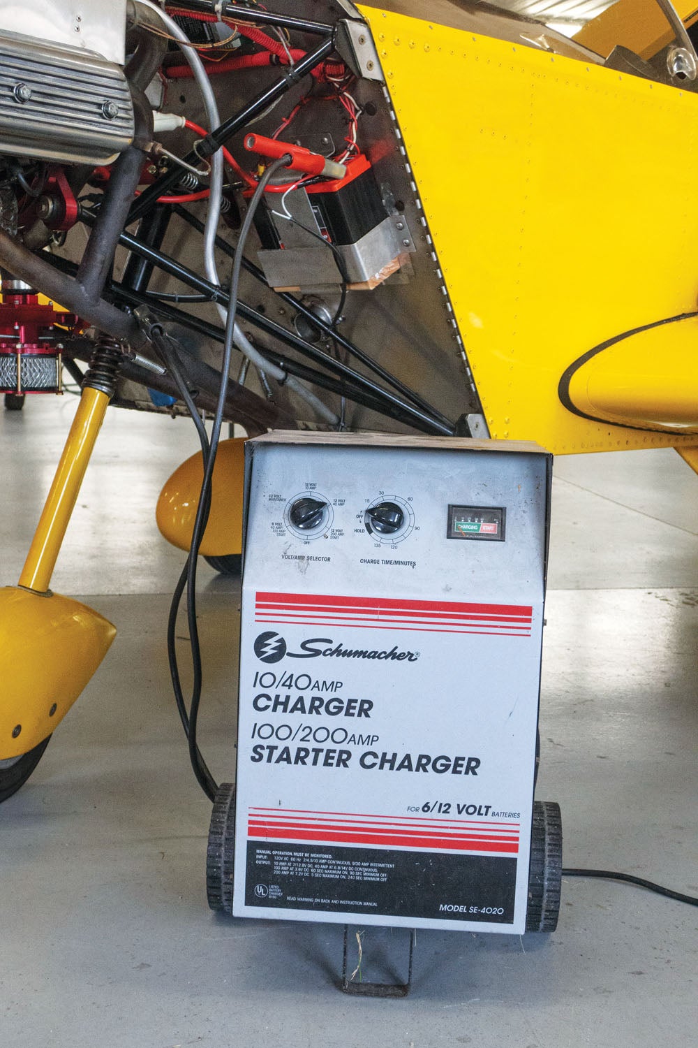

Battery Large Charger FORES
The days of “dumb” battery chargers, like the one shown here, are behind us. Your airplane battery deserves a modern maintainer suited to your specific battery.

All of this should make it obvious that using a 40-year-old Sears battery charger to charge or “maintain” a battery, any battery, is poor form.

There was a day when a weak or dead battery was met with a suitcase-sized battery charger whose charge level was set commensurate with the need to get a vehicle started. Setting the amperage switch to the Start position would jolt the battery, and therefore the vehicle, with enough amperage to animate a toy truck. And off we went, likely to be stranded with a still-dead battery at our destination. If we had time, the switch might be set to the 5- or 10-amp charge position and the battery left to charge longer. Maybe even overnight. We’d return to the smell of sulfur and a hot, somewhat bloated battery that’s boiling inside. In either case the battery has been damaged and its life effectively ended. Even the trickle-charge setting on the old chargers, used to “maintain” a seldom-used battery, fed a low-but-steady diet of amps to the battery, regardless of the battery’s need, with similarly destructive results.
