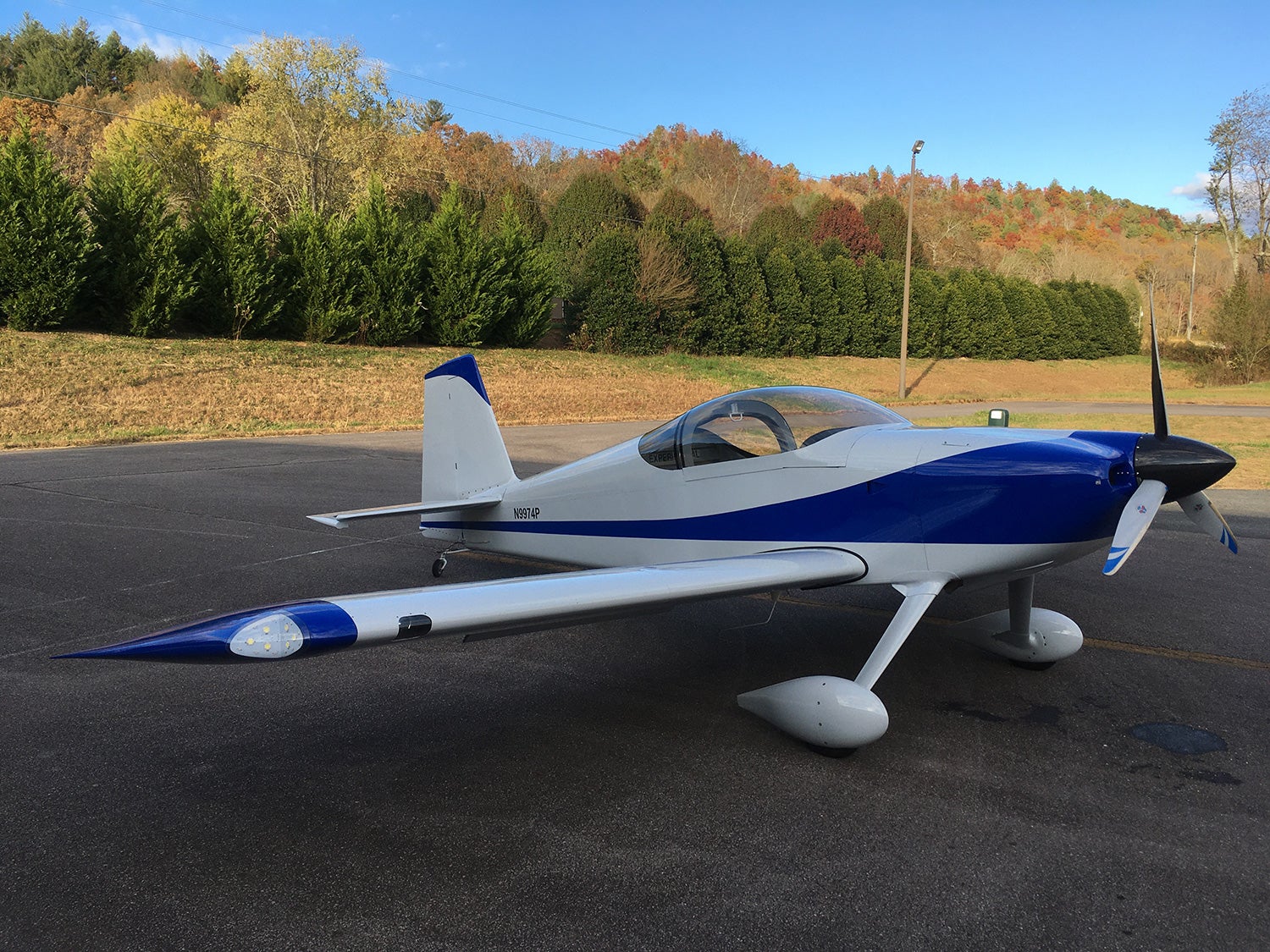

This is my RV-7 (N9974P) that was completed in August 2020 and given its airworthiness inspection by Vic Syracuse. I performed the first flight on September 1, 2020. It is a slow-build and took 13.5 years to complete while keeping up with all of the great family activities of raising two daughters.
It is day/night VFR with the following installed: GRT Sport EX, uAvionics Echo ADSB with GRT Safe-Fly GPS, GRT EIS 4000, Garmin GTX 327 Transponder, Garmin GTR 200B Com, Fly LED Navigation/Strobes, Catto prop and spinner, Lycoming IO-360-M1B, and Flightline Interiors seats, paint was completed by Justin Griffin. It came in at 1055 lb with paint. The plane is based at Western Carolina Regional Airport (KRHP).
