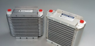

Huge primary oil cooler holds nearly five quarts. The sump holds eight more.

Lower inlets feed the oil cooler and air-to-air intercooler.

It’s safe to call the CD-230 and CD-265 “oil cooled engines,” as they shed about 2/3 of their waste heat via a dedicated oil system with its own pump, separate from the lube flow. The required heat exchanger is huge by conventional standards. An off-the-shelf unit from the Cessna Skylane STC wouldn’t fit, so Pacific Oil Cooler built a custom unit, which was plumbed in series with a normal sized cooler to meet the total capacity requirement. The cooling oil flow rate (15 gallons per minute) requires -12 lines (3/4 inch). The auxiliary cooler was ducted to provide cabin heat, as the oil system is always above 150 F in flight. Pacific built the air-to-air intercooler too. The oil itself is full synthetic, currently an experimental Phillips 10-40 obtained via Continental, along with an equally experimental Tempest filter. Synthetics work very well, as there is no tetraethyl lead in Jet A.

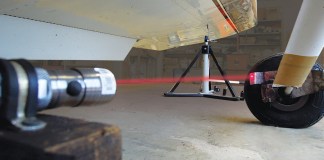

Flandermeyer’s number one developmental goal is weight loss. Van’s Aircraft publishes an RV-10 empty weight of 1600 pounds, but the Van’s demonstrators are famously spartan. Most RV-10’s fall into a range between 1675 and 1750 pounds, as owners tend toward leather interiors, loaded panels, and air conditioning. N104ST tips the scales at 1917 pounds empty, which is portly, but the excess isn’t strictly due to the engine itself. The avionics are extensive, and more than one cow contributed to passenger comfort. The SafeAir1 extended range fuel tanks add 7.5 gallons per side at a cost of 15 pounds. A stock Van’s cowl is about
21 pounds, but 104ST’s cowl is a cut-and-try prototype, full of extra glass and filler. It weighs a whopping 37 pounds, plus the internal glass ductwork for the coolers on both sides, and may get even heavier with the next cut-and-try.
Going forward, the cowl and ducts will probably change to carbon with the CD-265 install. Hartzell’s “Next Gen” foam core carbon blade should be significantly lighter, as compared to the MT’s wood core; a spokesman says they are committed to the CD-265. Replacing the lead-acid main battery with a pair of EarthX LiFePO4 batteries in series will chop another 20 pounds. An additional 18 pounds of aux batteries (ensuring electrons for IFR with the all-glass panel) are also subject to change. Still, it’s impossible to eliminate the entire diesel weight penalty. Compared to a parallel valve 540, the core engine and required coolers total as much as 80 extra pounds. The near term goal is 1850 empty.
As you see it here, full main tanks (60 gallons of Jet A), two standard humans, and 35 pounds of baggage puts N104ST at the Van’s-specified gross of 2700 pounds. Flandermeyer considers minimum fuel to be 5 per side, leaving 50 useable. Cruise fuel burn at 90% power (which is perfectly fine) works out to be a fuzz less than 11 gph, or 4 hours plus a VFR reserve, plus the captain’s 10 gallons. The full 90% (207 hp) is available to around 13,000 feet, where true airspeeds are high. Fill the aux tanks, load a pilot and 100 pounds of gear, pull the power back to 55%, and endurance becomes more than 10 hours with a VFR reserve.
