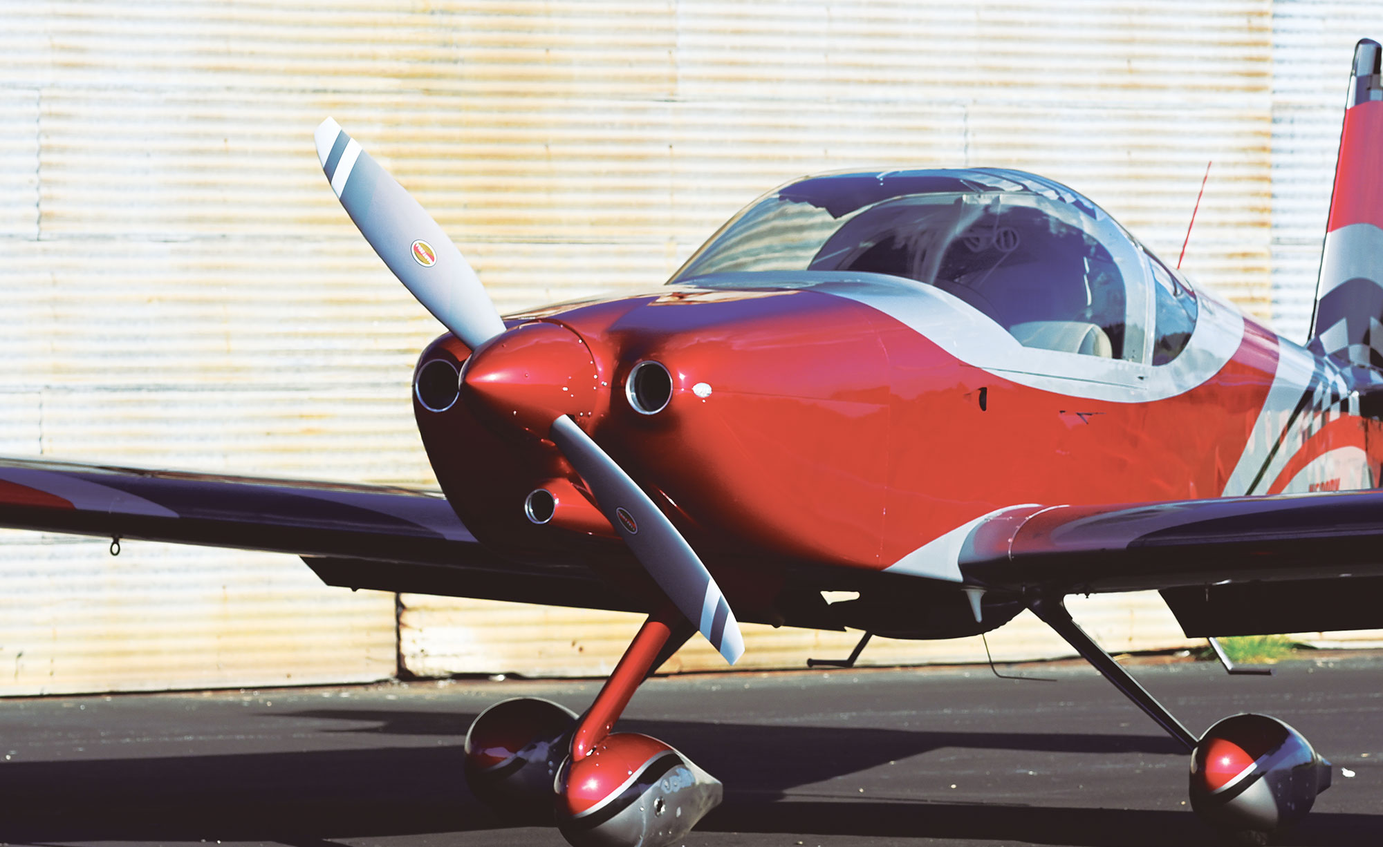

An example of James Aircraft’s current work appears on Jim Sackreiter’s RV-14A, featuring circular inlets and a full plenum system inside.

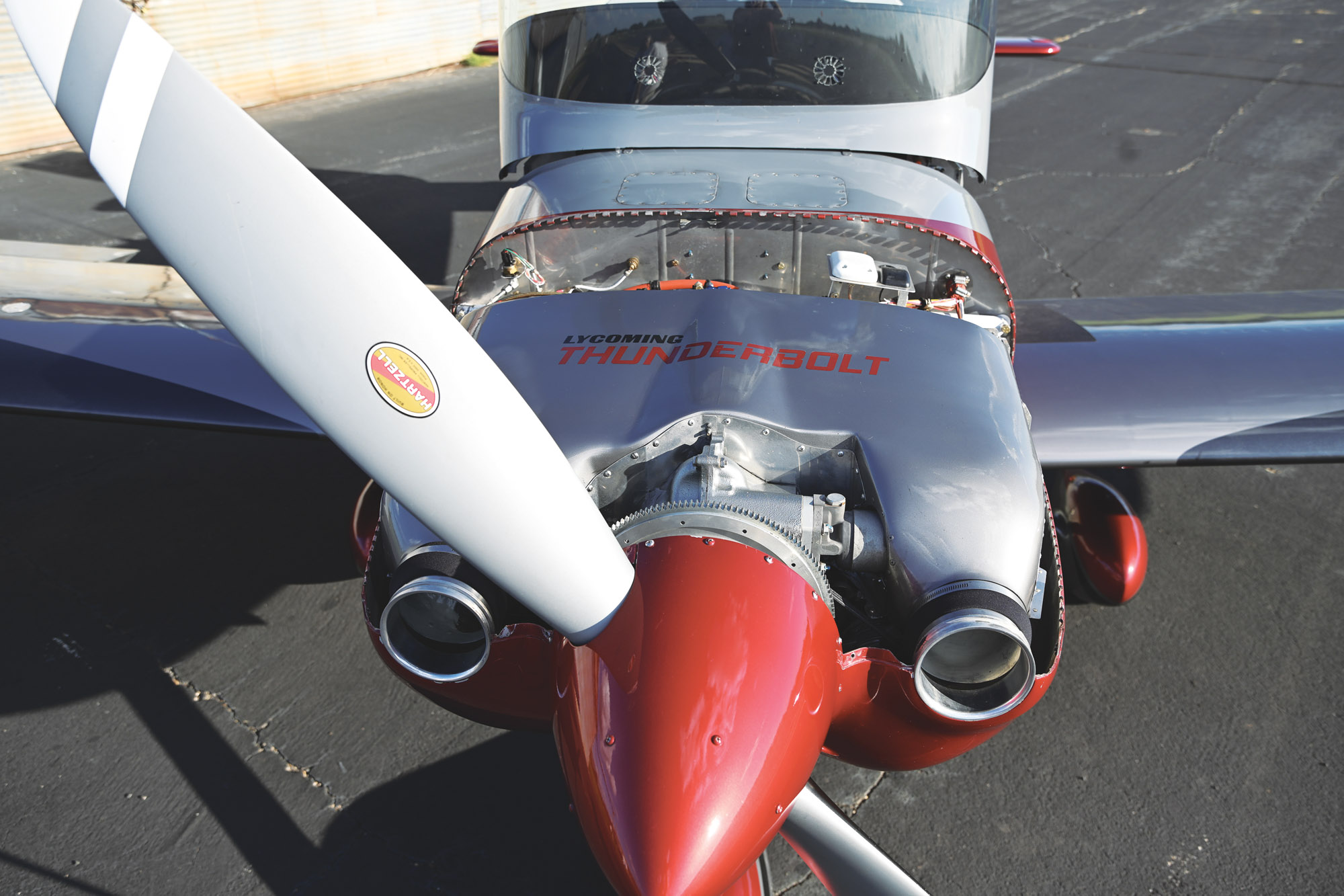

A plenum on a piston engine aircraft is an enclosure around the engine that helps air circulate for the purpose of cooling. They are typically made of aluminum or fiberglass and are designed in conjunction with air inlets and baffles to hold the air around the engine at a higher pressure than the surrounding air. This pressure difference allows the air taken in from the inlet(s) in the cowl to move evenly past the engine’s cooling fins at a speed and volume that keeps the engine at an appropriate operating temperature.
james aircraft 005
The James Aircraft plenum system is reportedly more efficient than a conventional open cowl, resuling in better performance, improved cooling and no more “cowl bulge” at speed.

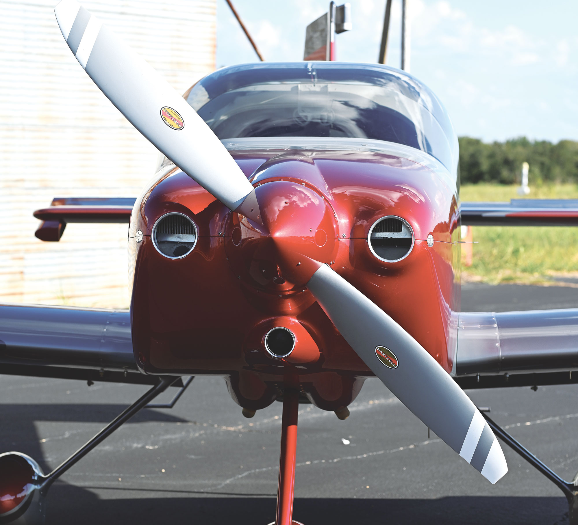

  • The cowl’s air intake(s) must be sized to allow enough air for sufficient cooling but not so large as to unnecessarily disrupt the airflow over the cowl and increase drag. The overall shape of the inlet can also make a significant difference in drag and the volume of airflow. James Aircraft’s Jimmy Cox uses round inlets that are smaller than the stock RV ones to minimize drag.james aircraft 004
  • An efficiently designed plenum moves the lowest volume of air possible around the engine for sufficient cooling. Excess air in the plenum can overcool the engine, contribute to drag, escape into the engine compartment and disrupt the flow of air through the cowl. Cox says the cowls on many RVs bulge outward at normal cruising speeds because the design of the stock system allows air to slip out of the plenum.
  • Baffles are ridged skirts of aluminum or fiberglass placed in such a way as to guide or block the flow of air through the plenum and cowling. They typically have soft, rubber-like seals to stop air movement where they mate up with the cowling. Their design and placement are key in the balance between the volume of air flowing through the plenum and cowl, the speed at which it’s moving and its temperature. The baffles on the plenums from James Aircraft fasten to the plenum to minimize leaks.
