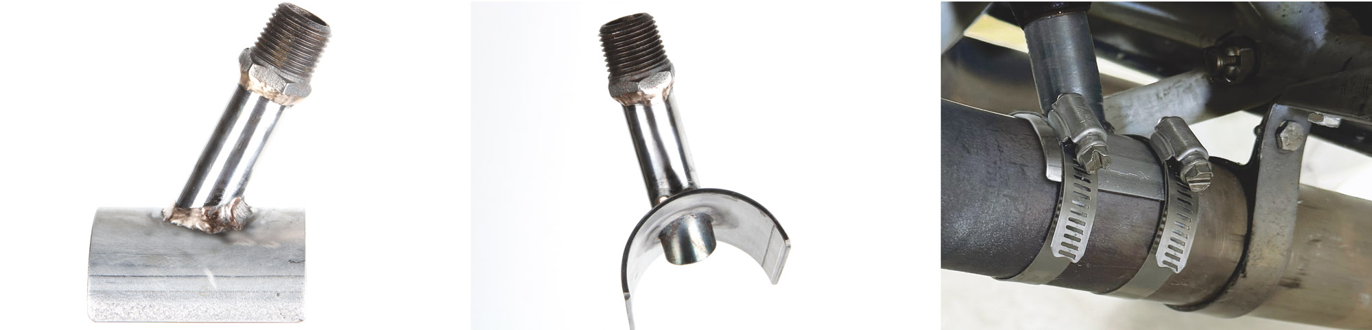

Recently, Ed needed a part to upgrade the installation of his crankcase breather/oil separator kit. Not being an RV guy, I didn’t know anything about the kit, but according to Ed, it is a popular accessory. In any case, the piece Ed needed was a weldment consisting of a tube with an NPT thread at one end and a half-round saddle at the other. The saddle end of the tube is beveled and gets extended into the exhaust stream of the tailpipe. The tube, combined with the rear-facing (to the exhaust stream) opening, create a venturi-effect vacuum source, the purpose of which is to evacuate fumes from the crankcase.

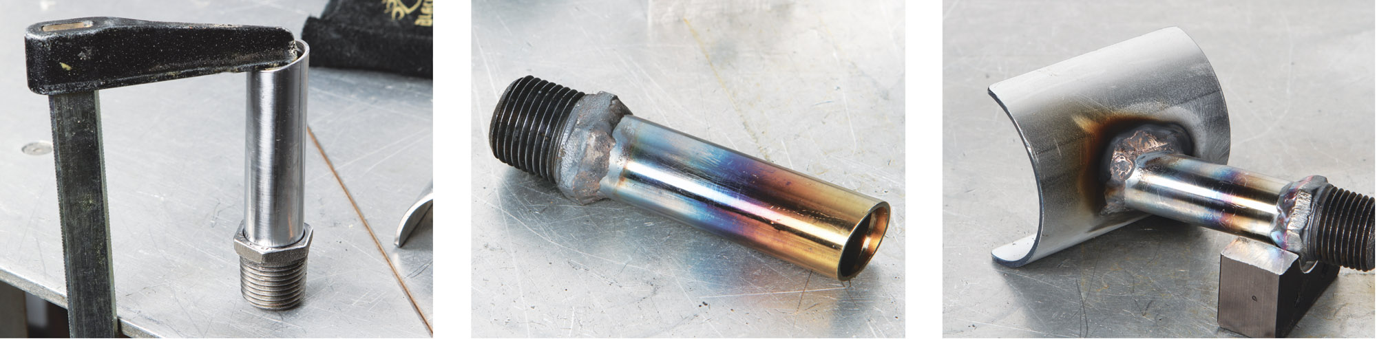

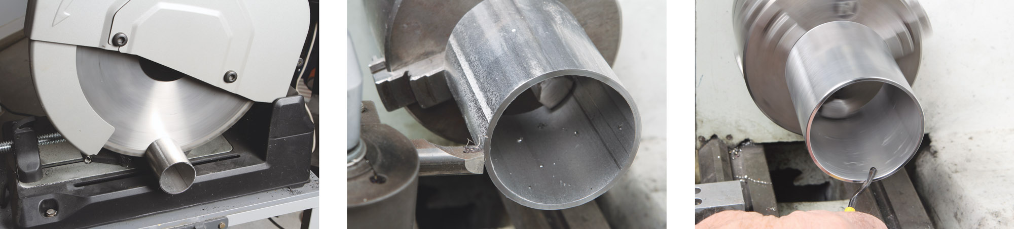

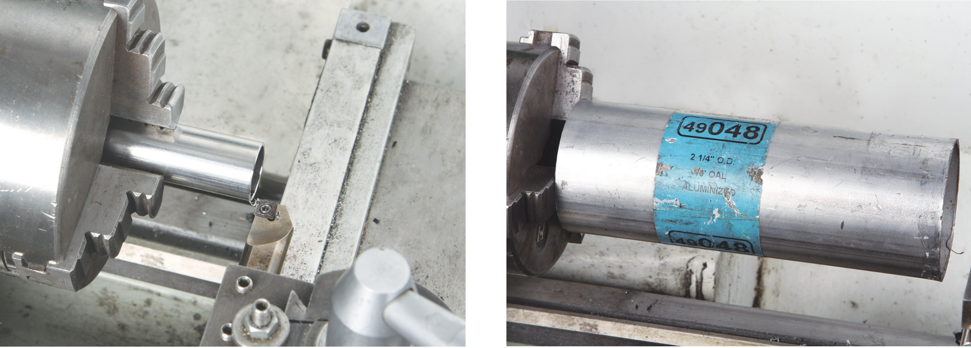

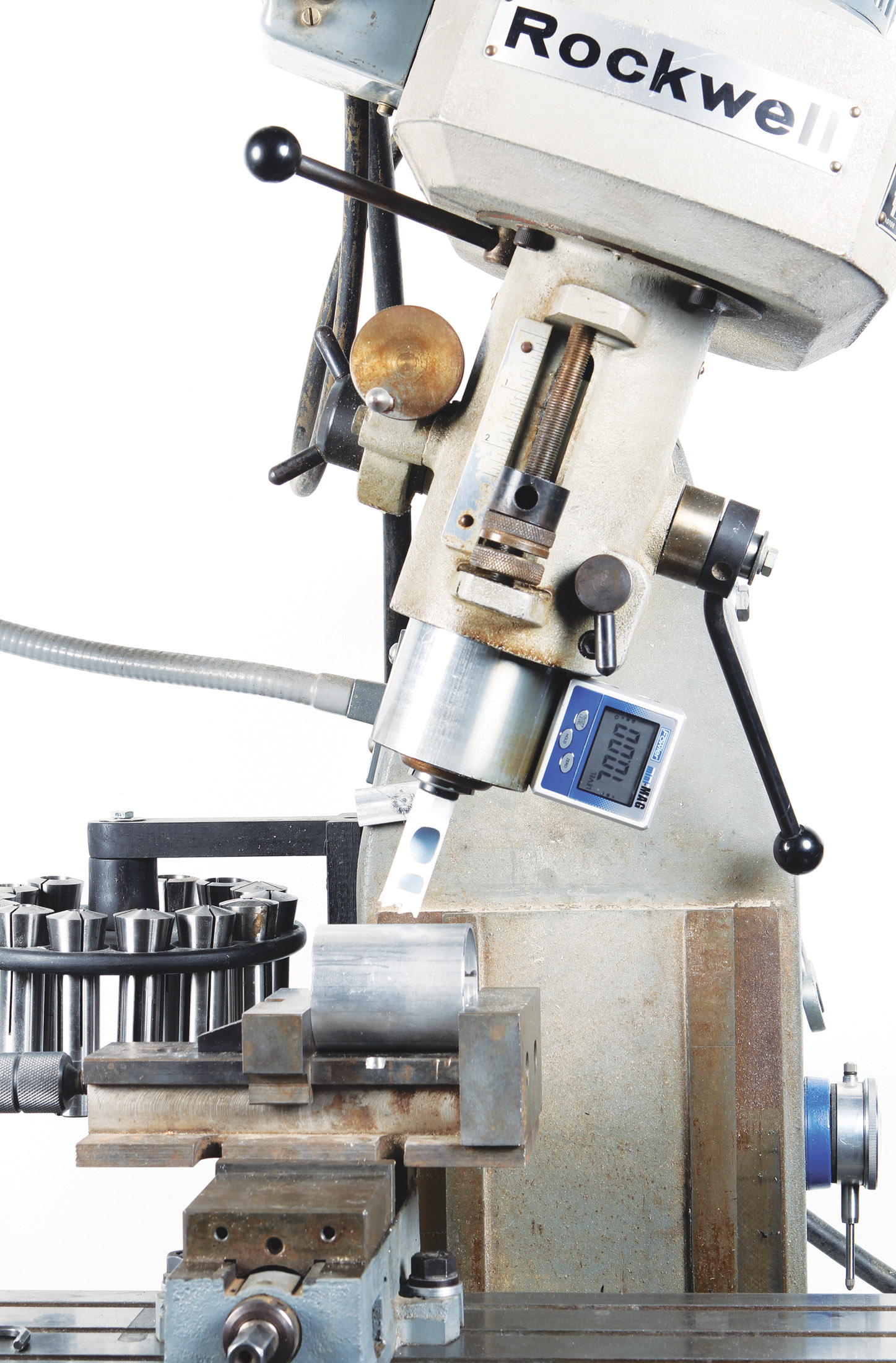

As far as specifications for making the part, the only thing we had to go on was a basic sketch. Ed rounded up a section of 2¼-inch aluminized steel exhaust pipe from a local muffler shop for the saddle—the ID of which perfectly fit the 2-inch OD of his tailpipe. We determined that the vacuum suction tube, the tube that gets inserted into the exhaust stream, was in the neighborhood of ¾-inch diameter. I’m calling this the IV tube because it looks like an oversized IV drip needle!
![](https://www.kitplanes.com/uploads/2025/01/Crankcase-Ventilation_07.jpg)
![](https://www.kitplanes.com/uploads/2025/01/Crankcase-Ventilation_02.jpg)
I happened to have a short length of ¾-inch stainless steel tube, so we were 90% there. One thing we needed was a ½-inch NPT thread to interface with the one-way valve that goes between the IV tube and the oil separator. Ideally, this should be stainless steel, but since our local hardware store only sells black iron and galvanized iron fittings, we settled on a black iron ½-to-⅜-inch NPT hex reducer. It was no big deal to make a second saddle (see the photos) and a spare IV tube just in case the iron fitting has problems. We have ordered a stainless steel reducer and will make another one in case Ed needs to do a swap-out sometime down the road.
