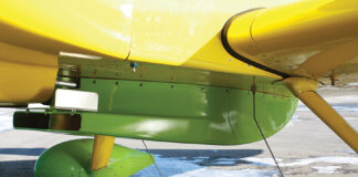

IMG 8746
When Lockwood Aviation replaced the Lycoming O-320 in this RV-9A, it was necessary to move the engine forward to accommodate the lighter weight of the newly installed Rotax 915 iS.
